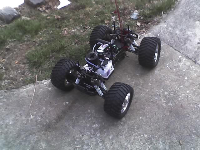

What's the deal with the front shaft on my gst 7.7 , is there a way to alloy shaft or a real shaft not plastic. This is the shaft that goes into the front brake ball with the pin in it and slide out the front shaft

There's a post in here somewere that tell you
I think you need to changed the cups out on the 2 dif's with the Nemesis cups and shaft....I think

Thats exactly right, nemesis "front propeller shaft", nemesis centre tranny output and front diff output is what you will need

Funnily enough I just ordered a Nemesis front prop shaft yesterday after the pin in the plastic shaft broke .
I am going to raid my broken parts bin for the two drive cups from a broken rear diff and a mangled transmission.
So nemesis front drive train,.... $20. Cool.
While I was at it I also ordered a set if heavy duty half shafts as I have killed 3 so far, ripped the pins clean off! [:@]
