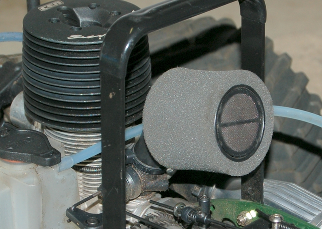

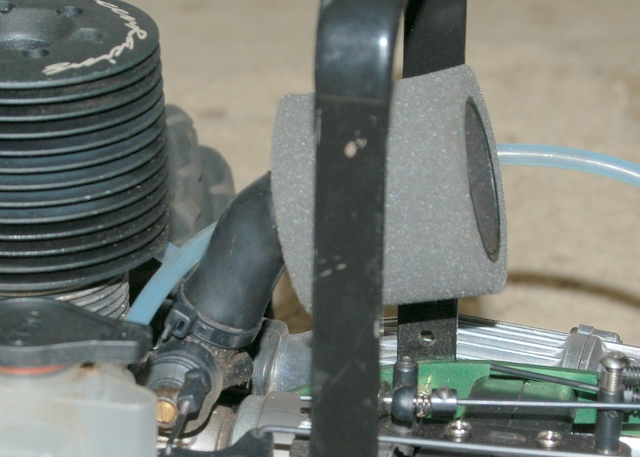

Hi. Motor-saver (part#151660) has a pretty good air filter as an alternative to the original one, replacement foam (inner part#MSTMXFM, outer/inner part#MSB8FFM) is cheaper - at least from where I am.

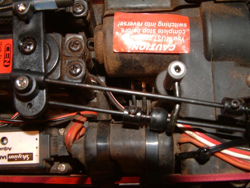

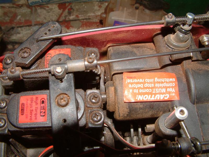

Also a word of caution, I found the Venom Smart temp was causing my servos to twich or act erradically. Most importantly it was effecting my Forward/Reverse servo to the point it would cause it to change state or directions! I stopped this by running the cable from my CEN Fail Safe to the Venom unit through a ferrite core(multiple laps-covered in black heat shrink) - this solved this problem!! You don't want to change direction whilst moving NOT good for anything in the tranny!!!
Hey Chris,
I can't say if running on sand is a good idea or not! But if you intend to do this I suggest doing this mod, that I have done to mine. It will seal you tranny from sand intrusion via you forward/reverse transmission selector. I used a large toggle switch rubber boot (sourced from an electronics or auto store for the job). I cut the top off it & glued the bottom to the tranny casing, using Loctite prisim adhesive.
Hope this answers your questions, .46NitroAddict [>:]
