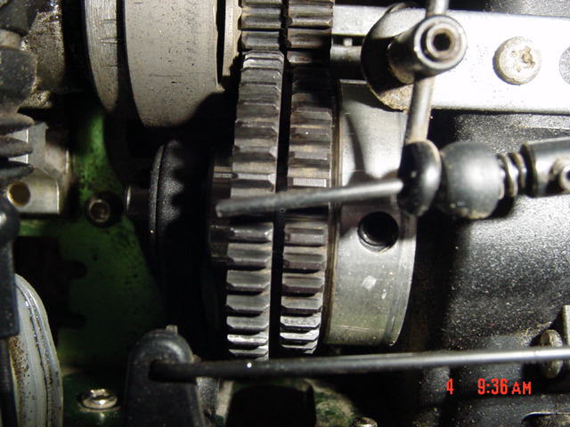

i was running my gst today and i always heard this sound for as long as i had it witch was around 4 months and i hear this winding sound comming from it my question is that sopposed to sound like that? or is it the trasmission? like when i go full throttle then let go thats when i hear it. any one esle have that sound comming from their gst. let me know

That sound is when the pinion to spur gear is tight. Kinda like a supercharger whine... Next time you listen take notice if the pitch increases with acceleration. If it does then it the pinion to spur gear mesh whining at you...

hello the spur gears are the two big gears that are connected to the tranny and the little gears that are comming from the engine right? i had a problem with a loose spur gear that was rattleing and i trighted it but i am still ge3tting the winding sound from it.

Chris you will probably have to reset your gear mesh. And yes the big ones are your spur gears and the small ones are the pinions.

Here are my pics of the spur gears and pinions

Looking at the pics, it looks like your gears are offset meaning they are not set correctly, you might need the shim kit to space out the pinion or spur gears, I have a extra shim kit that came with my Nemesis, so if you need it I will send it out to you. Try setting the gear mesh buy loosening the bolts that hold the engine to the engine mount. put a piece of thin paper between the pinions and sprur gears and then proceed to tighten the engine bolts. This might take a couple of tries to get it right, but the clutch bell and spurgear should spin freely without any binding. If the gear mesh is set correctly, you still might need the shims to center the pinion and spur gear. My nemesis came with instrutions on how to set the mesh, I will see if can find this online and attach the image

I found the info on the CEN website, but I am having a problem downloading it.
Go to www.cenracing.com and click on downloads and then scroll down to addtitional information and click on how to set correct gear mesh.

Yes" try repositioning the engine first. Using the shims reqiures you to remove the engine, clutchbell and the spurgears. Not sure if the shim set comes with the GST, but I dont know why it wouldn't

Put a thin piece of paper in between the pinion gears and spur gears and spin them. When you are done or think you have it, post some pics. I really do think you need the shims for the pinion gears. TRD will be able to help you with that, he has a lot more experience pulling the truck apart and putting it back together I think he can do it blindfolded. See if he has any clutchbell tools left, he had a coulple made and was selling them, not sure if he sold them all but this is a nice little tool that will help you hold the clutchbell while you take the pinions off. HE has some pics in his gallery. PM me your shipping info and I will send out the shims.
