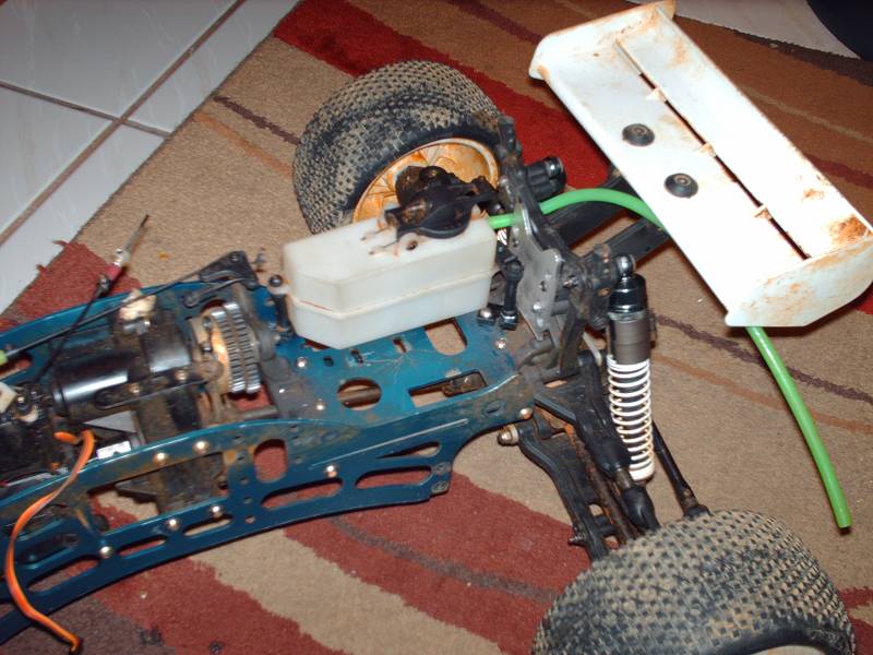

put a mugen tank and wing on the nemesis

Lookin good, should keep anything from banging it around too. Did you custom fab that wing mount to mount to the shock towers or are you able to purchase it?

custom made

i made the wing mount im going to clean her up and pick up a new body i love the tank sitting inside the frame. i might do some carbon side plates its a mugen tank of of my mbx5t truggy

Looking good blackrain!! Think this wing will hold up better?? and what is that red stuff all over the truck???

the red stuff is red clay from the rc tracks down here in florida, this wing is solid built to last

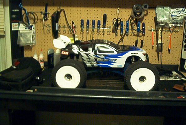

ID:	781182   Click image for larger version
Old 10-11-2007 | 07:53 PM
blackrain's Avatar
Joined: Jan 2004
Posts: 1,556
From: , FL
Default RE: Nemesis wing and tank mod
are you just using 2 screws threw the 2 holes in the middle of the shock tower. if so thats what i did for my first wing mod didnt hold up for long due to the weight of the truck doring roll overs.
Old 10-11-2007 | 08:17 PM
blackrain's Avatar
Joined: Jan 2004
Posts: 1,556
From: , FL
if you can try and make some kind of bracket to support the other 2 holes of the wing mount. shore looks sweet
Old 10-11-2007 | 10:15 PM
Joined: Feb 2006
Posts: 844
From: WARWICK, RI
That's exactly how I have it mounted...I was thinking of making a bracket to support the other two holes..the way it is now, it won't surrive a roll over
Old 10-11-2007 | 10:31 PM
blackrain's Avatar
Joined: Jan 2004
Posts: 1,556
From: , FL
ya when i did it that way i had a hard time figuring out how i could build a bracket that would work, plus didnt have the proper tools at the time. maybe some kind of bar across the top of the tower that the wing can bolt the 2 top holes against
Old 10-11-2007 | 10:57 PM
blackrain's Avatar
Joined: Jan 2004
Posts: 1,556
From: , FL
if you cant get it to work all i used is the mugen mbx5t wing mount and a metal plate drilled 4 holes and ran it threw the shock tower. the mugen mount is tough doesnt have all the cut out spaces like the matrix mount
