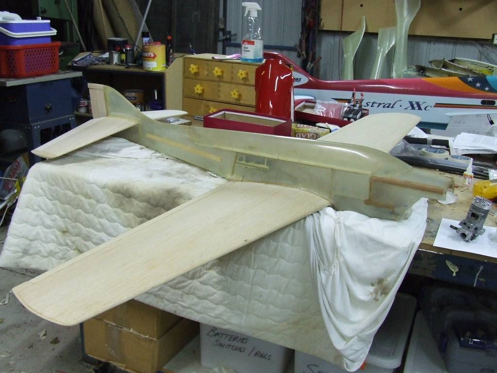

Hi there
Building a Prettner Magic from a funkey glass and foam kit.
MVVS 91 rear exhaust inverted, s-bend header with MVVS pipe on top.
Robart mechanical tri retracts.
will post pics soon.

Progress so far.

Having built and flown that exact plane I would second think the .91. I had a ST x61 in mine and it was as we like to say ballistic. I think your going to have a ground clearance issue with the prop on that 91.
Old 09-30-2010 | 07:17 AM
Joined: Sep 2006
Posts: 88
From: Melbourne, AUSTRALIA
Default RE: Prettner MAGIC build
I have checked it all out, I'll be using a 12x10 or 12x9 apc and clearance is fine.
Did you have a Magic or Curare, the Magic has a higher thrustline which is easier on prop clearance.
The MVVS 91 is also very light (about 530 grams bare) and genuinely 60 sized, just waiting on the custom header to be made so I can press on with the fuselage.
Thanks for your interest.

Finished up the main retract linkages this morning.
Cheers
Greg

I dunno about those bends in the pushrods for the retracts. They caused nothing but problems in my last plane, basically it acts like a spring under load, and will cause the prushrod to bow out of place instead of lock the gear in.
Just keep an eye on em!

There pretty rigid, I think you have problems if you try to do the whole pushrod in wire but with carbon tube in the middle you can stall the servo by holding the gear leg and the pushrod hardly moves.

Its been a while since I touched this thing but done a little bit in the last couple of weeks.
After a lot of bench testing I've decided to give the OS91 ducted fan motor a try, it turns an APC 11x7 at 17,000 with a MVVS muffled pipe (same rpm as a Macs but much quieter).
Made the rudder and elevators which were missing from the kit and hinged them, faired in the bottom the wing and made and fitted the servo tray.
