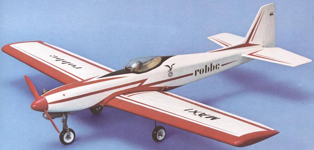

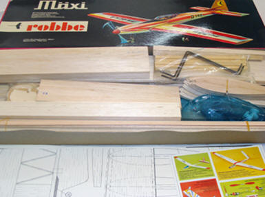

Hi,
Yes, it sure looks like a Robbe Mäxi (Maexi).
It was a rather popular model in the first half of 1970th. Was avaliable as an all balsa kit, glass fuselage+built up wing+stab and glass fuselage+foam wing+stab. Is available as ARF today (glow or electric). I like Robbe Mäxi outline and it flies rather good as far as I know.
Images below from Robbe catalog (in German but pictures will show orginal model rather fine I think).
I have been looking rather long time for an unbuilt Robbe Mäxi with glass fuselage+foam wing+stab and actually had one in reach on ebay once but the seller withdraw the kit for some reason from the auction (I did bid on it). They are rather rare but can be built from plans of course (I have Robbe Mäxi all wood balsa kit plans so it would be possible to build one that way). Nice plane You have by the way. It seems You have the Mäxi FH version (glass fuselage with conventional built up wing+stab). Mäxi has a wingspan of 57.5 inch (1460 millimeter). Images below is from Robbe catalog 1970 (the first image to the left) and 1977 (rest, except Mäxi ARFpictures and kit box pictures).
/Bo

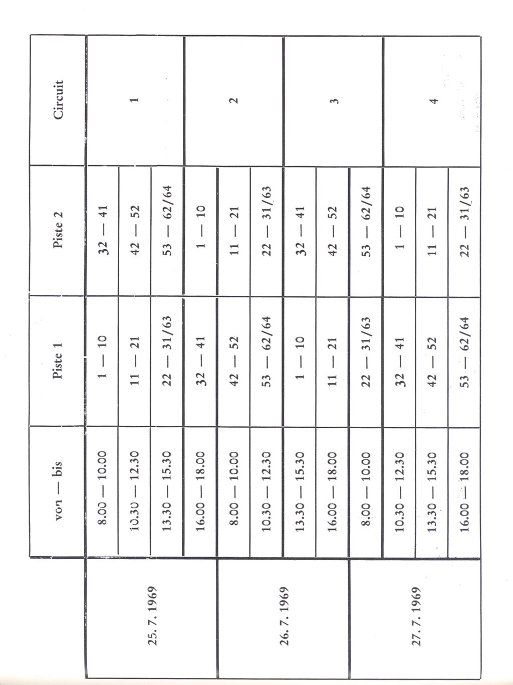

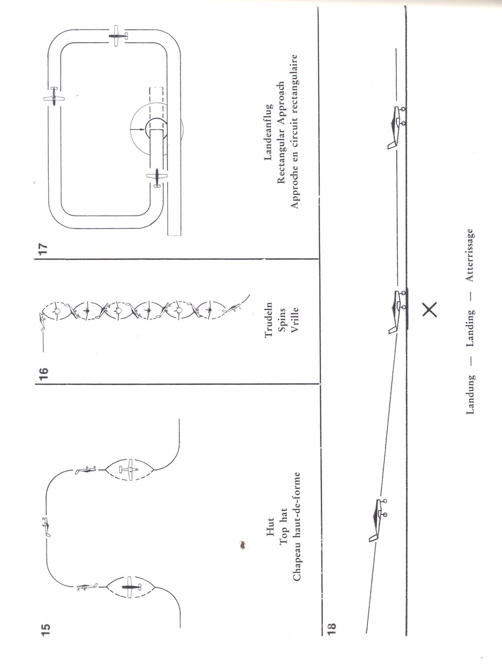

Carl,
I have some interesting historical facts about the Mäxi and 1969 World F3A Championship. I have the orginal official program brochure from that event.
For example:
- Front cover of the program below.
- On one of the pages Robbe had an ad and guess what plane they had choosen to show - yes a Mäxi.
- The event was held in Germany, Lemwerder Bremen, July 23-27 1969 with competition days July 25-27. See the schedule below from the brochure.
- Start order was as below (yellow pictures), Elsässer had start nr 14 (the poor guy from Sweden, Jesper von Segebaden had the not so nice start nr 1, must be the worst start number to have in a WC).

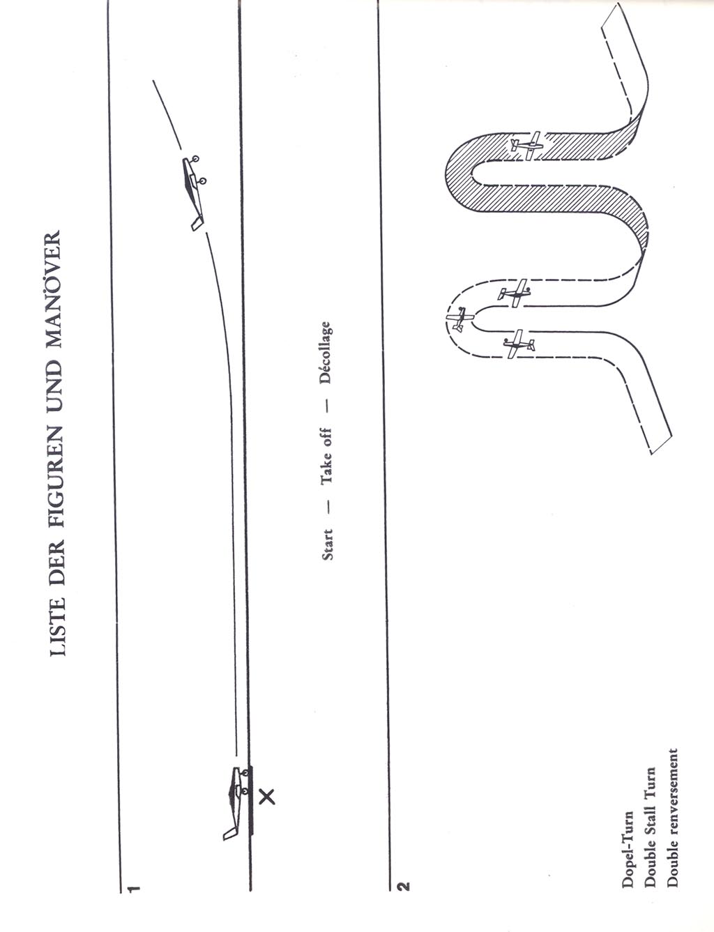

- The manuvers they flew was as pictures below. When you can fly those manuvers with your Mäxi then you should be happy and remember that exactly this flying schedule was Mäxi designed for.
/Bo

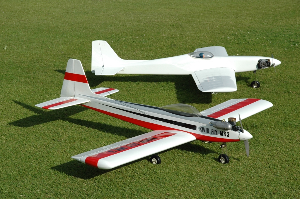

I did remember this picture to compare and I show you.
The Mäxi is of the period of the Kwik Fli MKIII of Phil Kraft.
Latest world champs victory plane of the USA (1967) for more than 20 years after that.
Phi Kraft was second place on the list of world champioships in 1969.
(Look for the MAN magazine Februari 1968)
The span of the Kwik Fli was 60”and that were the dimensions in that period.
The Taurus was 70” with 0.45 Cubic Inch.
About a four stroke? I do not think so, it did have a front mounted carburetor when I look at your picture.
Maybe it was a Schnuerle ported engine.
Cees
