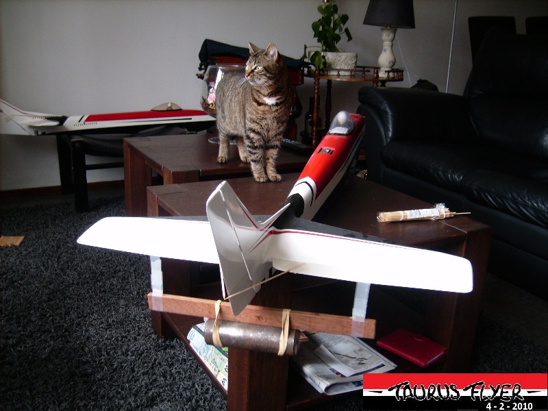

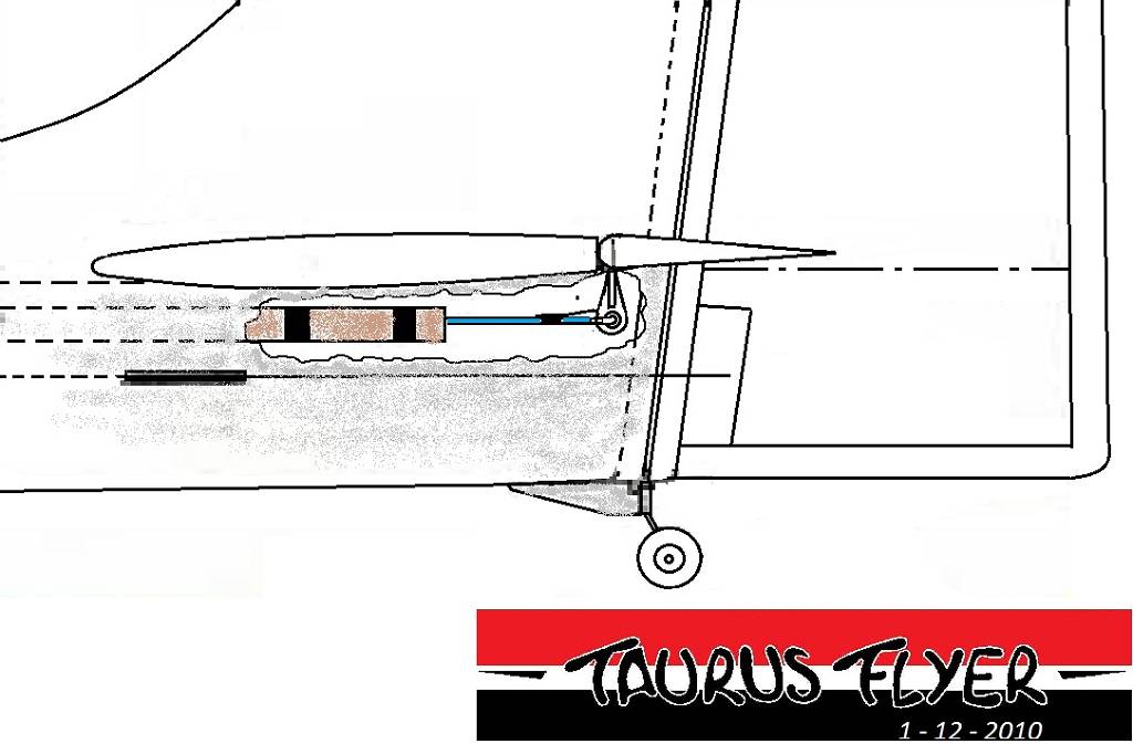

My best overall system IMO is the single pushrod and single lever.
Servo’s can experience a lot of vibration in the tail. I never did have a servo of the elevator failed as far as I remember. (Old School!)
Second point is, drag of all the levers, links and iron works visible on the tail, impressive but a source of drag and only commercial interesting.
Last profit, both elevator halves are always exactly synchronized and that’s important for me.
I did show a picture with 2,2 kg (cilindrical piece of steel) hanged on the TE of the elevators of my plane and the position left and right is still symmetrical.
The plane you are talking about is an ideal example to use a single lever system, see my drawing.
Cees

I do show a single lever single pushrod system, the system has nothing to do with any Y with bearings. People often do have a surge to make things impressive and needless complicated. We are not making a steam engines.
Because you did make a summery I did show the system because it is forgotten. The principle of this system is more than 50 years old and used by pilots in the period they also were engineer, applied in the most famous classic pattern planes of the USA. Astro Hog, Smog Hog, Orion , Taurus etc.
Only challenge is, you have to make the system yourself, but when made it is the best system you can have. Stiffness of the (wood of the) elevator halves is a problem and not this system. Do a test with your own plane and add a weight with the use of strong tape on the TE of the elevator halves generating a total torque of 8,8 kgf cm = 7,6 pound force inch total and check deformation left and right. When you see a difference the plane fails in contruction and during flight IMO.
I did not tell another pro of this system.
The single main pivot bearing of the pushrod is encapsulated in the fuselage, protected against rainwater and dust just as the crankpin bearing is protected in the crankcase of the glow engine. When made with the right plain bearing material and dimensions this system holds its accuracy for many many hundreds of flights.
Cees

Cees,
the single center actuated system where the elevator halves are joined (CL flap style) is an elegant solution in some cases. This of course, is for those who desire no independent trim adjustment.
The main problem I see with this system though is that with glass fuses, maintenance is basically non-existent. Because the installation of this system requires you to first pass the joined elevators through the stab opening, then link up and finally followed by the stab itself, once you lock the stab in position there is no access to the linkage. I suppose one can argue that if done properly one needs no access to the linkage but if for whatever reason you did - you would find yourself in one of those [:-] situations - if you know what I mean.
For wood fuses, it would be simple enough to build in a maintenance hatch as is done on several scale models using this system.
David.
David.
