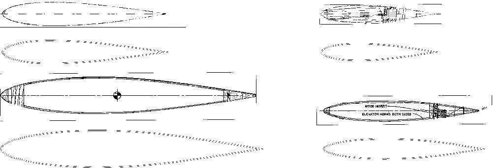

anyone have a set of plans for the Bridi XLT ? need the root and tip airfoil for wing and stab.. plus the layout of the wing and stab...

The tip airfoil is not on the plans; Root airfoil would also be in question if taken from plans since they were not drawn for cutting.

Maybe if someone could identify what the airfoil was, that might make it easier. I am sure it was probably just an NACA 0015. This info would be better anyway, so when you make your templates or get your foam cut, the airfoil will be accurate and not a trace job. Many of the foam cutters offer the NACA series as standard.

Here you go. I made these templates right off the XLT plans as mine show the dihedral locations on the side view. I am speculating that the oulline for the wing tip and stab tip ribs represent the actual size.
The plans call for 1/16" sheeting which is represented on the attached templates.
Bryan

Airfoil of the root looks like n64015a (more exact n64014.5a).
The airfoil of the stab also looks like n640xxa but not so exactly as the wing.
Tip airfoils? Not yet verified. Who knows?
Cees

Redesign and reconstructing a model is as important as designing a new one IMO and there are more important reasons to find out the original airfoils.
First the right dimensions of airfoils can be very important, especially these of this model and with fully sheeted wings. When using a NACA 24xx we have a much easier job to do, not so critical.
Knowing the basic airfoils we also can print all individual ribs with an Excell program and when some parts are lost, reconstructing them is easy.
Old plans are often copies of copies or we see not accurate airfoils examples of a kit.
There can be a difference between root and tip airfoil, part of design consideration of the designer.
To show the difference between two of them, NASA Langley 64 012 and 64 012A: Cutting with a too hot wire and you make the 64-012 instead of the 64-012A LOL
After some time you can read an airfoil like a character.
Cees
