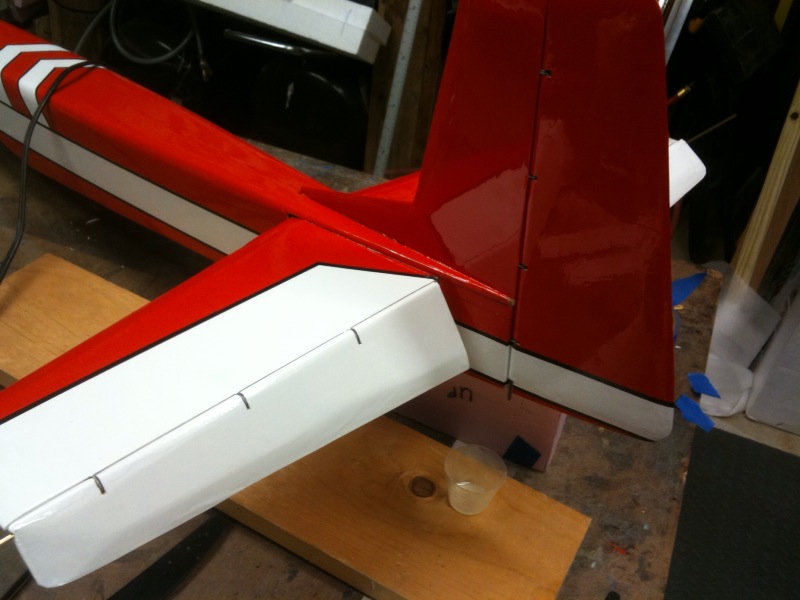

I used a pin hinge method with the hinges made of G10 and a 2-56 control rod for the pin.

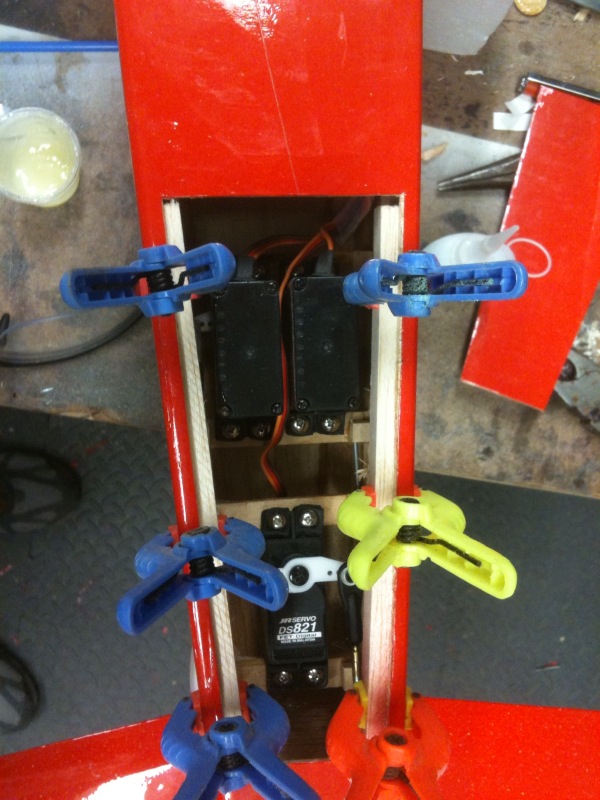

I installed a Thunder Tiger 60 Pro with a gallon of fuel ran through it for $65. Unfortunately the mount was drilled for a TT 60 GP which has a shorter shaft and I have a 3/8" or less gap behind the spinner but SPA is in a couple weeks so I need to wait to make any changes.
The engine, fuel tank, and landing gear were installed then a preliminary weight and balance was done and it was way nose heavy so I installed the servos in the rear. I used two elevator servos for the extra weight.

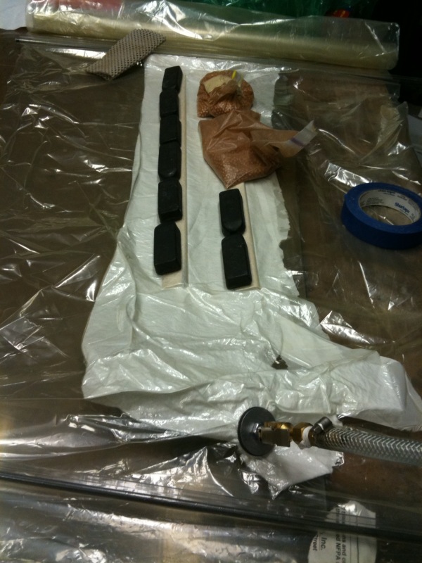

When I got the Kaos it didn't have ailerons so I made my own out of soft balsa and then I glassed them with 2 oz glass and vacuum bagged them to make them stiffer. My wife found out how well iron on covering sticks to glass that was applied with peel ply...much better than to balsa.
Here's a picture of them in the bags on a 3/8" glass sheet with weights to make sure they're straight.
Your G-10 hinges are intriguing. Do you have any up close photos?

Sure I can but I don't have any in the assembly stage except the Macchi but it's not my design.
Here's the hinge I cut for the Kaos
Here's another shot with some still on the stick before they have been cut out and trimmed. Use an old blade (because when you're done the blade will be trashed anyway) on a band saw works the best. I keep one old blade around just for cutting G-10.
Here's the one Ed Newman designed for the Macchi 200 (which seems to be parked while I get my pattern fix). In his design he uses a much smaller wire through the yellow plastic inner rod from a Golden Rod. Then it is glued into the wood hing. The thin opaque sheeting above and bellow the wood hinge is .012" G-10 I used to create a cove.
On a wing or stab I design I leave enough material to cut a cove in the trailing edge with a sharpened brass tube the size of the leading edge of the control surface. I then gouge the wood out then wrap sand paper around the brass tube or the LE of the control surface and sand it to the right fit.
For the control surface (let's say an elevator) I leave the front flat and then add a cap strip which I sand round for the LE of the elevator. You will need to cut a trough in the elevator and the cap strip half the height of the carbon fiber tube you will use to run the wire in (the wire runs through the control surface then through the hinge which is attached to the stab). To do this you have to use a router to cut a groove half way into the elevator and half way into the cap strip. The picture shows the 1/8" router bit with a piece of balsa that would be a cap on the front of the elvator.
Once the trough is made you epoxy in a piece of carbon fiber rod (see photo and pretend there is a trough)
Then put some epoxy on the cap strip and glue it all together. Now round off the leading edge.
