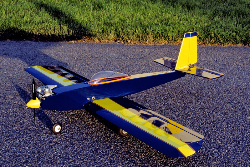

Default RE: .20 size taurus
Hey guys,maybe my math is wrong.Not including the ailerons my root is 9.75" tip is 7.75" and the span is 52" please check my math.Rob
ORIGINAL: HVACMAN
Hey guys,maybe my math is wrong.Not including the ailerons my root is 9.75'' tip is 7.75'' and the span is 52'' please check my math.Rob
As I mentioned, spreadsheets are cool but back of the envelope pretty much gets you within 3%:
~MAC = 0.5*(9.75+7.75) = 8.75" (it's not exactly a MAC but it will do)
Area = MAC*Span = 8.75" * 52" = 455 sq in
If one includes the ailerons at 3/4" width:
Area = (10.5+8.5)*26 = 494 sq in
the same as calculated by thailazer and the spread sheet.
A more accurate effective wing area is likely closer to 19*25 = 475 sq in if one removes two inches of wing span to account for the wing tips. They may even be wider than that so being conservative and assuming an effective wing area of 465 sq in (the mean of the area without ailerons and that without tips but with ailerons), the wing loading at 60 oz (3.75 lbs) would be:
wing loading = 60/3.23 = 18.6 oz/sq ft
That sounds just perfect for a model this size.
I'm actually building a model with a 51-1/4" span and the exact same 465 squares so the magic number of 60 oz was already close to me... [8D]
Looking forward to hearing how she flies!

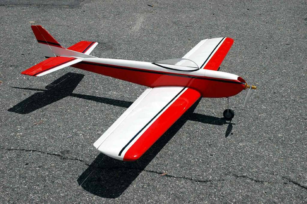

USTIK, my scale for the Mini Taurus was I simply picked a wing size that would allow me to carry the plane assembled in my car. Staples shrunk the plans, so I might be off on the exact scaling.
I used the same construction as the original but reduced wood sizes wherever I could.
3/32 fuse sides, 1/16 ribs and 1/32 leading edge sheet for example.
I did a build thread here: http://www.wattflyer.com/forums/showthread.php?t=19864
At the end of my build thread another person built one out of foam and it is less weight than mine.
My Taurus snap rolls and spins fine, I did eliminate the angled control horn so I have a bit more up elevator throw than the original.
I did like the way it flew, I should fly it more often.
After seeing this one and a few others I just wish I did the standard Taurus paint scheme now.

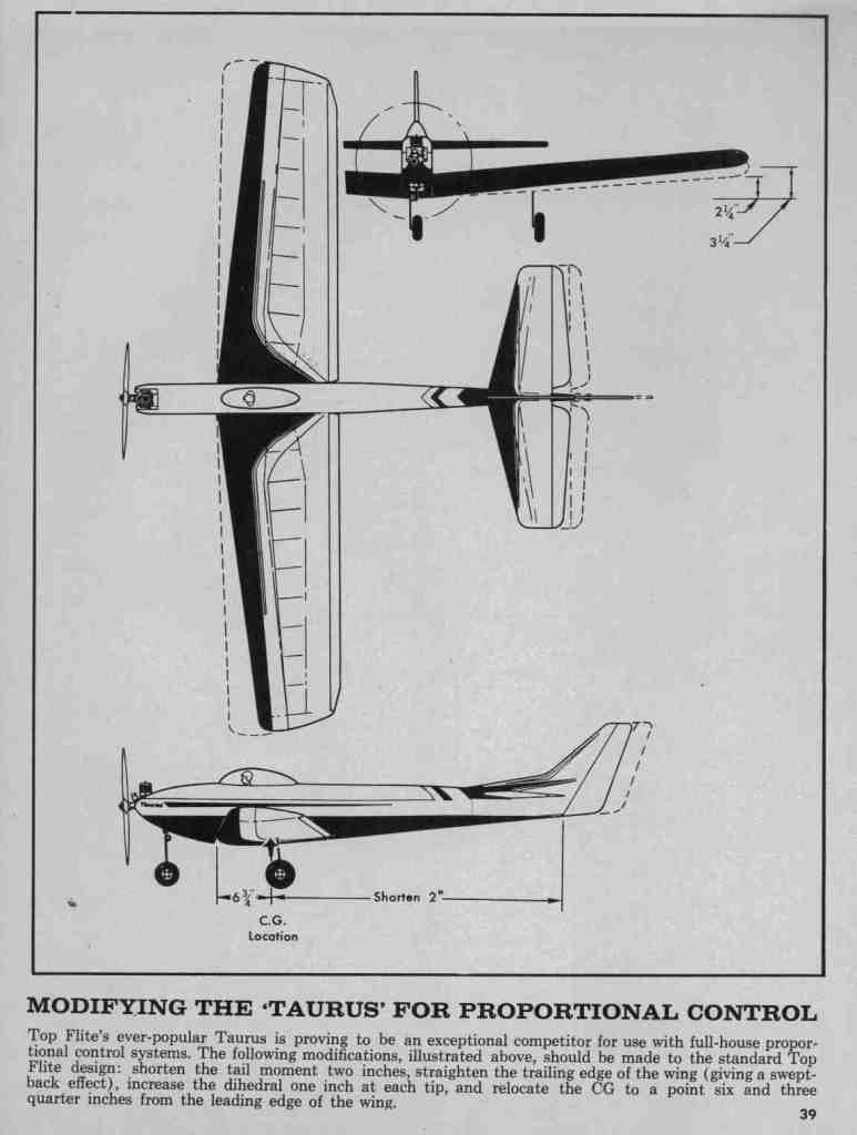

I found this pic on Rcu and liked the swept wing ,so I put the copy on my over head projector and enlarged it until it looked right.Then I sketched the outline one the back of an old set of plans.IF I had known there were a set of drawing that were even close,Would have saved me hours.I should have spent more time running the numbers wing area ,loading ect.My next project will have the math right first. Thanks everyone for your help.Rob

Interesting variation Rob. What's with the increased dihedral? I would have taken some out.
David.
Old 05-30-2011 | 07:58 AM
  #45
HVACMAN's Avatar
My Feedback: (127)
Posts: 90
From: COVINA, CA
I did not increase the dihedral, it just didn't look right. The wing has aprox .75" other than that I followed the drawing.I am off to the field, so I will give an update in a few hours. Rob
