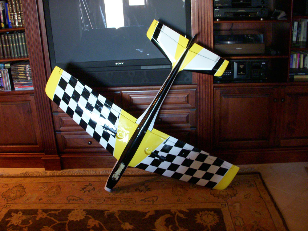

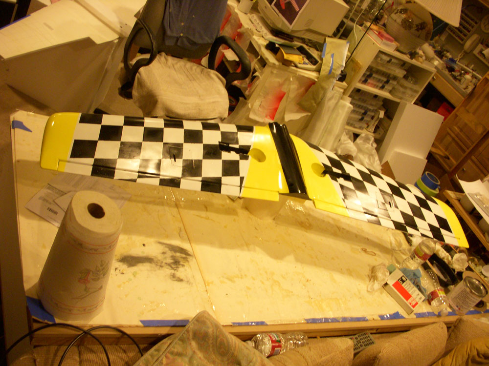

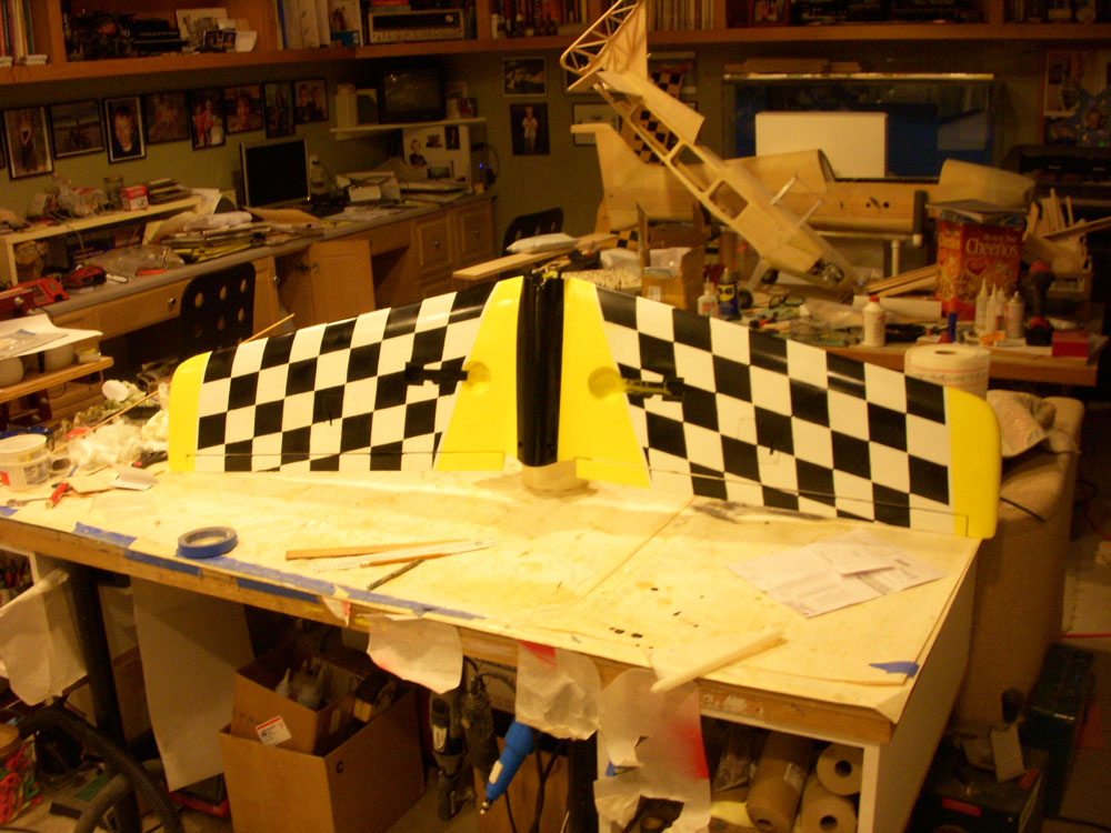

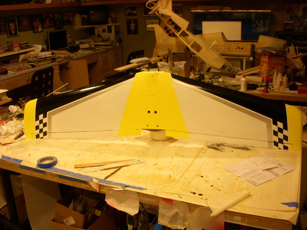

I did the bottom of the wing with big checkers so I can see it well. Just need to do the lettering and shoot the clear coat.

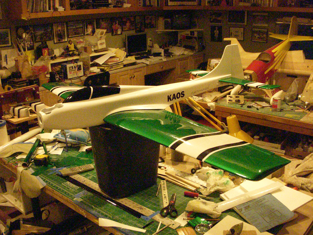

From: Grand Junction, Colorado
Default RE: BUILDING A PHOENIX 8

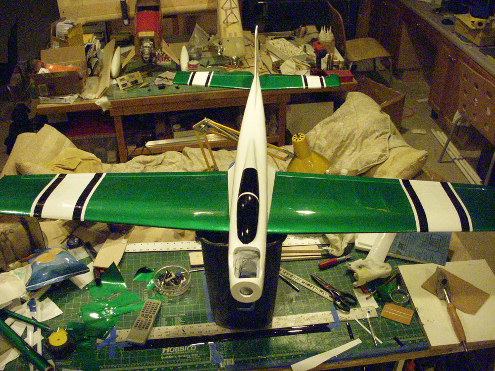

ORIGINAL: doxilia
Sweet Don!
Is that the DB in green in the background? Do show as well!
David.

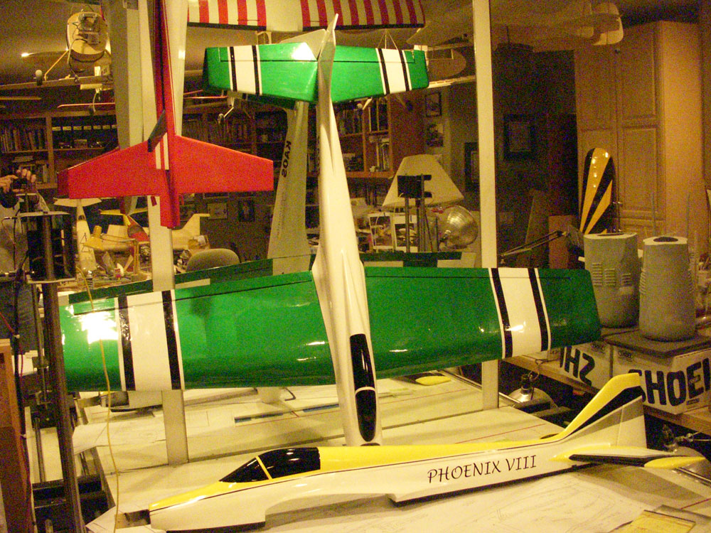

Actually it is a Kaos, modified a little bit, Rounded the fuse a little extra, larger triangle stock used inside fuse when I built it. Rounded the nose, rounded the tail fin and added a skid under the fuse to complete the look. I also added about 5" to the wing span and extended the wing tips to cover the edge of the ailerons. I added extended tips on the stab as well. No retracts just the fixed gear for now to keep the cost down. I made a glass canopy from my UFO mold and added it on the wood fuse. I didn't have a KAOS canopy. Lets see what else...Oh I put in two separate servos for ailerons, pull pull for the rudder and a split push rod for the elevators. Uhm....I think that's it.. It does look like a Dirty Bridi doesn't it? Well I didn't realize it until I was done building it. I should have just made one of my glass DB.

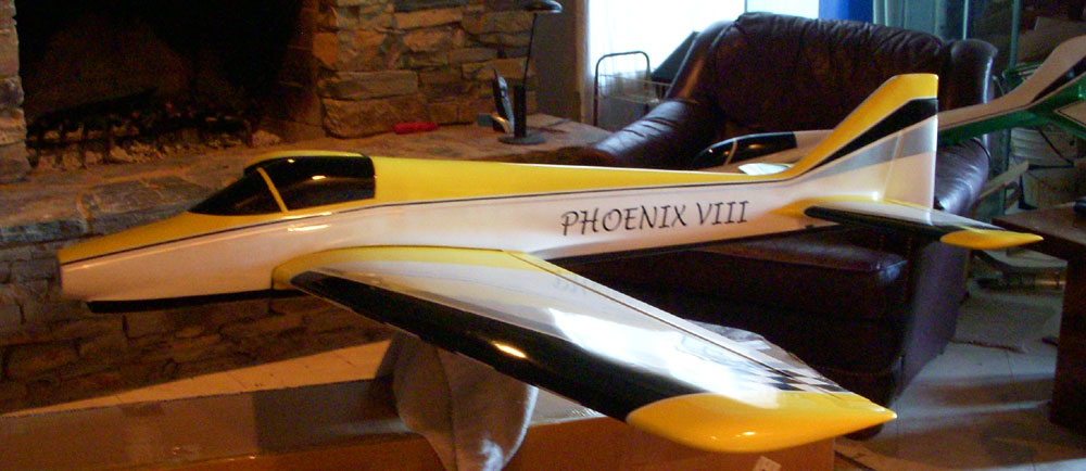

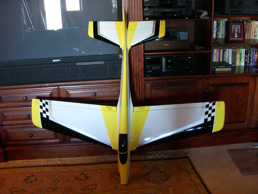

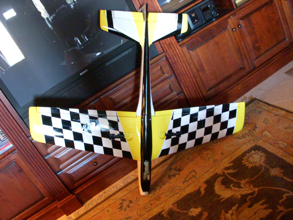

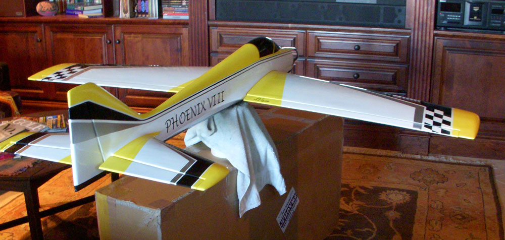

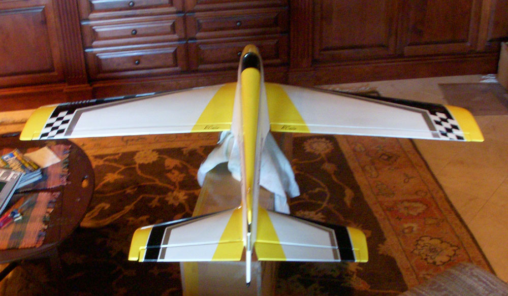

Some P-8 pictures put together ........ So you can get a better view of the paint scheme.
