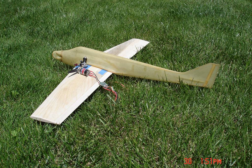

Ok here are some pics. Got the wing bagged. I used 1mm poplar. That stuff is great for this. Also a TD .049 and a Mega motor power system can be seen for size comparison. Otherwise it would look like a big pattern plane! I know this is going to fly well. It will be nice not having to worry about fuel proofing as I will be using the Mega motor. Runs great on a 6" prop. Perfect for this sized plane.

Well here it is almost ready to fly. Just have to finish the radio install. I have a CC 45 ESC and a Mega 16-15-5. 4 chanels with landing gear. This setup turns a 6.5" prop very well on 3s lipo. Looks like it should fly great.

Thanks. The dent was formed in the glass lay up. It is where the engine should be. I guess I could have filled it, but not really worth it. The spinner I got from hobby lobby, I believe. It is several years old.

Ok, got 2 flights in yesterday and all I can say is that I am very happy. It flies like a big plane but just smaller. Very clean and smooth. Quite fast, even at mid power settings. Very quiet which I like. This means it is efficient. It also lands very nicely. It just becomes the ground. The electric conversion for this design I believe really makes it come to life. Having a ton of experience with TD .049 engines, I prefer this set up.
