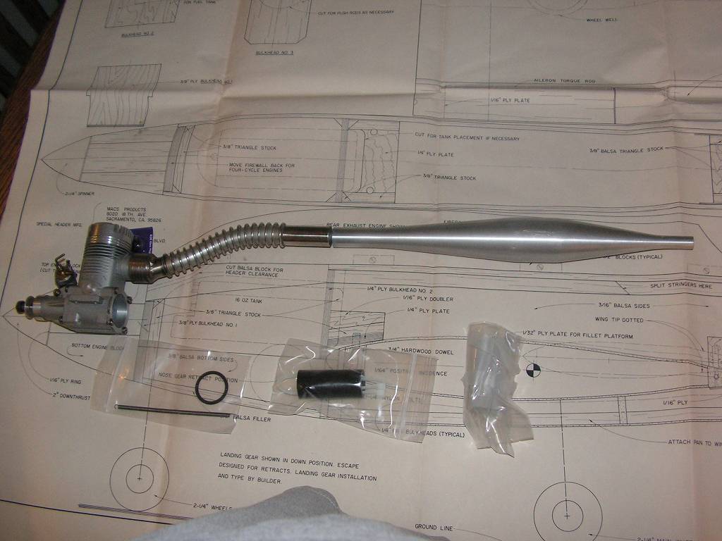

It is interesting...
When I said butcher up the canopy, I actually meant cut around the set-up I have. This looks to be exactly the same thing Joe did on his XLT in the pic below. But... I am glad to get the comments I have. To raise the front of the canopy to clear the header seams to actually add character.
Happy to see these pics.
Brian

Brian,
don't forget - you need to make a hole! Two reasons 1) you don't want to pass the header at the exhaust level into the fuse. Why? Because the tank is there (at least with an un-pumped engine), and 2) because you need to cool the exhaust system. And even if you are going to redirect the exhaust back into the fuse to have it exit the bottom, keep in mind that the exit of the pipe must be ~3 times larger than the inlet for proper airflow. For all intensive purposes, the rear of the canopy is an open end. If you somehow rig things to use a small prop and short exhaust length in order to leave the canopy closed in the rear, you will have heat problems. Think of it as a pipe melting right through your paint work in a matter of a flight or two... On that note, you may want to consider using high temperature paint in the area under the canopy. The kind of stuff that's used for brake calipers and such.
There's nothing I'd consider "butchering" in making a U-shaped hole in the canopy to pass the header - that's how many have done it in the past. Provided your header doesn't enter the canopy from the top, I don't see anything ungraceful in this approach.
I think you'll be fine with the Rossi header - it will minimize the complexity of the FW and fuse top work since it has a more pronounced "Z" and will put the entry to the pipe at the proper height above the fuse top.
My single penny... So when does the build begin?
David.

doxilia-
This is the reassurance I was hoping for...
The butchering was the height the pipe would enter the canopy.... "Butchering" was a bad choice in words now that all has been said. But after seeing the XLT photo above, I don't think Joe Bridi would disapprove of this header choice either.
Honestly, I know that I need to open the rear of the canopy. I was going to approach it as I would a cowl. Even though I am going to direct the exhaust out the bottom, I still need to keep it cool in the canopy. The heat off the header could cause real issues if not cooled. Because I have never run a tuned pipe, I do not know how warm this gets, but I get the impression the pipe won't heat up like the header...
David-
Not sure that I understand the concern about the header entering the tank area. As I see it, the firewall stops below the header. There is a large balsa block glued on top of it. You simply carve and sand the space needed for the header You won't actually carve into the tank area. Am I missing something?
I think I hit on a winner with this header. I would like to fire the system up on a stand and hear it run and break it in a little before the end of the fly season. I am nervous about this process. The system won't be tuned at first, Hopefully it will be adjusted closely before I ever add fuel based on Mr. Dean Pappas's math. I want to use the right fuel and blend, prop, plug, etc... I'm half tempted to send it out to someone to break it in for me the right way with Dean Pappas's understanding.

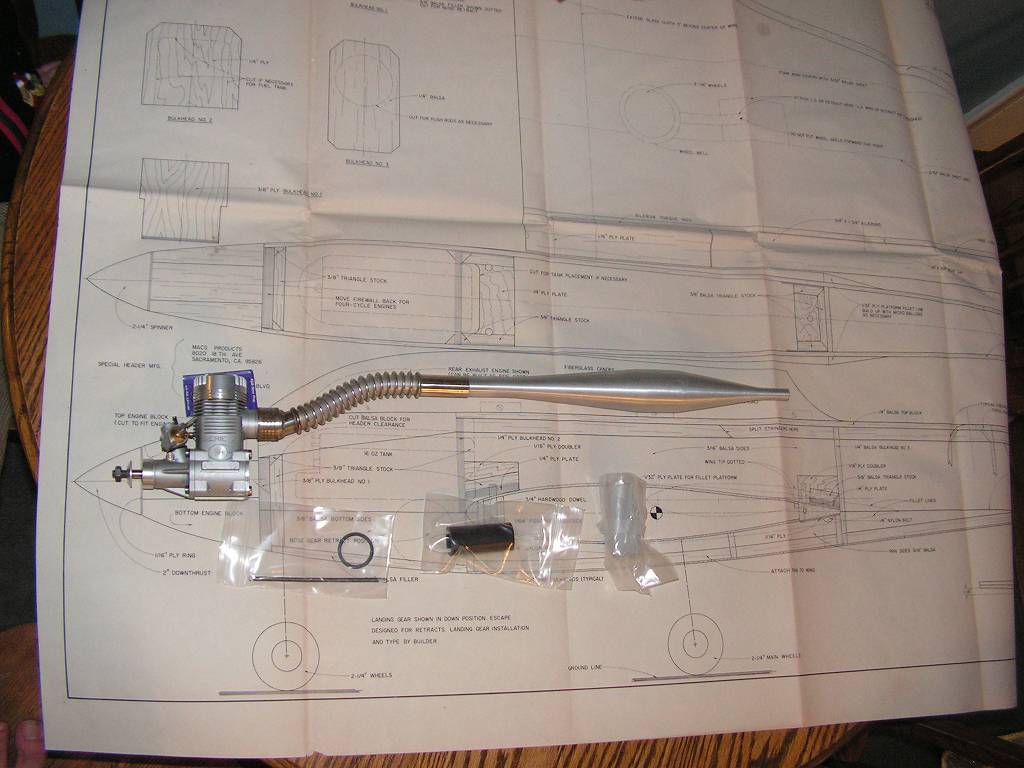

Well I was thinking about how the canopy would be cut. I pm'd doxilia about this to begin, but think it would actually be nice to get general input too.
I posted a few pics below to work on my header and canopy issue.
1. I would raise the canopy as already shown. This is a great idea.
2. I could cut down the front of the canopy to clear the entire header (for cooling) as shown in this great example of a XLT...
3. I could actually move the canopy forward some. I am thinking this is what was done in the last pic. Cooling may be an issue... I do not know.
Visuals can sometimes help. I am leaning towards option #2, actually preferring the 3rd option. Keep in mind, I have a LONG time before I have to decide on this. I had a lot of time to think about it today though...
Brian

Brian,
The canopy for my Escape needed to be set very far forward to clear the header curve, I also enlarged the front opening slightly for additional air entry and clearance; all in addition to raising the front half of the canopy as mentioned earlier. All un-noticable unless pointed out.
Go for it!
Jim

I am pondering the idea of locating some proper aluminum tubing. If a person could locate the proper bending tools, they could purchase a couple Rossi headers to cut off the head mount and have a header, custom bent to fit your engine and the plans, tig welded at a radiator shop...
Where can one either find these tools, or what type of business to call to have the work done?
Macs will not cooperate in this. I already spoke to them earlier.
There is nothing wrong with the header I have, other than having to make special concessions for it with the canopy. I would like to get the right bend in the header. I have a lot of time to do this... Not in a big rush.
Brian

Brian,
The header shown on Sahak's site won't work?
http://shop.vendio.com/RossiEnginesU...826/index.html
Jim

It will work. I plan on using it if I don't find a way to get the header closer to the plans. I have some time to look and try a few things before I need it... so hoping against hope, I'd like to make something closer to the plans- if I can. (I obsess! Hate me or love me!!!)
If I can't.. no biggie. The Rossi header will be just fine.
It would be cool to find a way to get the intended header on it though... Ingenuity...
