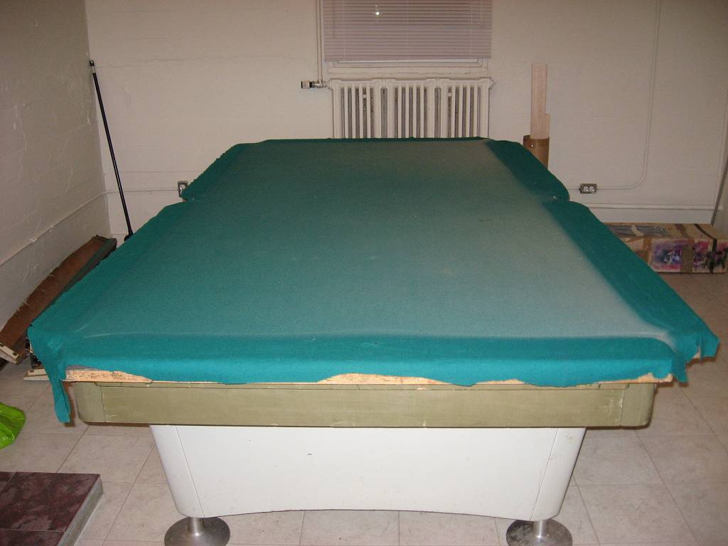

Just thought I'd share photos of my newly acquired workbench. I've built several models on slate, the last being my electric Aurora but I had to leave my 4'X8' pool table behind when I moved from Colorado Springs to Ottawa a few years back. Recently, I was scouring the local used adds looking for a piece(s) of slate and I came across a 5'X10' billiard table for $250. While the table is old and a bit rough cosmetically, it's solid, heavy as hell and the slates (3 pieces) are fine. The table as you see it is re-assembled in my basement is perfectly level and flat,...I trued it with the cloth off using an actual pool ball, shims, billiard putty (for the slate joints) etc....it's no 5 minute job, that's for sure.
A few minor drawbacks: 1) you don't want to cut directly on the slate (or the cloth), I use rubber cutting mats on top 2) slate can flex a bit if you put enough weight on it...don't load 100+ lbs when gluing skins to foam cores etc, no need for that anyways.
Anyhow, something to consider when deciding on a building surface. A surface I know is true and flat throughout , I love it for aligning plug-in wings, stabs etc. Enjoy.

Looking good, i use an old 12mm thick glass plate from an old jewellery store counter top it`s 2 meters long and 90 cm wide so big enough for most things and perfectely flat .

Jeff, that's what mine is ,although it's cracked through the centre, and has been ZAPPED back together! Can't play pool on it but it's still straight enough to build off.

My pool table was free. A neighbor decided it was too much trouble to move out of state and offered it to me. It was quite a project to disassemble, move, reassemble and level. It would make a superb building table with no sides but it is too nice to use as a build table.
