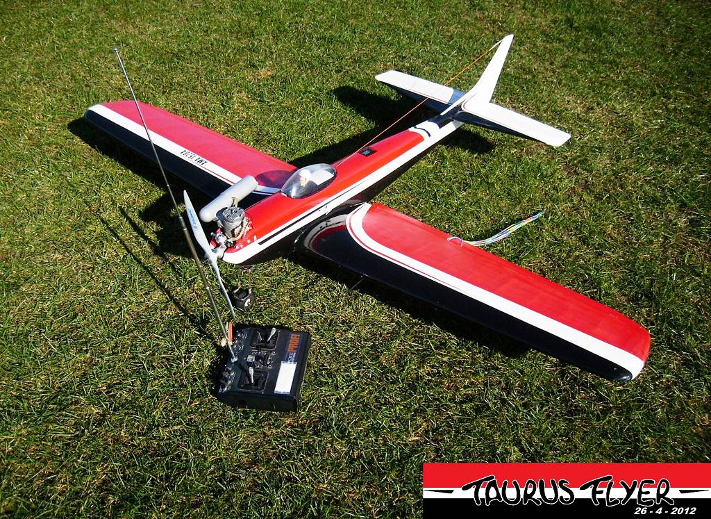

Old 04-26-2012 | 12:01 PM
Taurus Flyer's Avatar
Joined: Jan 2004
Posts: 2,408
From: Almelo, NETHERLANDS
Default RE: Silk Weight
jeffH
For a patternship of 0.60 the 5 mm is too light IMO, especially to spray paint.
I use 6.4 mm see the photographs.
Cees
