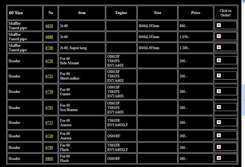

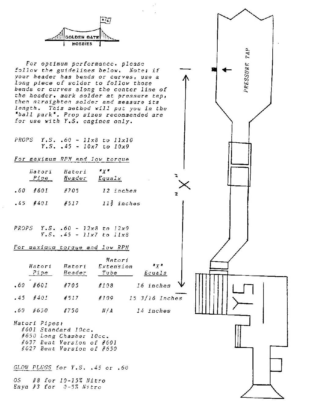

The only problem I am having is identifying the Hatori pipe I have - it measures aprox. 17" from end to end which I believe rules it out as a Hatori 601 and makes it either a 650 or 700. Its the old style smooth tapered finish no ribs or bumps where there are baffles. Hopefully someone can definitely state exactly what the end to end length is for each of the popular Hatori pipes (ie 601, 650, and 700).
I did find some information on line, but there are some conflicts in the numbers - note the 700 length dimensions differ.
Any help is appreciated. Attached are a couple of picss with sizes, but need clarification or confirmation of the same.

a 17" pipe is pretty long (700 series) and I doubt it will be well suited to a short stroke FR if that's what you want to use. If in addition you are planning to turn 10" props, keep that pipe for the AR's. You'll want a shorter 600 series pipe or a Macs 10cc short stroke.
Oh, you hinted at the idea of cutting the pipe. Don't cut the pipe, cut the header. But you know that no doubt.

Thanks Ferio for the pictures.
Little confused now. I thought after looking at the information I and others posted that the Hatori 650 TUNED PIPE 60L (LONG) was supposed to be aprox. 15"+ long and the 700 pipe is 17"+ long or so as shown above. I also thought the 601 was the shortest chambered pipe in the group for short stoke .60's and high rpm props and measured 15"+. Perhaps I am missing something here. Did they change the overall length or length to the first chamber when they went to the ribbed style finish vs the older smooth ?
My pipes are the non-ribbed smooth pipes like Ferio posted. Wish I had an older and newer Hatori catalog with exact spec's to have for reference - can't find online. Anyone have a pdf. version with pictures and specifications of these pipes ?
Attached is a pic from an ad I found showing a guy selling a Hatori 650 pipe with his Hanno, doesn't look like Ferio's above more like the 15" spec I thought it was - only a picture however. I have a hatori that looks just like the one in the ad and measures 15-1/4" (confusing). Just search Hatori 650 and the ad will come up.
Also the other pic is the 700 pipe and specs right from HatoriUSA website and the pipe is 17" long.........
