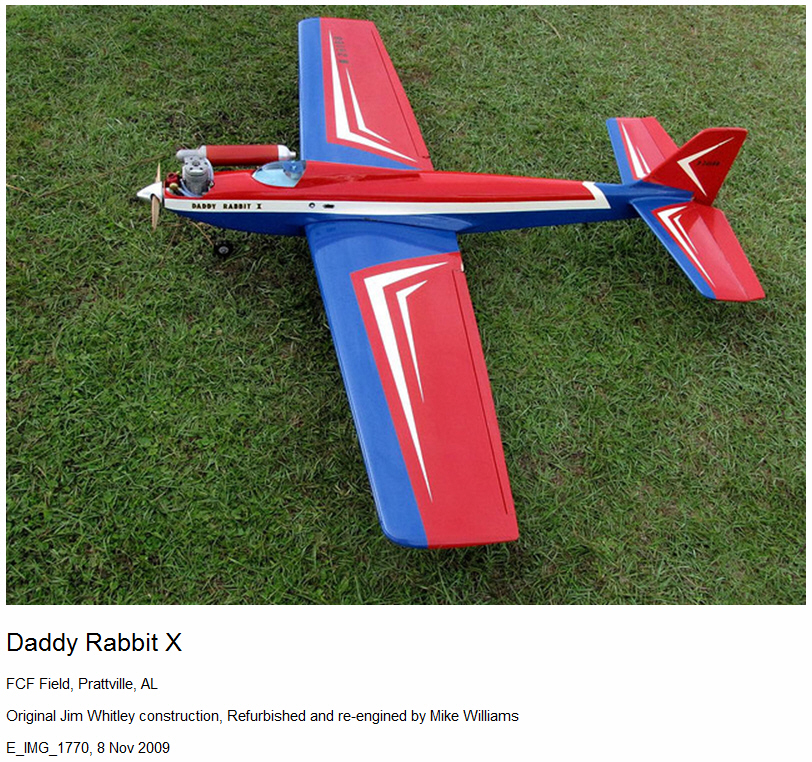

This is Jim Withley's original Daddy Rabbit version X (the last version) that has been restored - see image below, found in some of the SPA's Newsletter.
/Bo
/Bo
