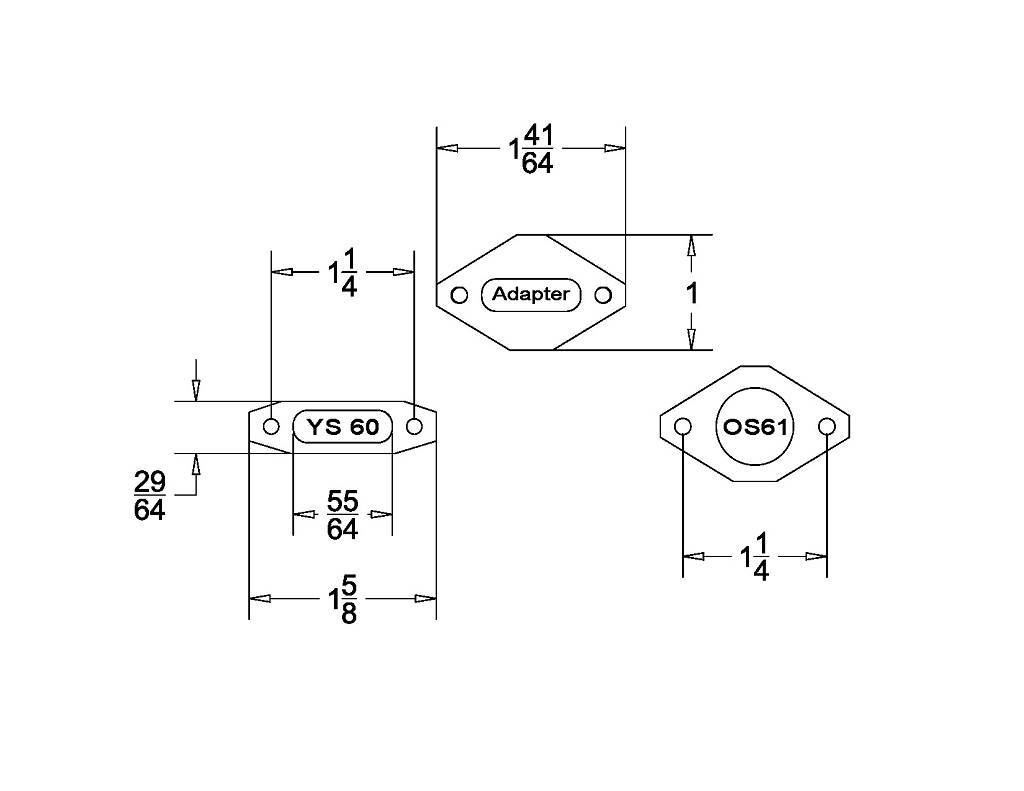

auggie
I got out a YS60 and my Hatori Magic 60 header for a OS Max 61VF just to see if there was any possibility of getting it to work with the YS and as you can see from the first pic the OS Hatori header has a large circle vs a slim rectangular port of the YS 60.
It could be done with an adapter plate and elongating the mounting bolt holes in the header to the outside.Hole diamters are slightly differentthat then the dimensions show witht he YS having a slightly larger centerto center diameter. see pic
The adapter plate could be made very easily out of an 3/16" peice of flat aluminum.
