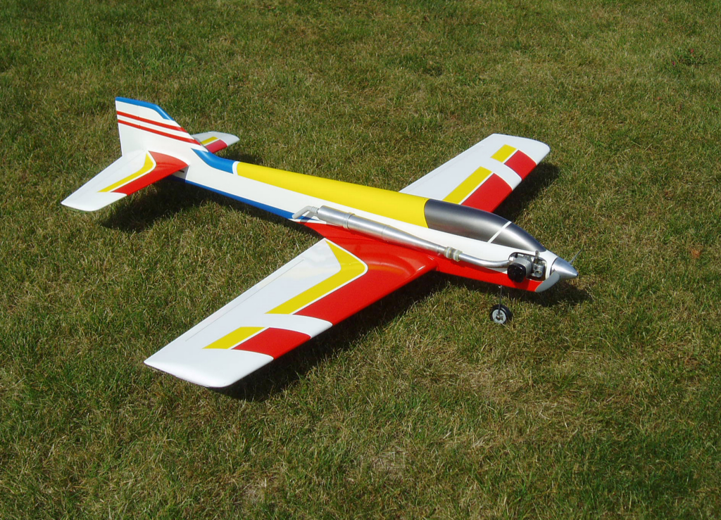

Always enjoy seeing others share their classics so I thought I'd give back a little to the forum as well !!
Tiporare purchased used needing a thorough rehab and lots of paint touch-up from dhal22 (thanks Dave !)
Specs:
YS 61 AR with OPS pipe
APC 11x10 prop
YS 20/20 fuel
All Futaba S3051HV's on all surfaces
SpringAir retracts
Jetronics retract valve buried in the nose
A123 1100 mah battery in the nose
14 OZ Dubro Tank on the C/G
1 OZ of weight needed to opposite wing of pipe
Weight 9-1/2 lbs exactly !!!!
The weight means nothing with the YS AR 61 and pipe. Unbelievable speed and torque for the weight. Rock solid in the air and landings for such a heavy wing loading much to my pleasant suprise.
* http://www.youtube.com/watch?v=4290f...=youtu.be&hd=1 *
Video is only third flight and its cold and my arthritus in the hands limits me from really ringing it out through the pattern.
Also needs to be finely trimmed in spring.
Enjoy !!

Wow that turned out nice. Can I have it back?

That thing hauls! It's way faster than mine.

Beautiful!! Boy that thing really covers some ground!!
