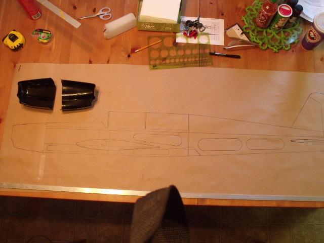

After a few days thought, I drew out enough of a plan sheet to get started. I have a good stockpile of Sig 1/16 contest sheet so I will be using as much of that throughout construction as possible. The fuse sides will be 1/16 with 1/16 vertical grain doublers. Formers will be 2 layers of the 1/16 with 2 oz cloth laminated between, The hatch, canopy , turtle deck and flying surfaces will be sheeted foam. Anyone up for yet another build thread?

What is the size.. fuse lenght and WS.
Old 12-02-2012 | 04:45 PM
speedracerntrixie's Avatar
My Feedback: (29)
Joined: Jun 2010
Posts: 9,713
Received 205 Likes on 176 Posts
From: Happy Valley, Oregon
Default RE: Dalotel
Length is 60" and span will be 62". Looking at about 650-700 Sq in and 7.5-8 lbs. The Rossi I have should pull it around well. I have been using it for Warbird racing and have been swinging an APC 11X11 at 13,500 on the ground. Will most likely set it up with a 13X8 for starters. Not sure what retracts to use, with plug in wings mechanicals can be a hastle so may go with electrics.

David, I had a Bridi kit at one time. Made a ton of mods including trimming it down to 2M and used a wing tube. Sadly never finished it, A bud of mine talked me out of it and the MVVS 1.40 twin I had for it. I have also had a Rogas Modell Dalotel that ended up being powered with a YS .91. Been looking for another Dalotel with no luck. I recently picked up an original Bridi Kaos built about 30 years ago and went out and flew it, had a blast. I have been considering a classic pattern airplane but being me I want something off the beaten path. A slimmed down Dalotel with retracts and a piped Rossi .61 is what comes to mind.
Looking forward to seeing your build.
Are you planning to do foam for the wing, stab and fin? What airfoils?
It looks like you are also planning on a removable fuse pan, or will you do a simple tunnel Bridi style?
Nice mold for the cowl. Where does it come from?
Access to the fuse from a canopy hatch?
David

Dave, the fin will be a nomex honeycomb core with 1/16 balsa sheeting, the rudder will be built up balsa. Wings and stab will be sheeted foam. Wing airfoil is one that I designed a couple years ago and is working well on other models. The pipe tunnel is a simple sub floor just below the wing tube. Access will be through the top via removeable canopy from the back edge of the cowl to the turtle deck. The cowl mold came from an old Rogas Modell Dalotel kit. It came with a plastic cowl that I used as a plug to make the mold so I could lay up a glass cowl for that airplane.
