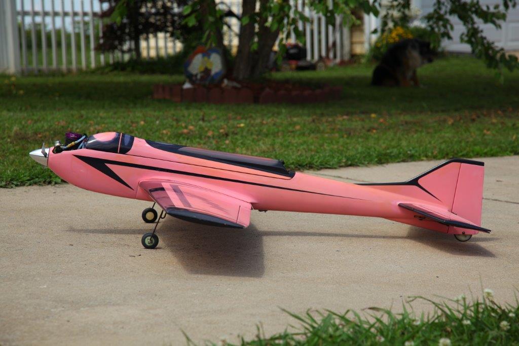

Joined: Sep 2004
Posts: 27
From: Randleman, NC
Here are some pics of my 30 year old Super Arrow. I will be running the engine and doing some test flights tomorrow assuming the weather holds out.
Wayne
