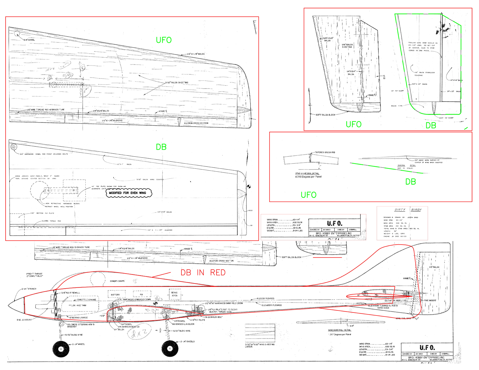

For those curious here's the comparison of the DB and UFO.

Tim,
Show the differences in the wing with the sweep and dihedral, and horizontal with the anhedral verses flat stab....
Then compare the UFO fuse to the XLT...
Brian
Old 08-22-2013 | 03:12 PM
Timthetoolman1's Avatar
Joined: May 2004
Posts: 978
Received 2 Likes on 1 Post
From: Fort Worth, TX
The horizontal looks the same other than it's anhedral on the UFO. The elevators are cut away a bit more which is what we were already doing with the DB.
The wing is 1" longer and swept back on the UFO
Edit: the dihedral on the UFO is 1.317 per side and the DB is .67 degrees per side. This is all measured from the wing tips which is odd because if you round them off like the plans show they don't touch the table.
Looks like the stab has been raised on the UFO to just above the thrust line. That may be the reason for the anhedral stab???
Anything else I'm missing?

The airfoil on the horizontal is substantially larger.. imo. But you pretty much got it. Slight changes, but tell the tale of the change in flight demands.
I am thinking the anhedral might offset the roll coupling caused by the dihedral in the wing. I have to wonder if the purpose of the anhedral was more to do with the genre than the demands of physics. I could be wrong. It would be cool to hear Bridi's explanation.
I saw the XLT fuse layered over the UFO once... It might have been one of Roguedog's posts... I was amazed that the fuse and stabs were virtually the same on both airplanes.
Thanks!
Fun stuff.

Looks like the UFO stab is thicker. I know the P7 and Atlas as well as others had thicker stabs than the DB.
I think you're right about the anhedral and the wing incidence issue. But I've been told it might have been phooey.

Any classic design that had pronounced stab anhedral, also had significantly more wing dihedral. Absent that, the model would not knife edge very well. Anhedral designs also typically have stabs placed at a higher draft because the anhedral lowers the "effective" position. The prime example of these extreme angles in di/anhedral design is Hanno's Magic. The counter design concept would be Naruke's Aurora (thin flat stab and rather thin flattish wing coincident and close to the thrust line).
Bridi's idea behind the thicker stab airfoils as the tail moments increased (UFO, XLT, Escape) was to lower the stall speed on the surface allowing it to produce lift at slower air speeds. I guess the concept was to have the model fly on the wing and the distant stab.
At least this is my understanding.
David

Edited for fuzzy math. The UFO has about 2.65 degrees of dihedral and the DB is around 1.35. I was cutting a wedge for the new DB and it was too big when my band saw was set at 2 degrees and I found the error. :-)
The photo I showed is showing the anhedral stab of the UFO and the dihedral wing of the DB.
