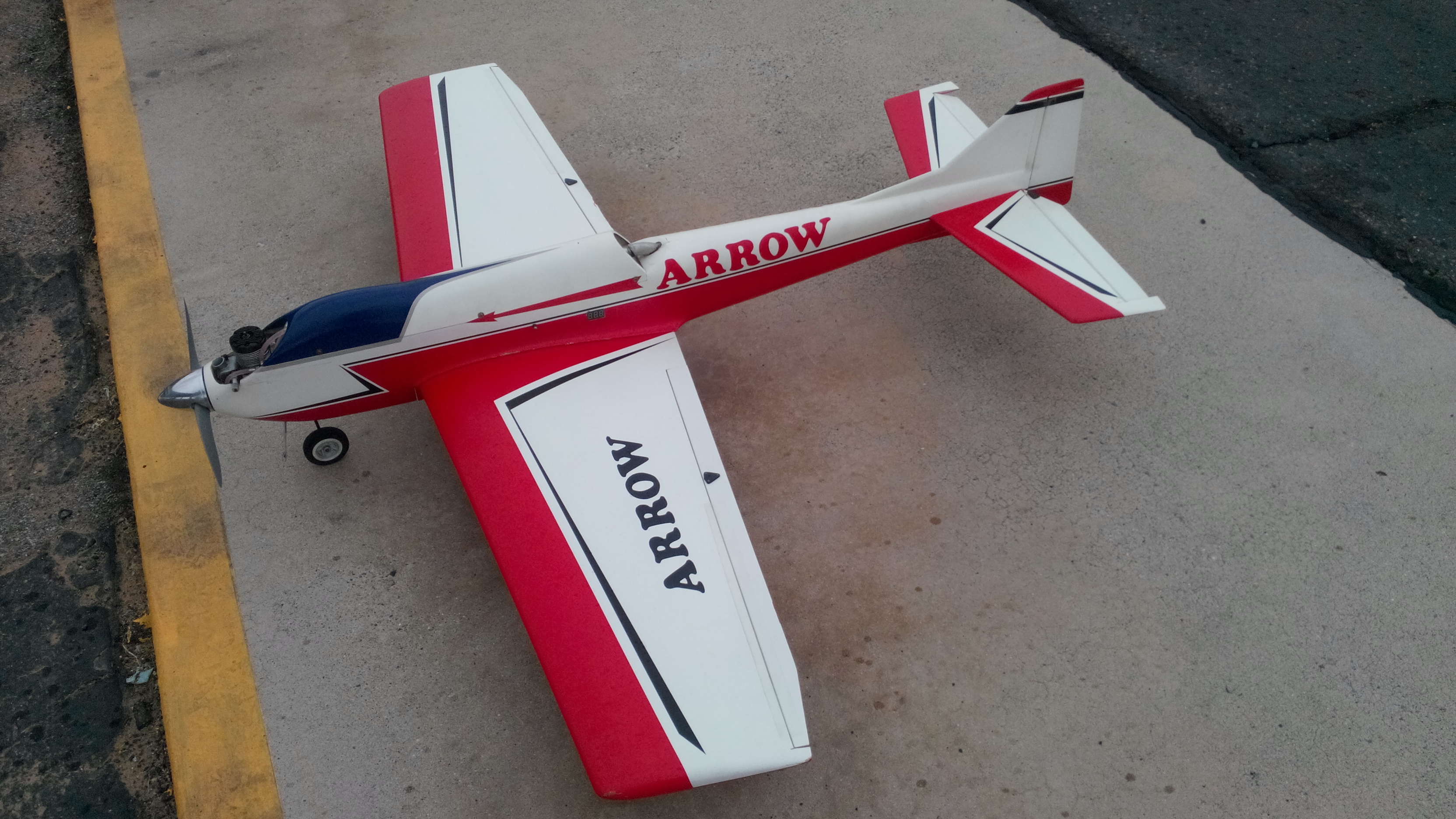

I have a beautiful kit built Arrow 40 with a YS45 RE which I can't get to perform as it should. Everything has been checked but don't have the precise CG info. I'm thinking it might be tail heavy and will fly it this weekend with new CG, but would appreciate expert advice on this plane.
Just a note: I also have an Atlas 60 with a Novarossi 75 that flies awesome. I suppose the little Arrow should be just as good.
Thanks!!
Ed

Old 08-26-2013 | 03:31 PM
My Feedback: (17)
Joined: Jul 2003
Posts: 321
From: Phoenix, AZ
Old 08-26-2013 | 03:32 PM
My Feedback: (17)
Joined: Jul 2003
Posts: 321
From: Phoenix, AZ
The YS45 RE is doing 14,300 on the APC 10x8. 10% Nitro, 20% oil.

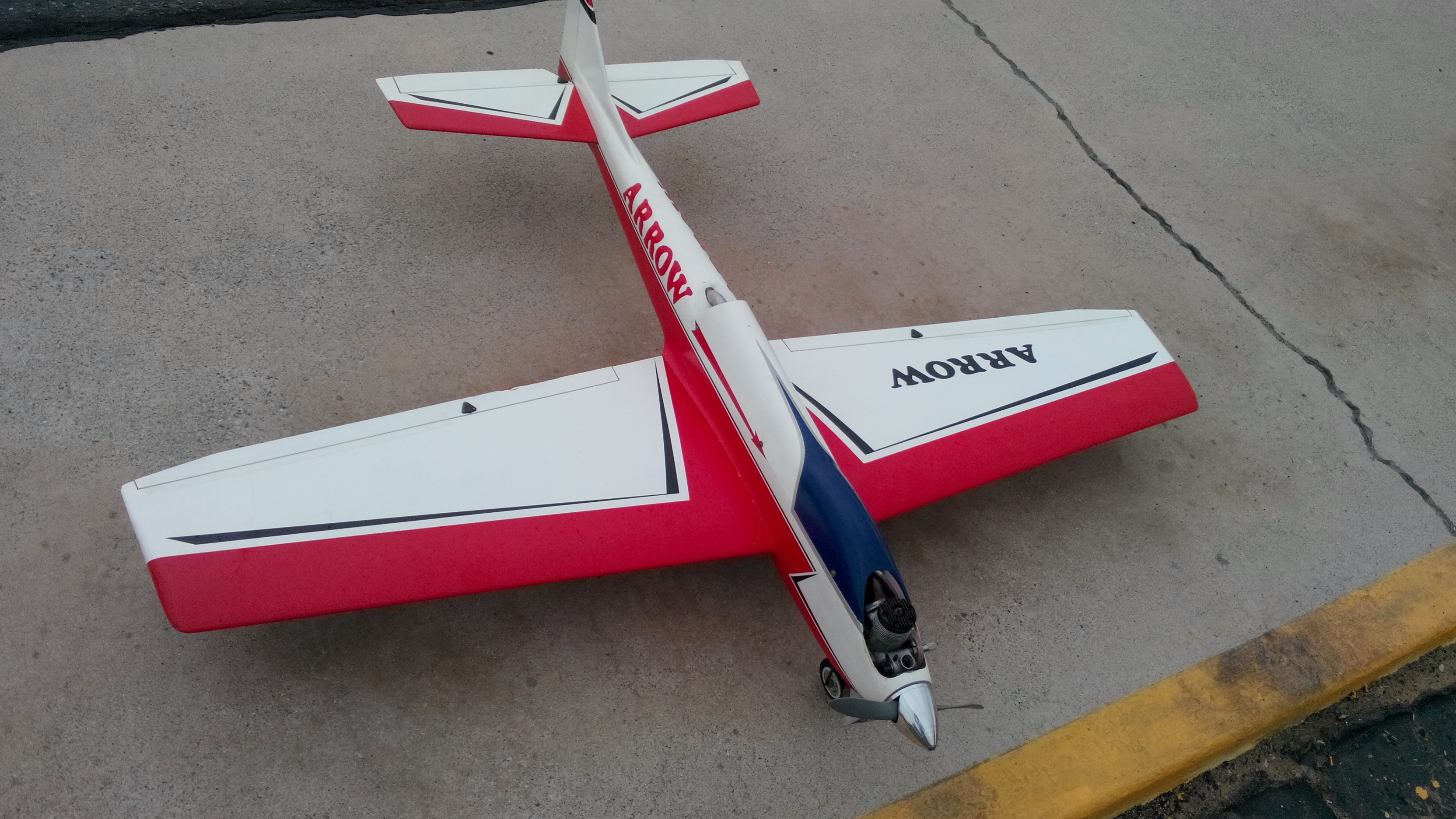

Old 08-26-2013 | 03:43 PM
My Feedback: (17)
Joined: Jul 2003
Posts: 321
From: Phoenix, AZ
Arrow 40
