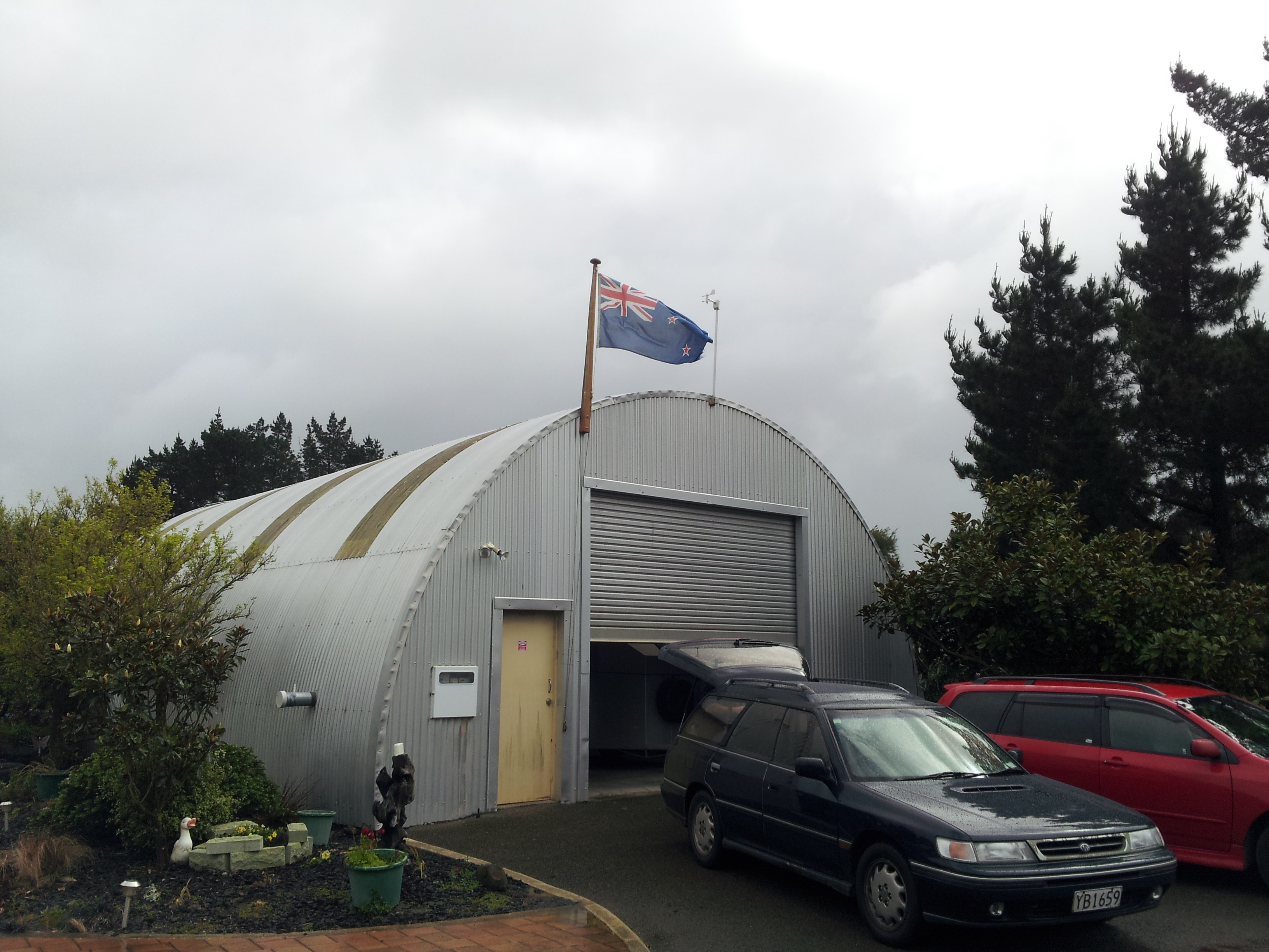

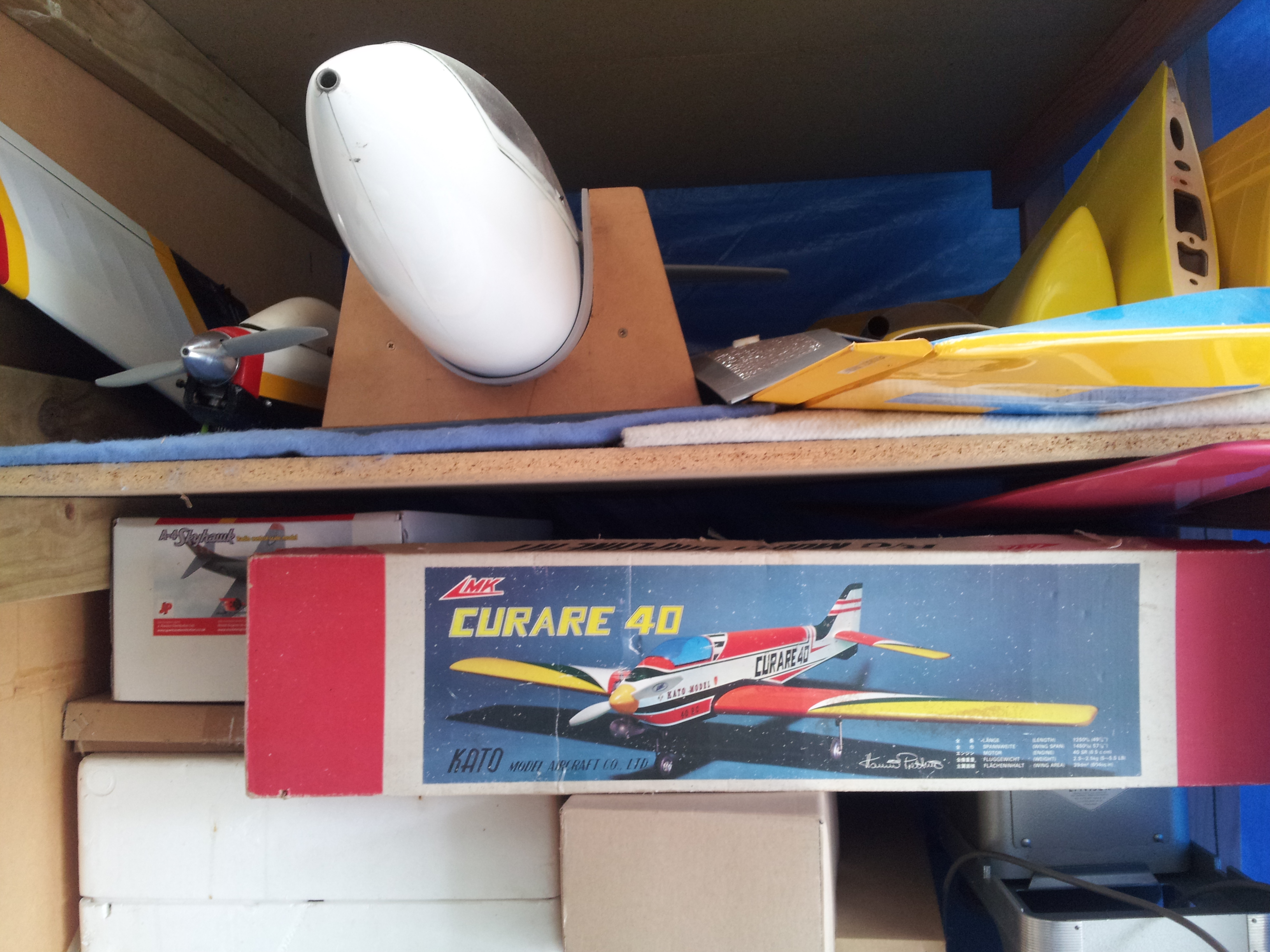

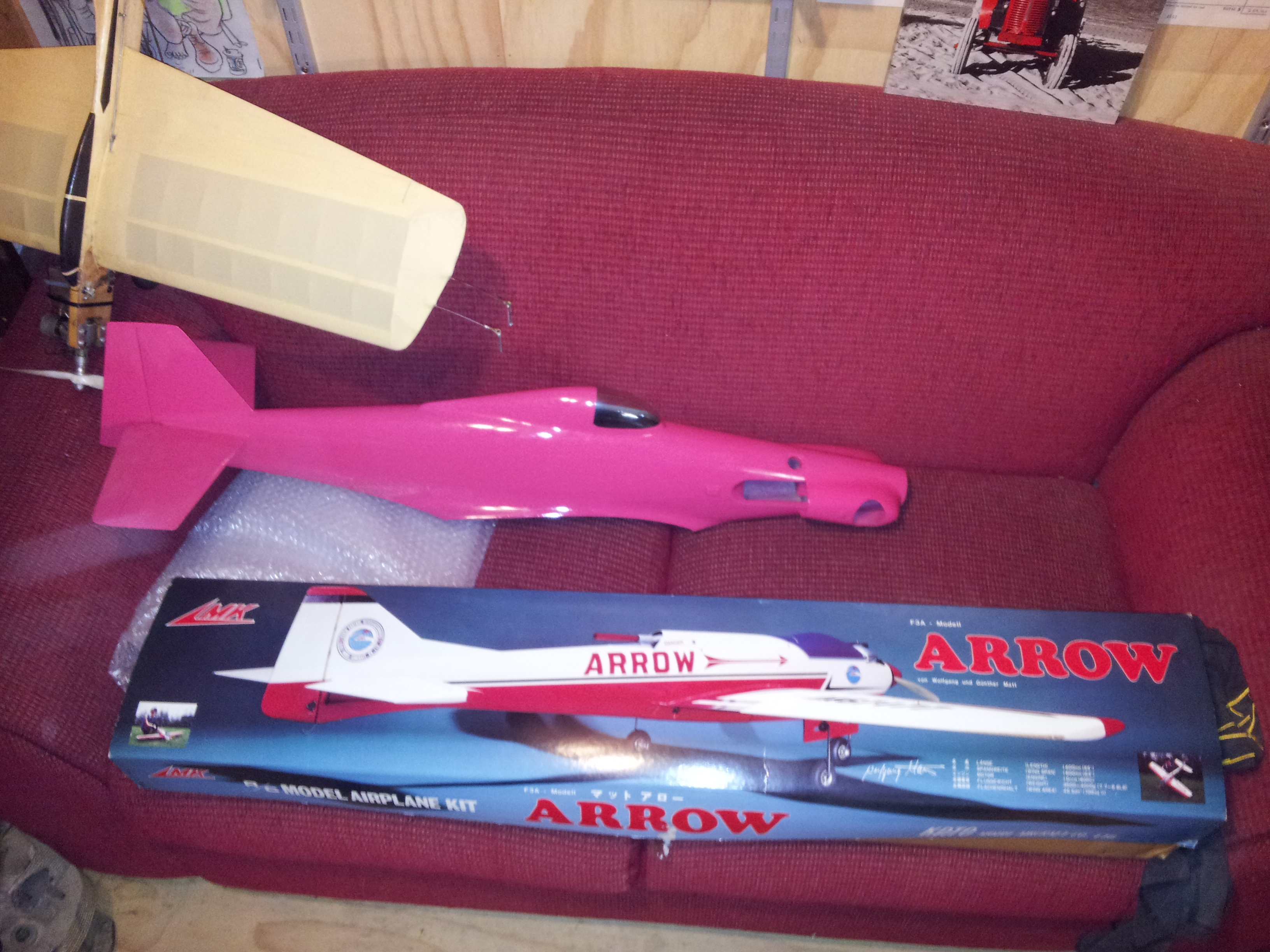

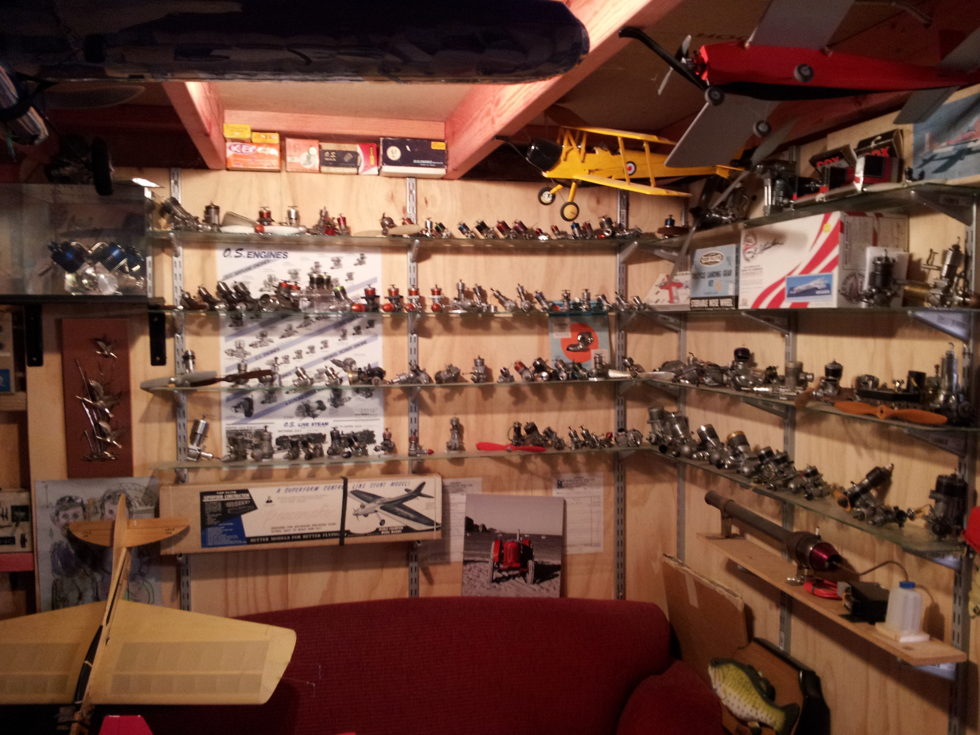

Hello Everyone
The hangar is well... pretty much exactly that... a 6m x 9m half round shed.
The outer part of the workshop is for grubby work such as wood and metal work. At the back of the shed is the man cave.
See how many engines, planes, kits, you can name.
Cheers
Tarquin

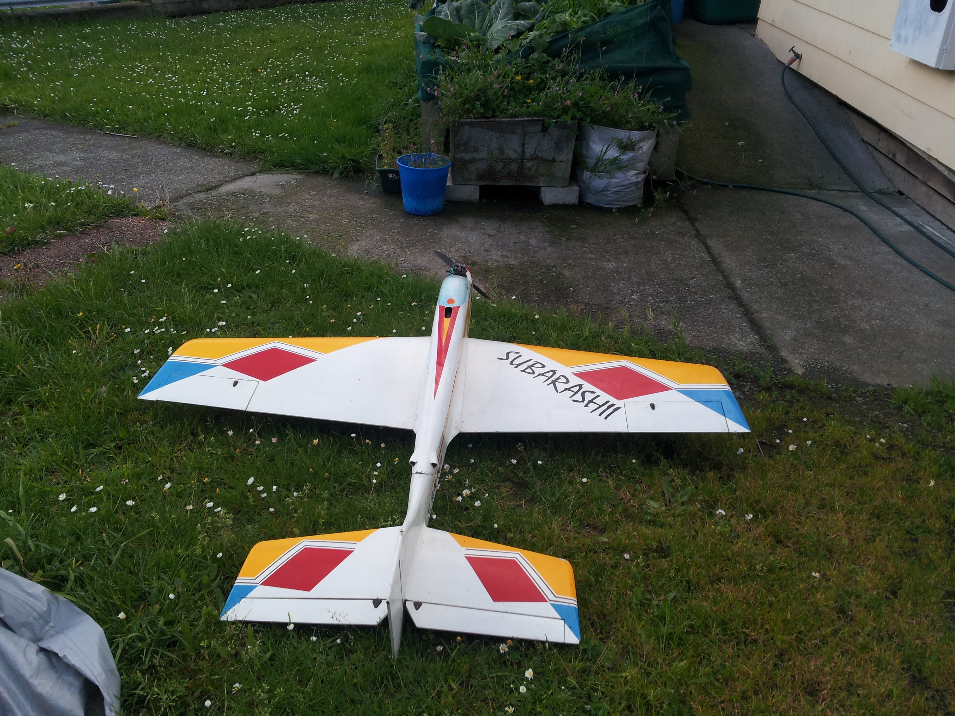

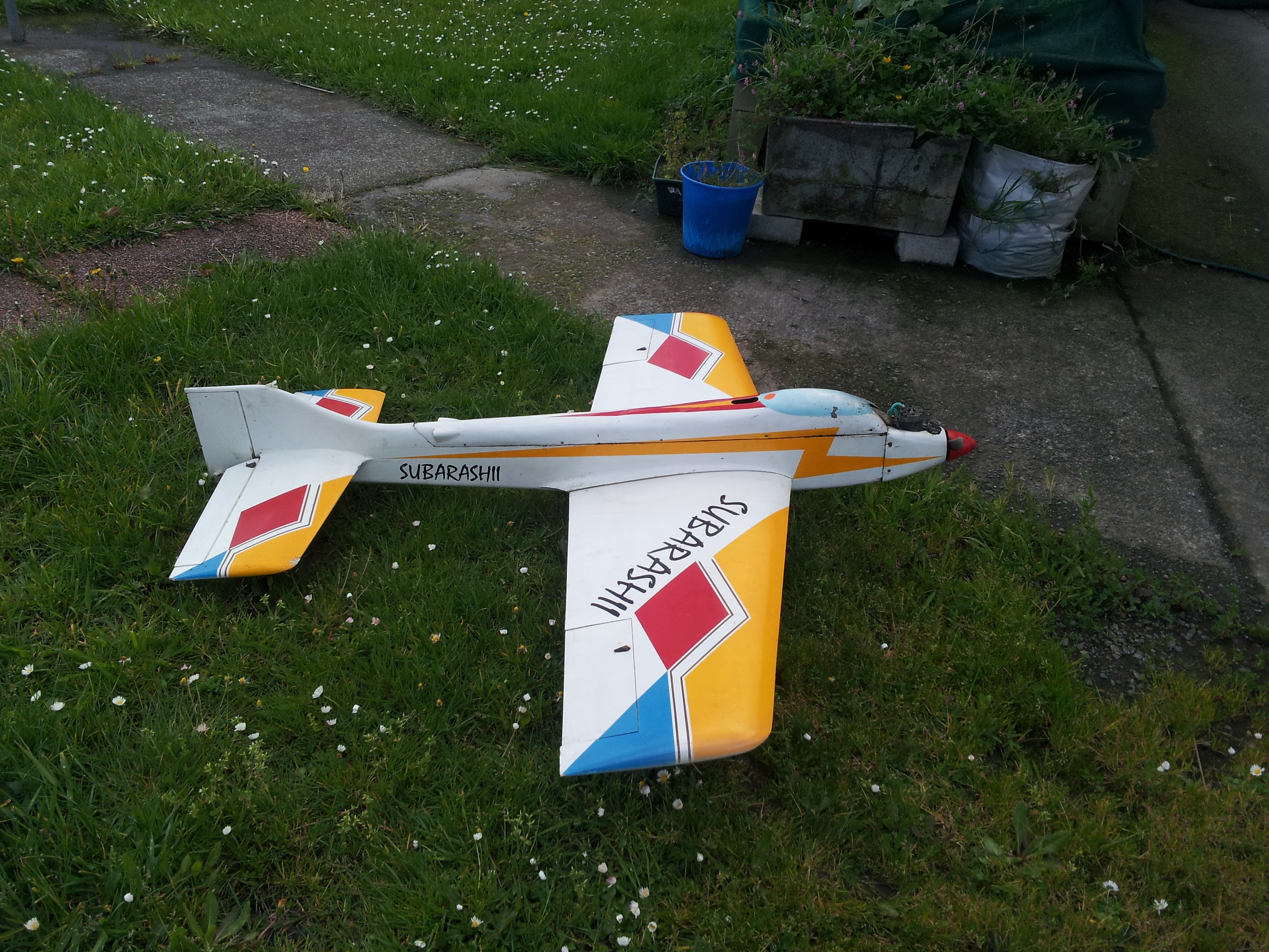

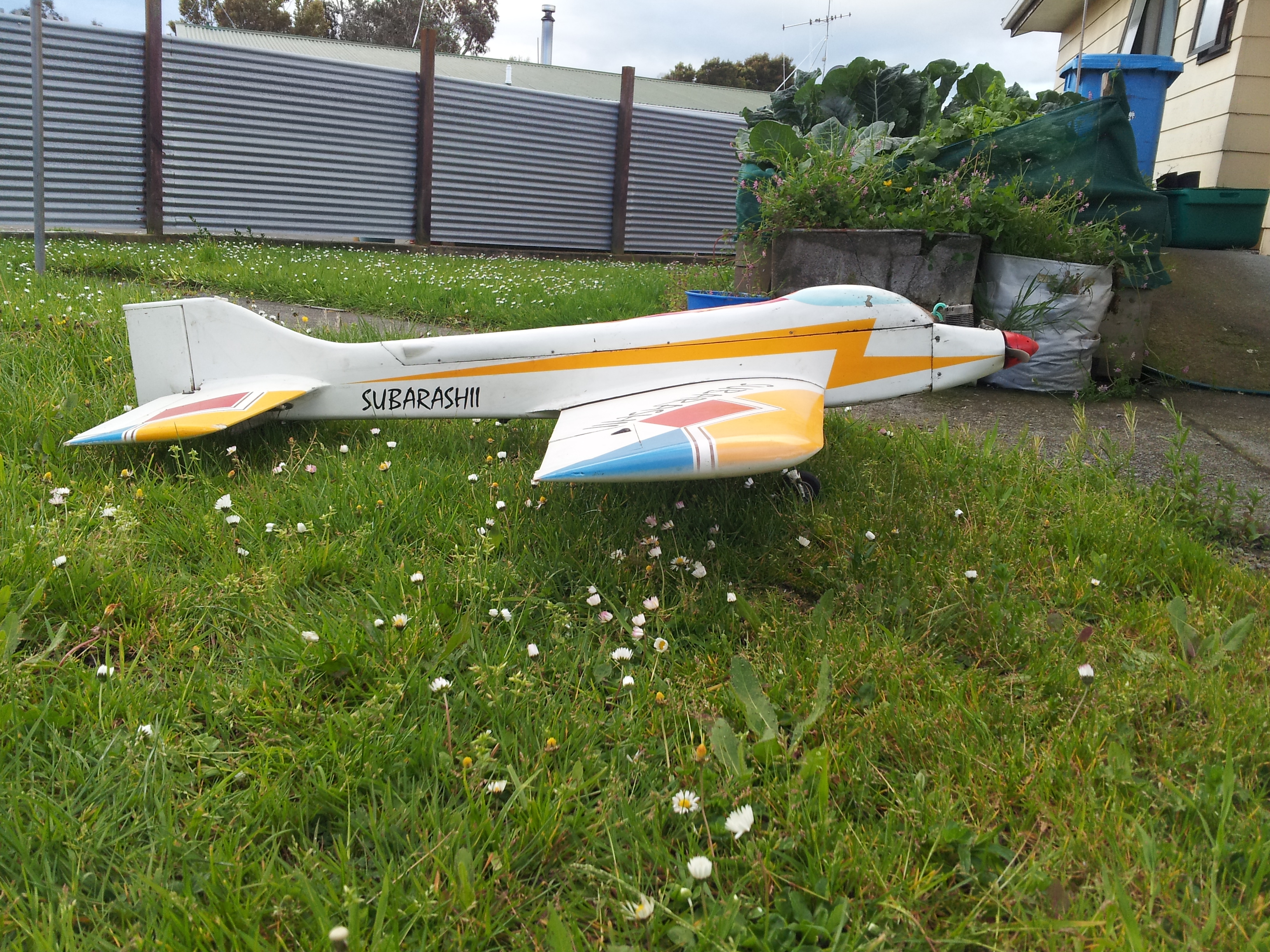

Here are a few pics of the Subarashii.
No can do on the plan front though. The Subarashii was designed by a couple of pattern flyers here in NZ back in the good old days. I believe it was John Rochester and John Knox. I got the plane when Rocky got out of all of his modelling stuff. Unfortunately the plan was not part of the "stash"
Cheers
