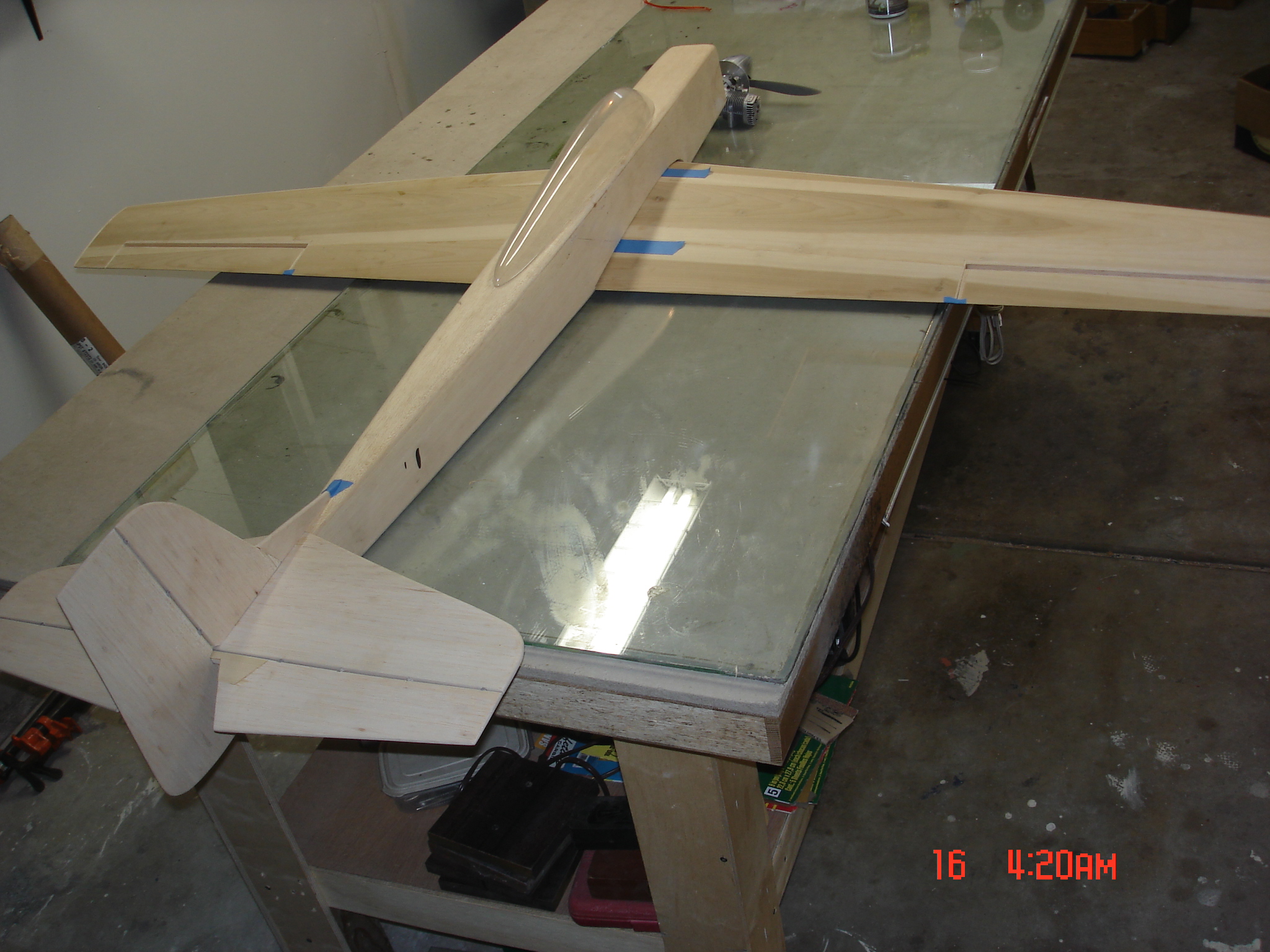

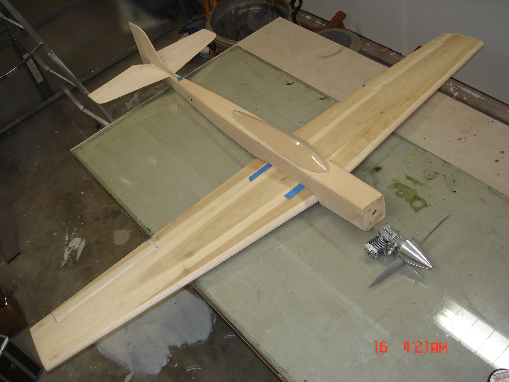

Great looking Kaos. I am offended!!! lol Well, my stab seperated from the fuse one day. I flew that plane really hard for 3-4 years before that happened. My Sunfli is still not quite ready for public consumption. It has been bashed heavily. I used a foam core, and the span has been increased. This is just some parts set next to each other for the pic. The wing will actually be swept back. Now that I have an engine, I will be motivated to finish it.

The one thing I do not like about the Kaos models are the Strip ailerons. Mine would always flex and gave poor aileron authority. My Killer Kaos was much better once I installed the servos in the wing, at the center point of the aileron. Here are some better pics of the Sun Fli, I mad the aileron mod to barn door style. This will perform much better. Brand new .65 AX setting up front. Should be great for this plane.
