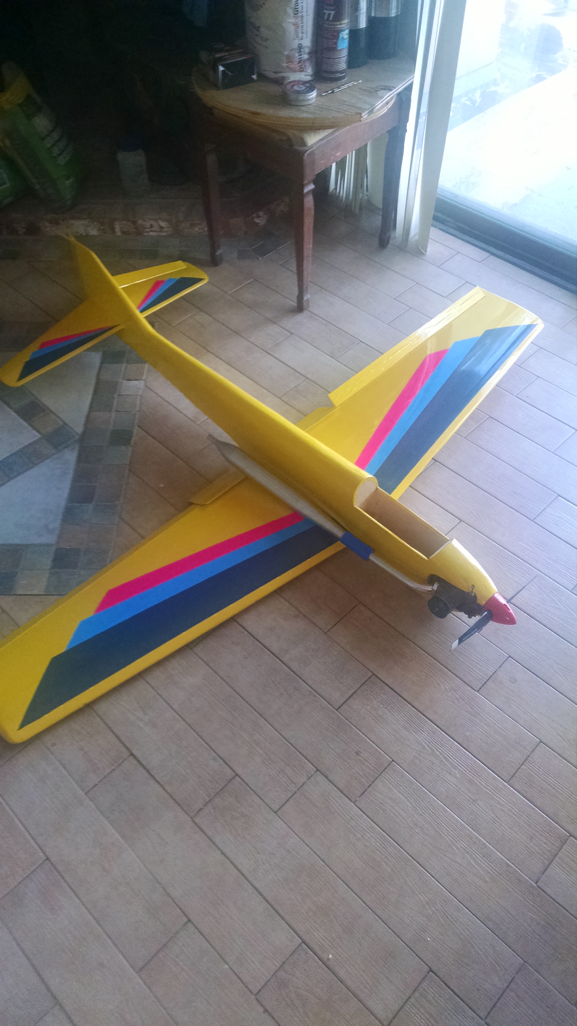

I have a 12 year old Curare I built from plans. It has a few issues. Yes, I was sacrilegious in making it a tail dragger, yes I am very ashamed of this major mistake. It has haunted me since I did it. That is one reason I have not finished it.
I have pulled it down from the dust plane rack, cleaned it up and have looked at what it needs to be finished. I need to form a canopy, get all of the push rods and control horns, decide if I want to use the Vintage Webra Speed .61 Black head with a tuned pipe or get a new .61 in its place or even do I dare go E power if I wont be burned as a hieratic. I have a set of very, very old Robart retracts in it. I was looking for a rebuild kit because I know the seals and O rings have to be shot after hanging in the +5 to 120 degree garage for 10 plus years. So, I can get a new set of mains from Tower for $130.00 ish or a set of electric retracts for about the same price.
Other then being a tail dragger, the plane is in really good shape. No real hanger rash. I do need to iron a few edges here and there plus add the colors to the fuse. I cut the cores and sheeted it myself. Still have the templates if I cut another set.

Yes, of course finish it, and post your progress for all to see. Don't worry, the Classic Pattern Police are not going to castigate you (too much) for making it a taildragger, or electric if that is what you choose to do. F'em if they can't take a joke.

nice bird. I won't comment on the retracts but will on the engine.
To me, the Webra is the perfect engine for the model. Not only is it period correct but it also is model and designer correct. Although Hanno put his pipes under the wing with SE Webra Speeds, the RE Webra Racing has a tad more power. They can turn an APC 11x7 just shy of 15K on 10% fuel and a Dynamix carb with proper pipe tuning.
my next choice would be the Magnum but nothing quite like an Austrian engine in a very famous Austrian classic!
