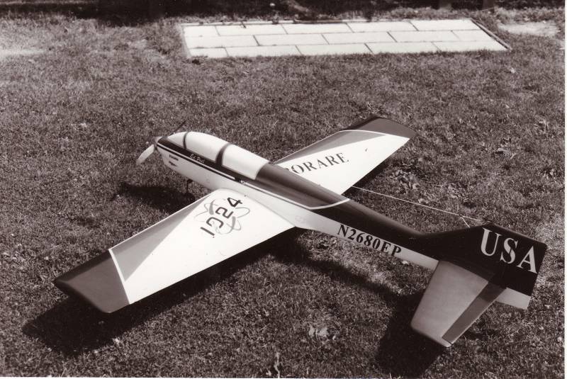

Bruce,
Frank's way is the way I do all my fiberglass fuselages. I built three of the GP Tiporare.
Good flying birds. It does hold the knife edge very well. This is a pic of my first one in '86 after my four year Navy stint.. Colors are red, white and blue. Good luck w/ your build

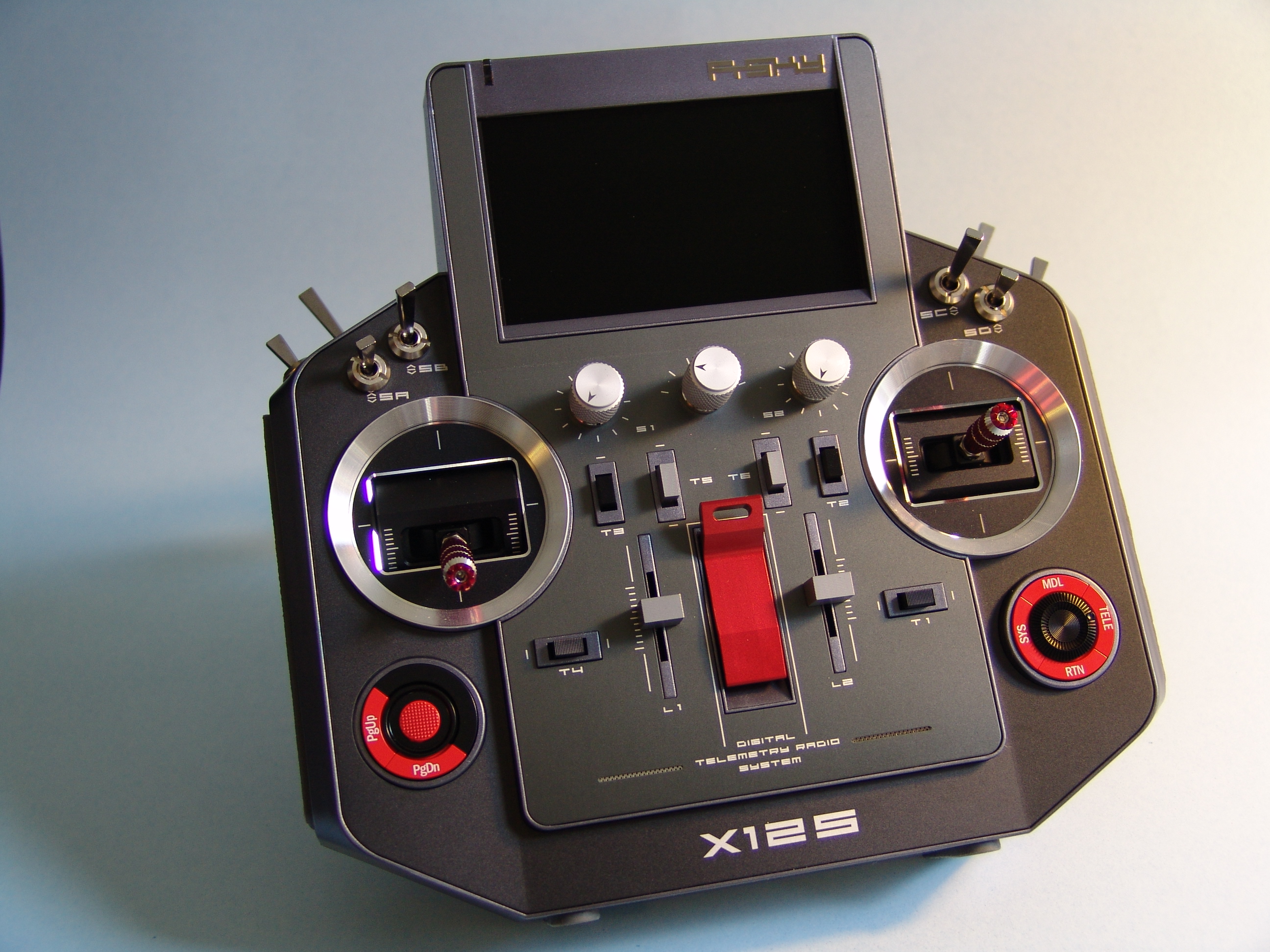

Hard not to love a Tiporare. Powered with a OS 61SF-P with pipe and Spring Air retracts. Control system FrSky Hours X12S Telemetry system. Running FrTX OS.
Mike
