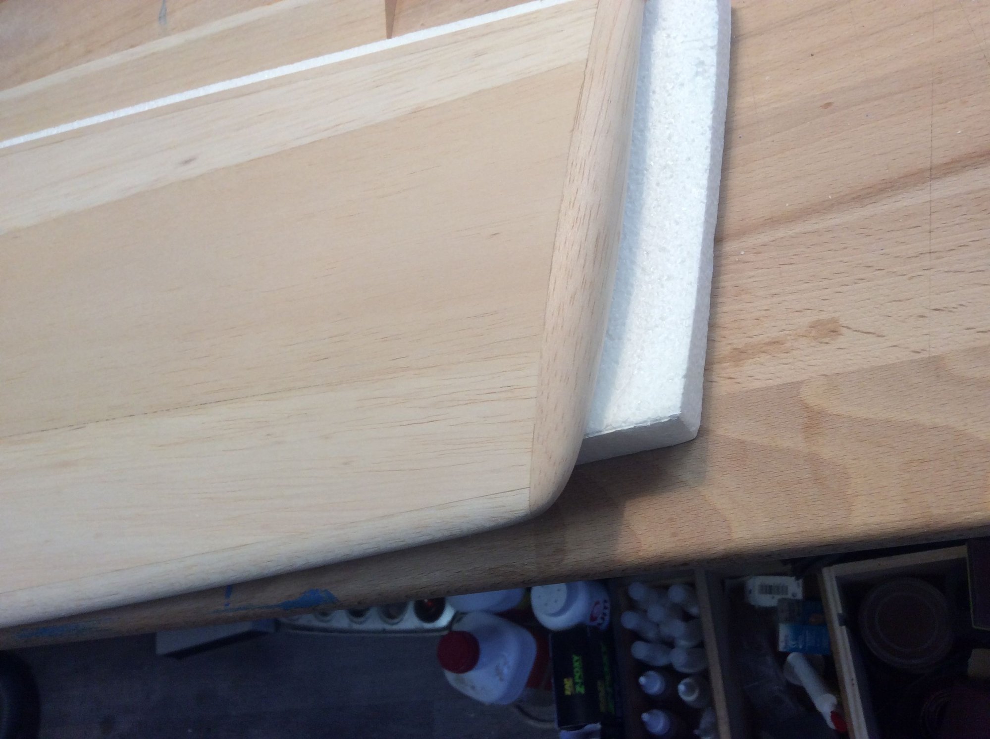

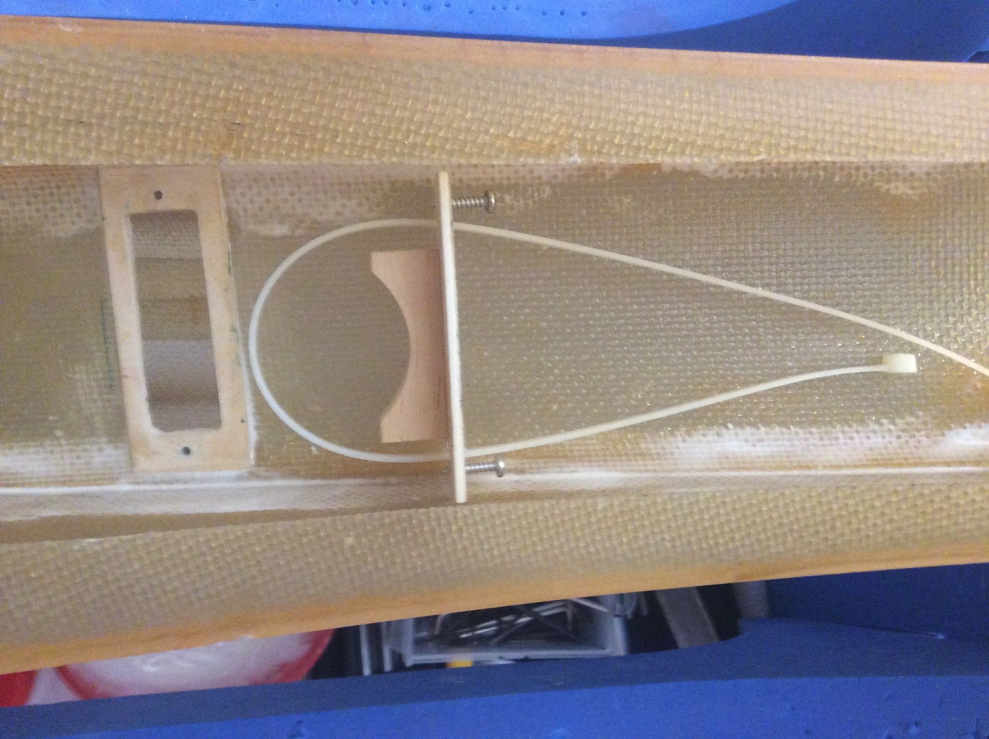

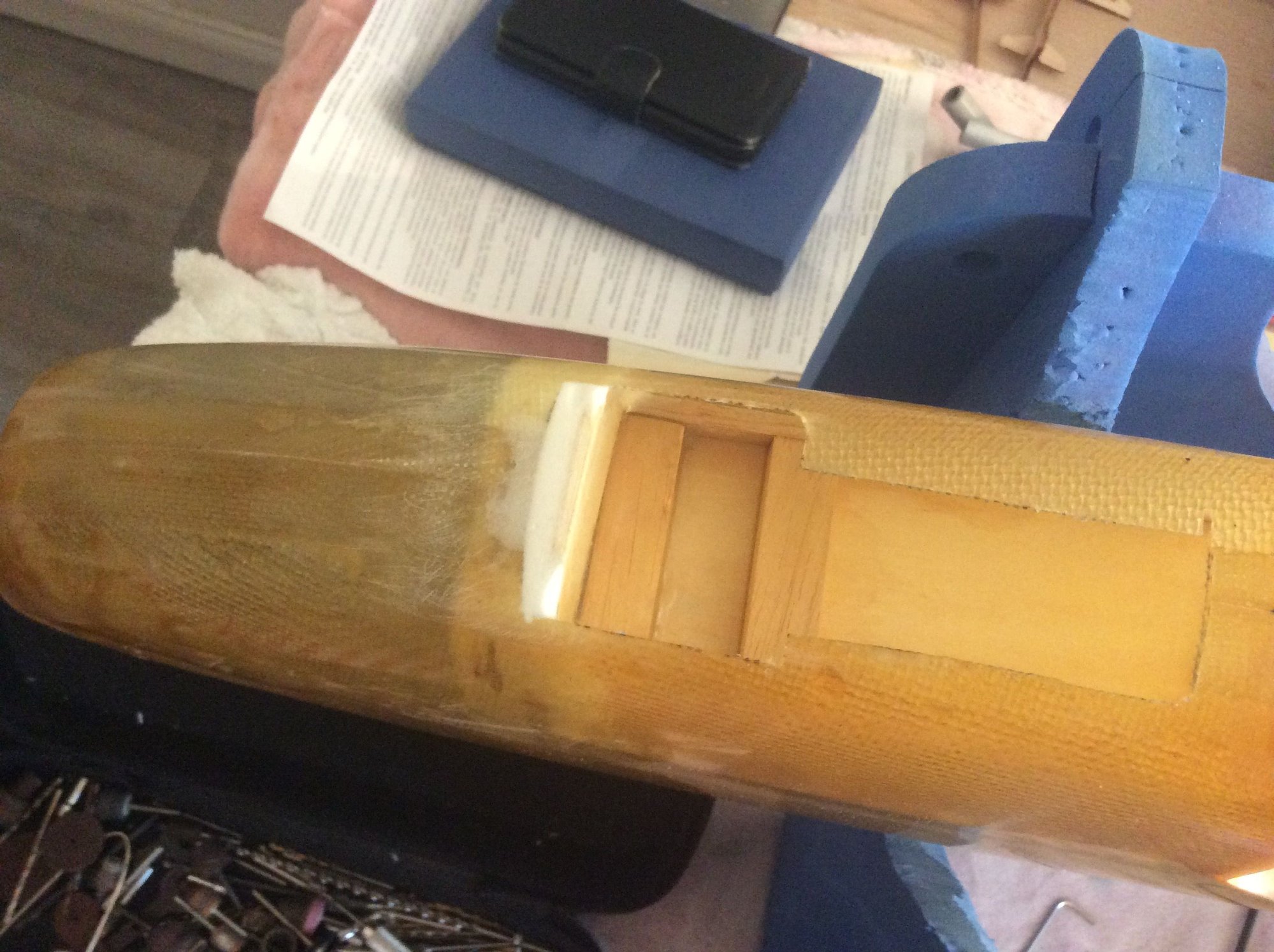

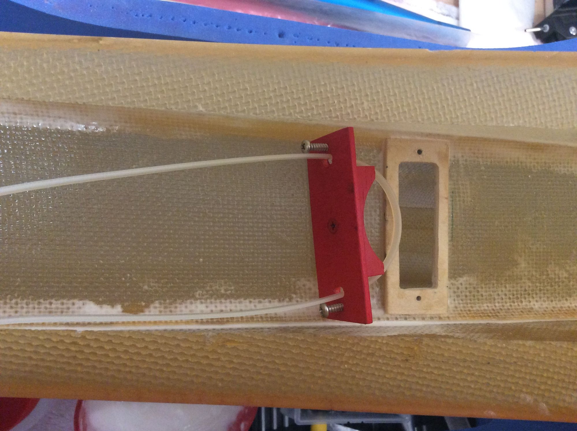

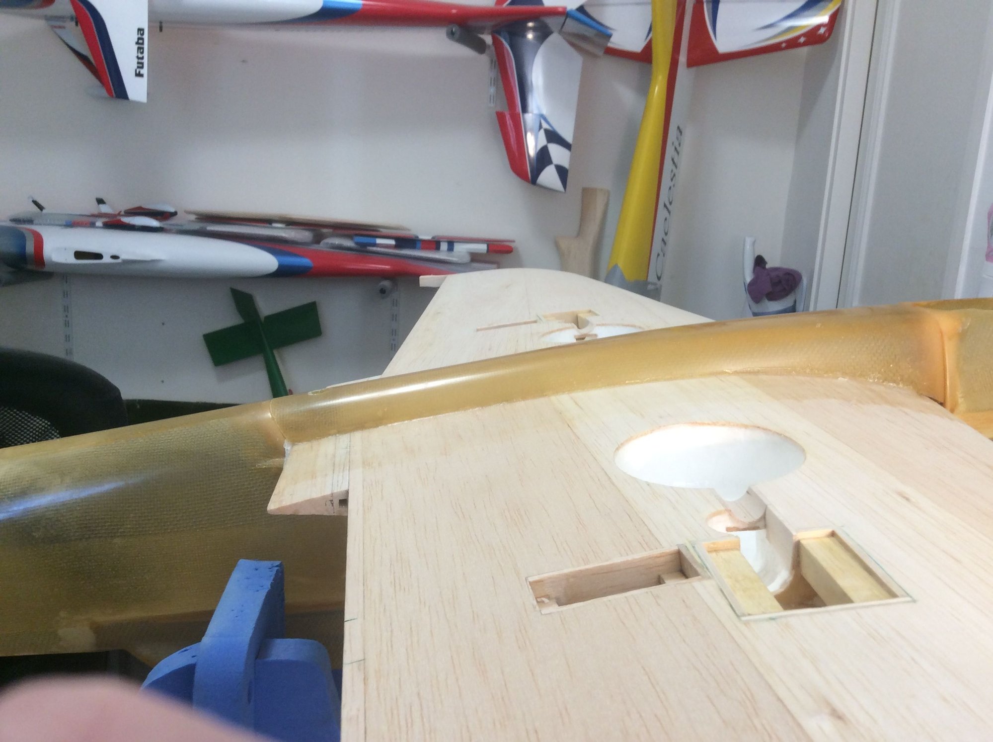

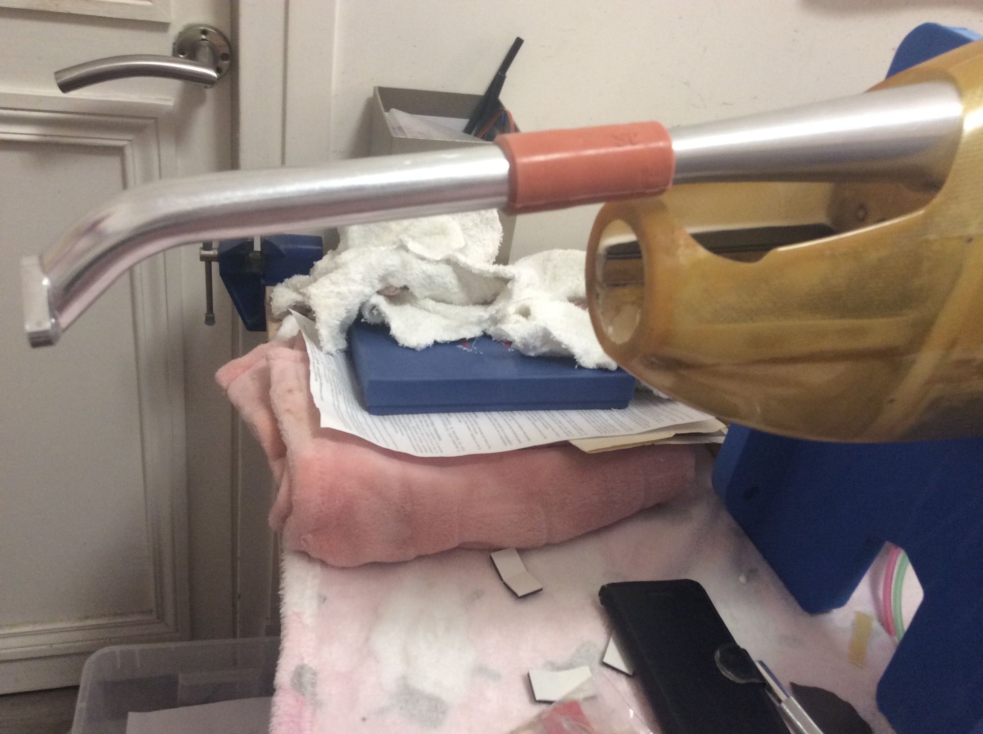

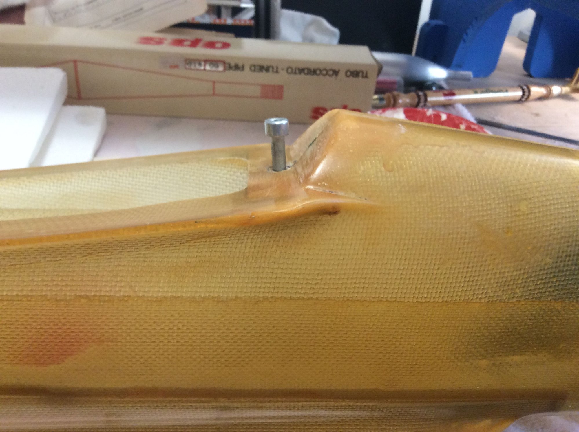

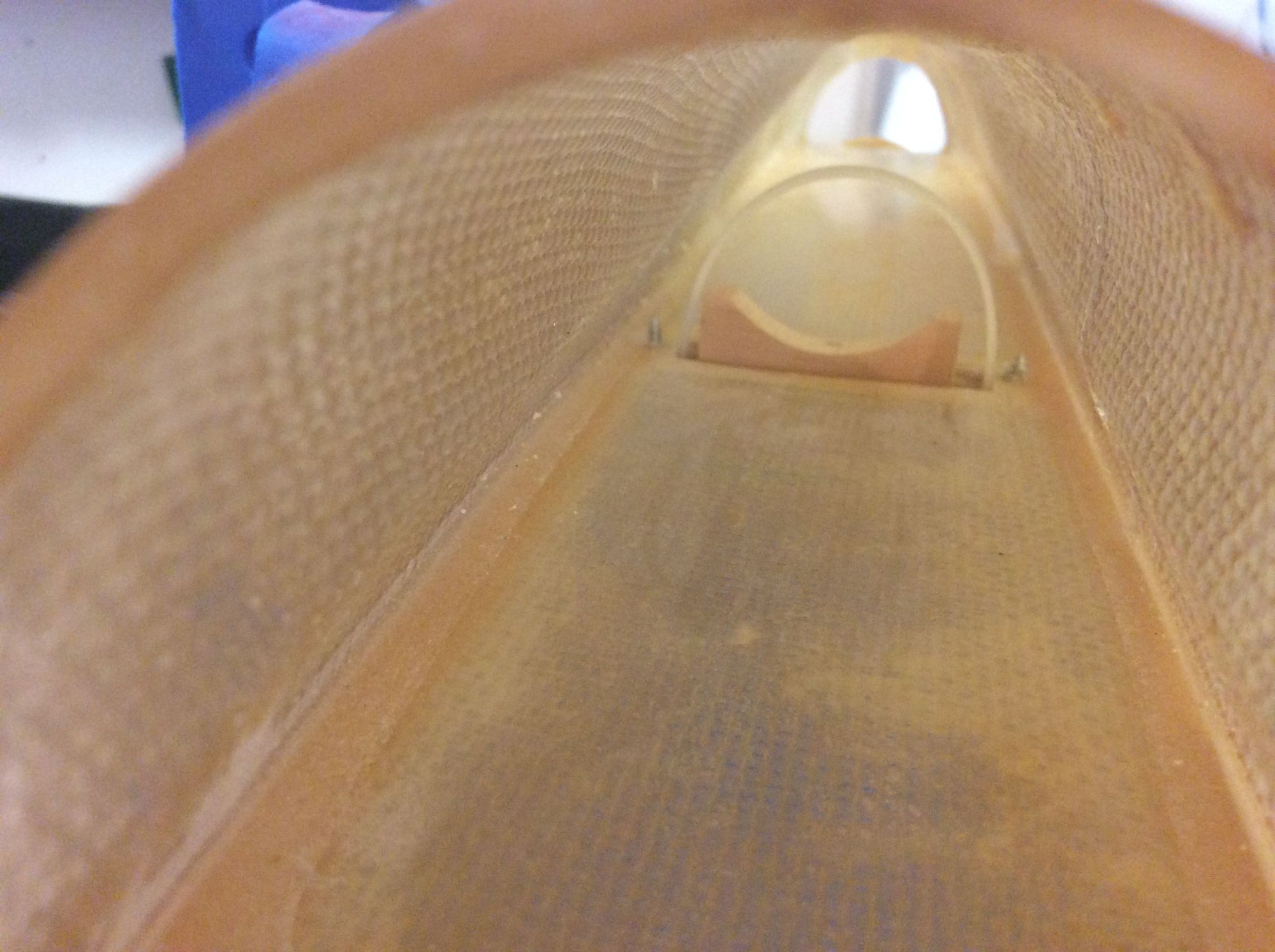

Installation of the tuned pipe without having to make a removable hatch.

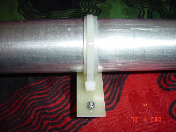

Hello Fred
Very clever !
But will the rilsan tierap hold the heat?
A+
Old 04-27-2020 | 05:29 AM
  #30
Joined: Dec 2019
Posts: 109
Received 5 Likes on 4 Posts
From: SAINT GERMAIN EN LAYE
Hi Claude.
This is exactly the question I ask myself.
I'll see if I can't find another metal necklace
Old 04-27-2020 | 06:13 AM
  #31
papaone's Avatar
Joined: Mar 2005
Posts: 1,414
Received 137 Likes on 74 Posts
From: Salon, FRANCE

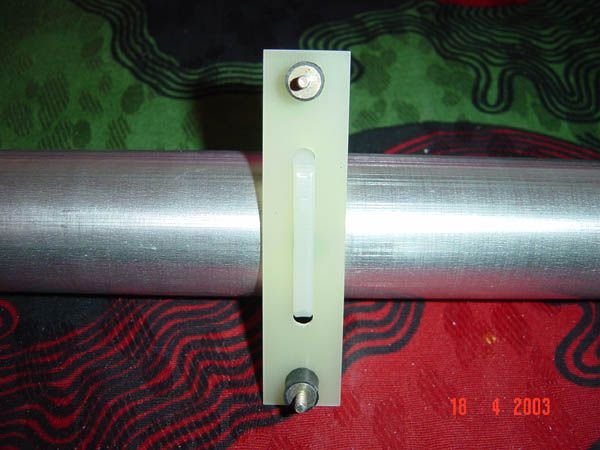

Hello Fred
I found these pictures.
Protection is made with silicone.

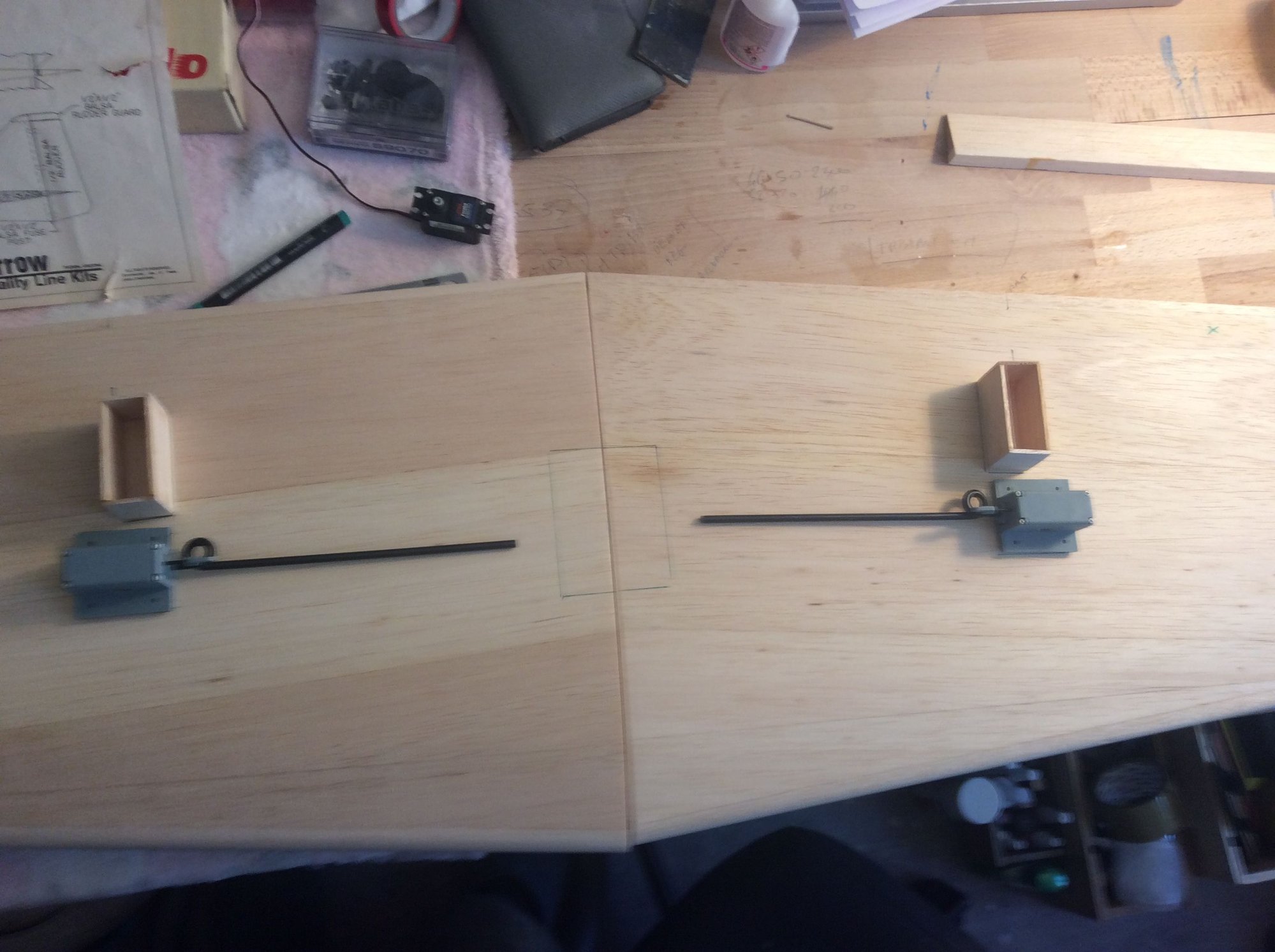

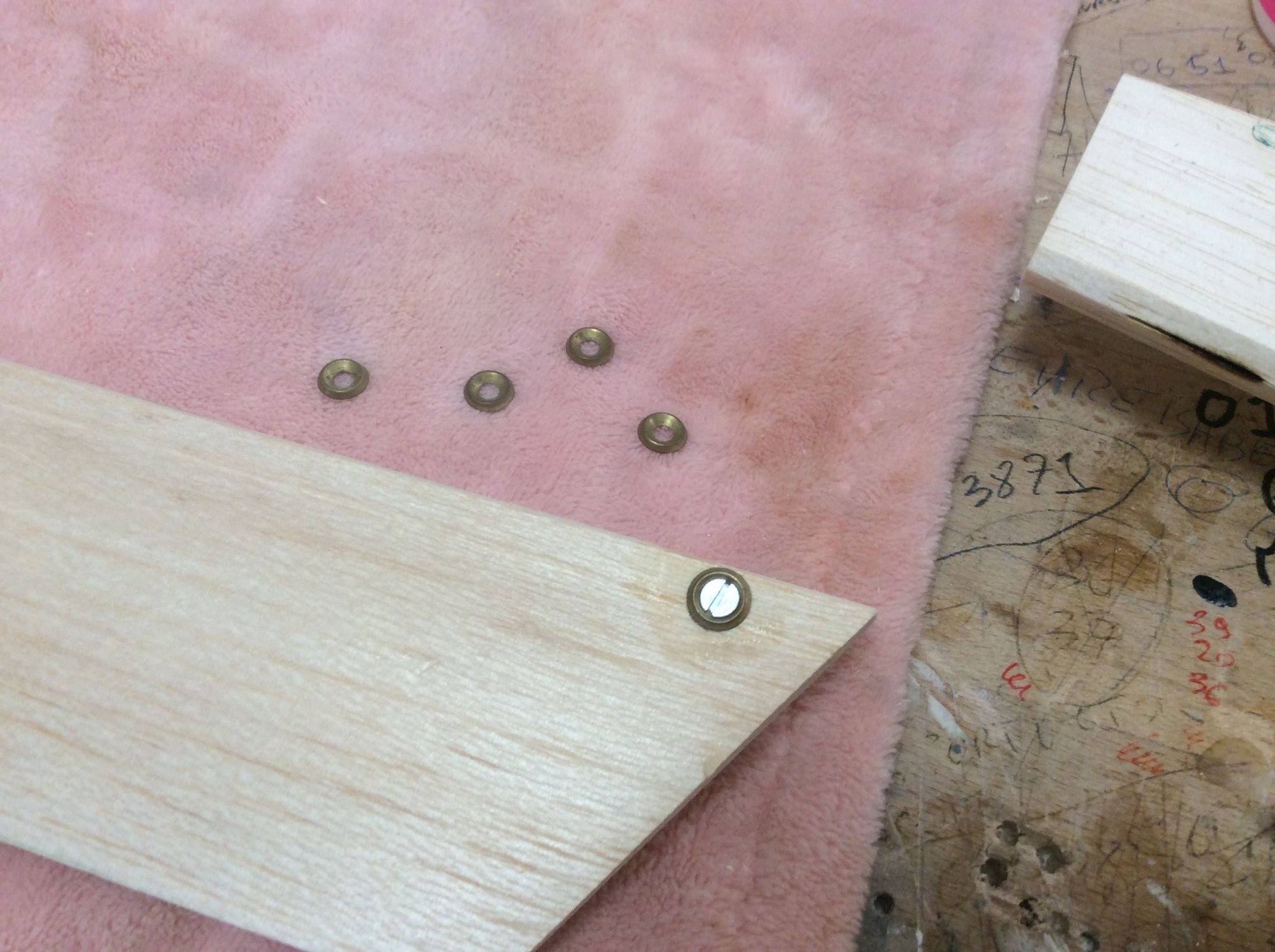

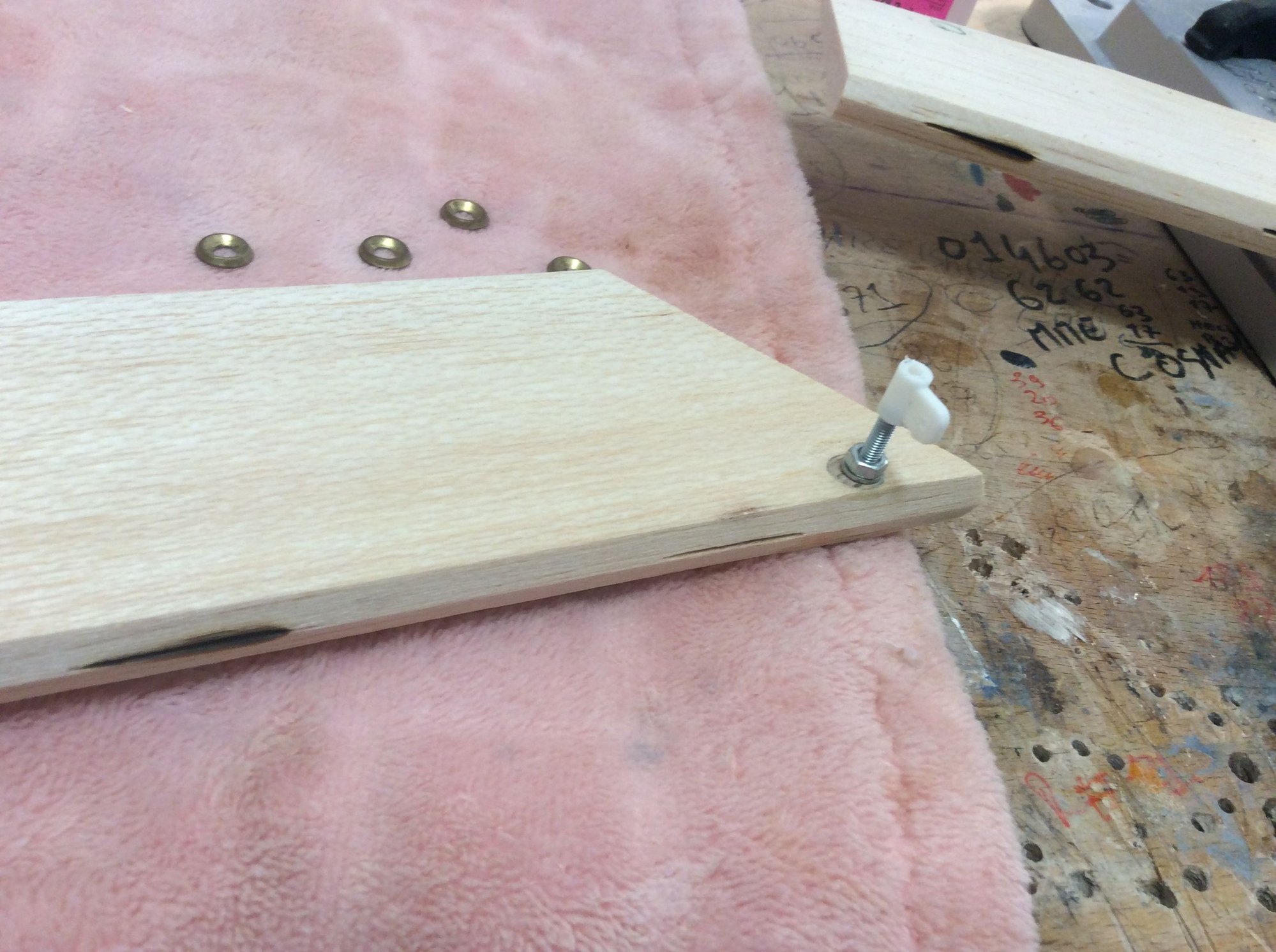

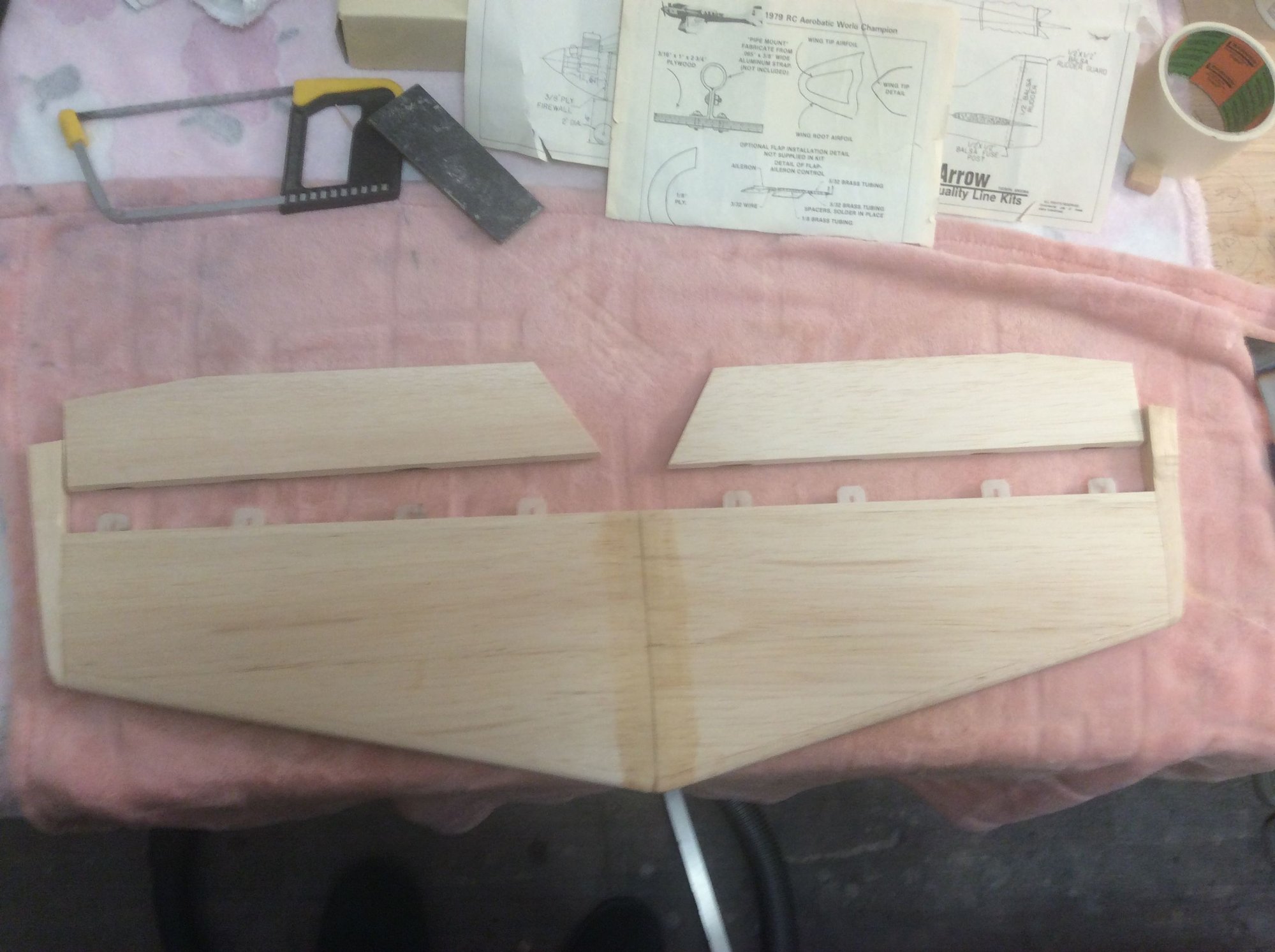

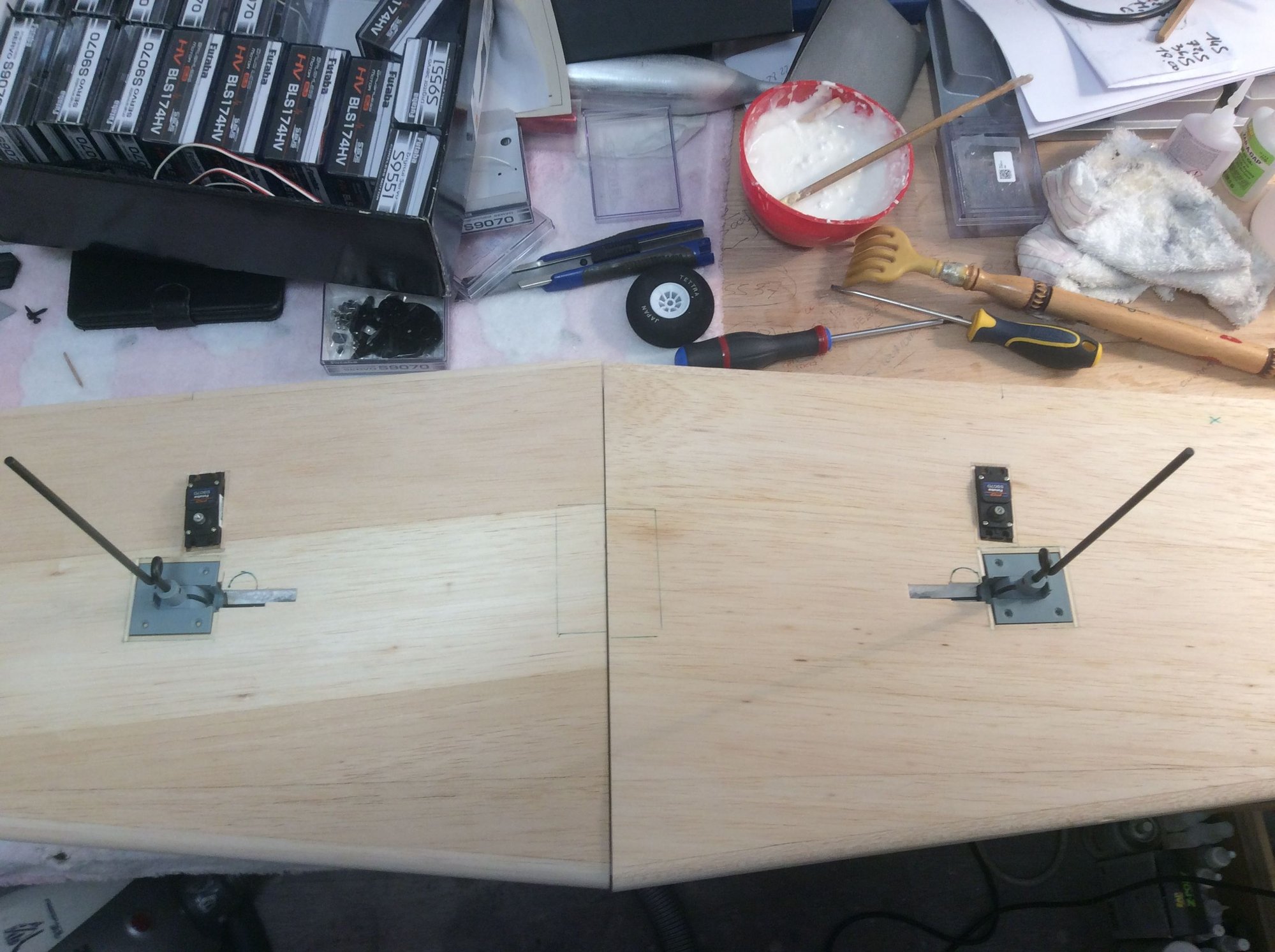

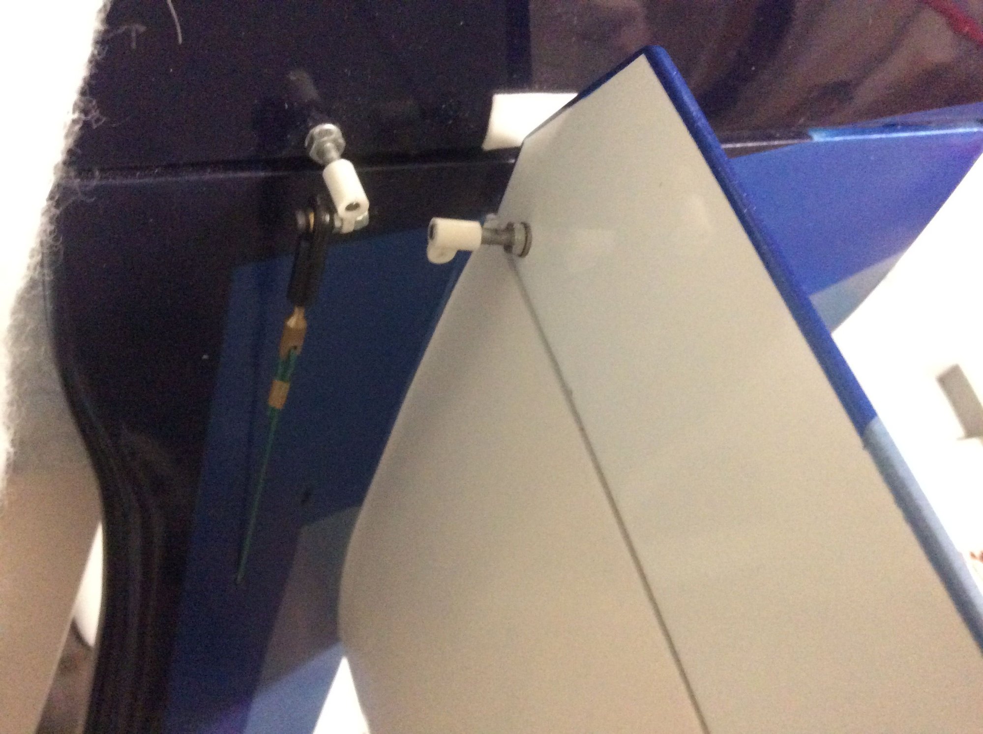

Simple control horn production.

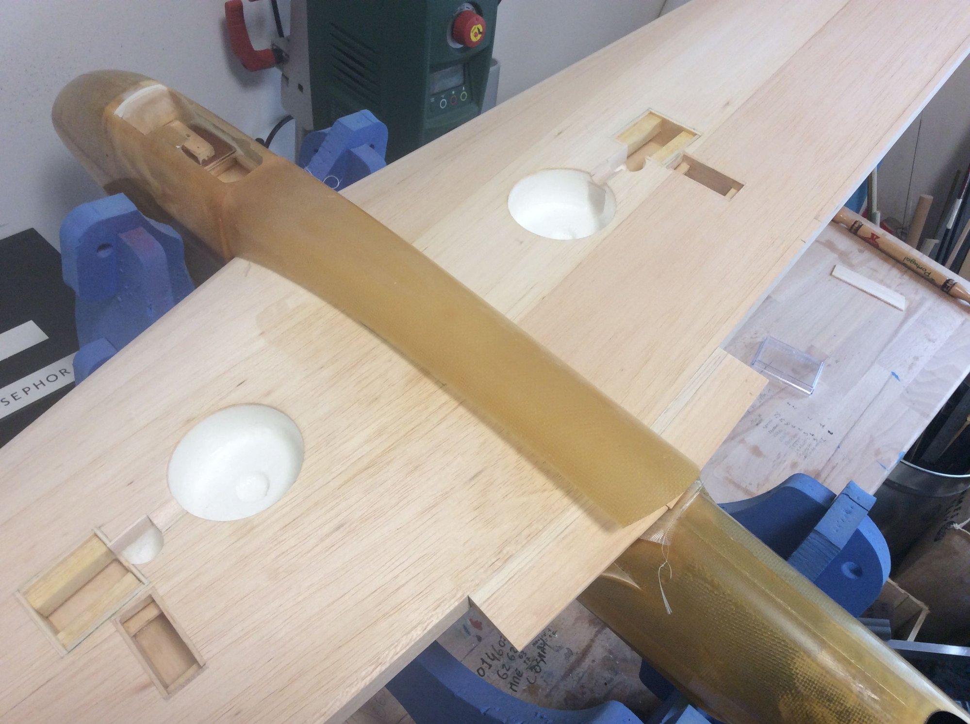

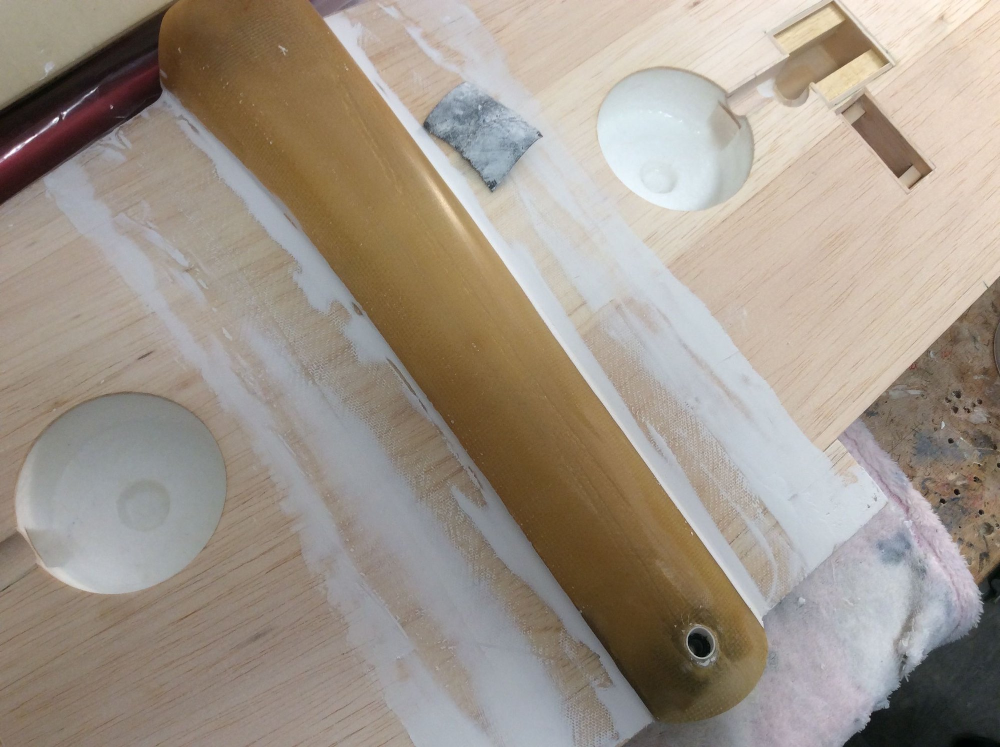

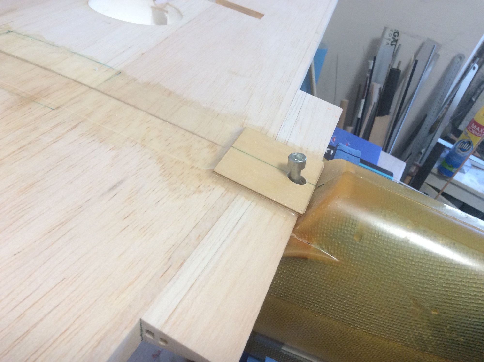

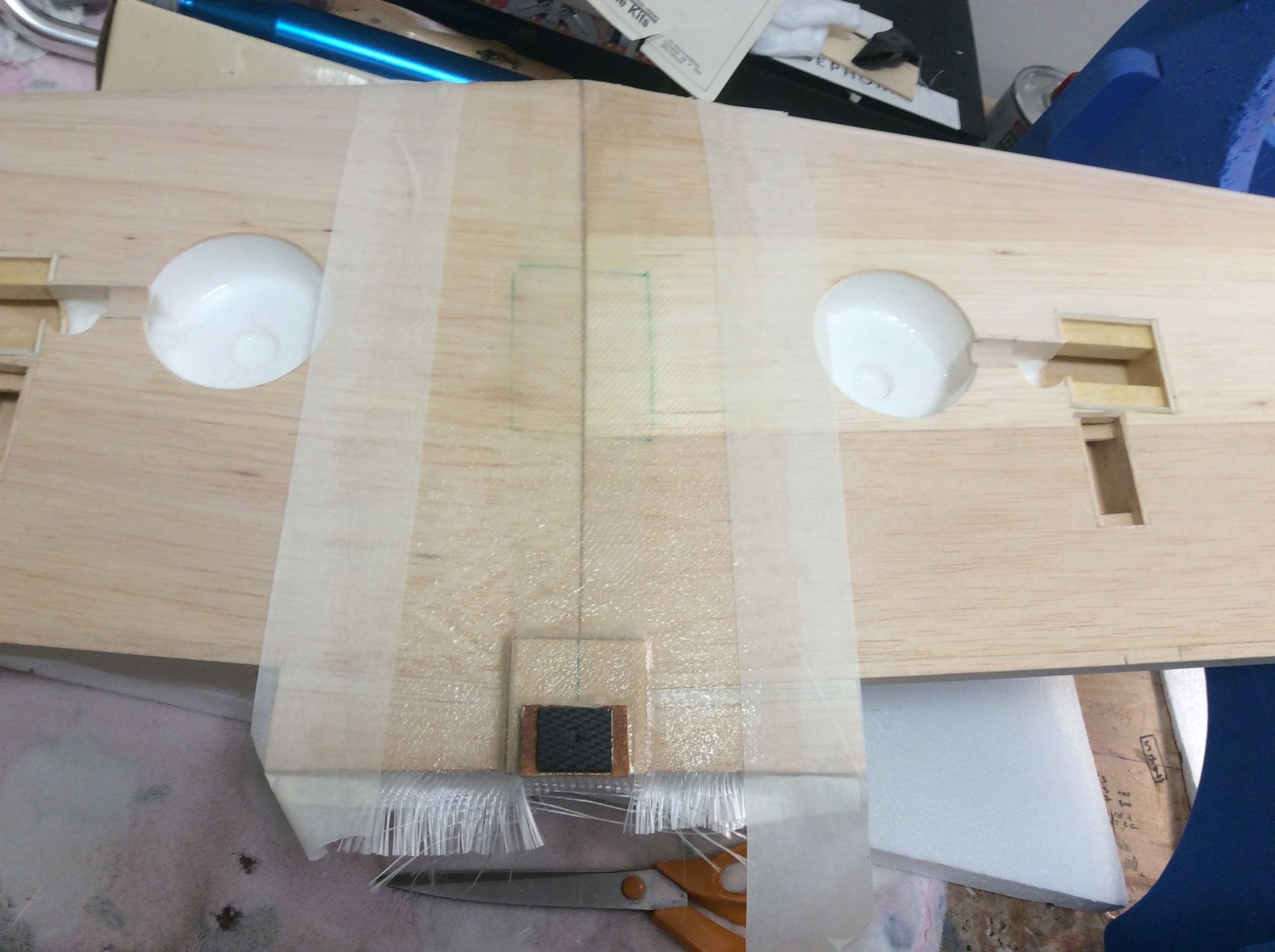

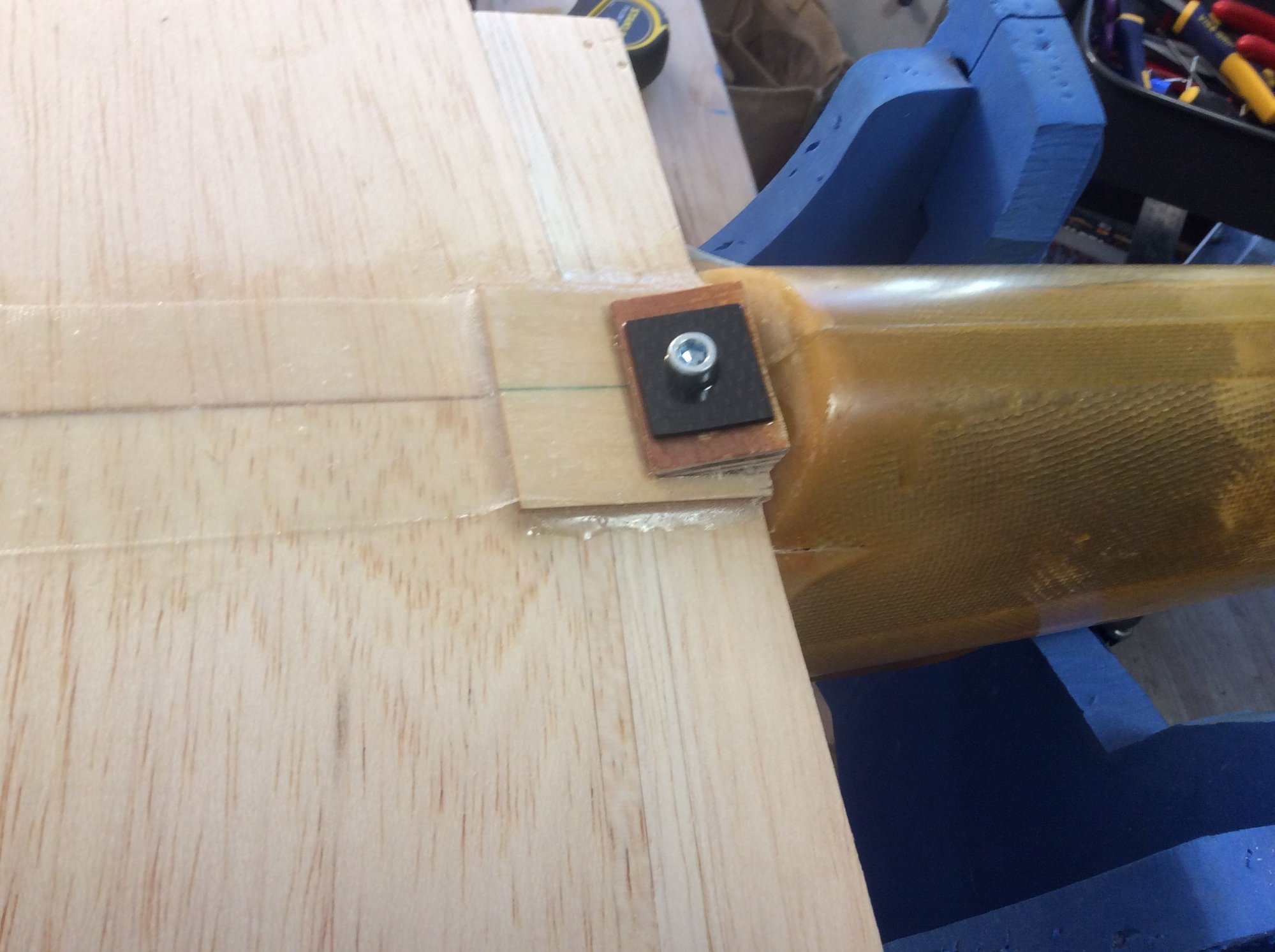

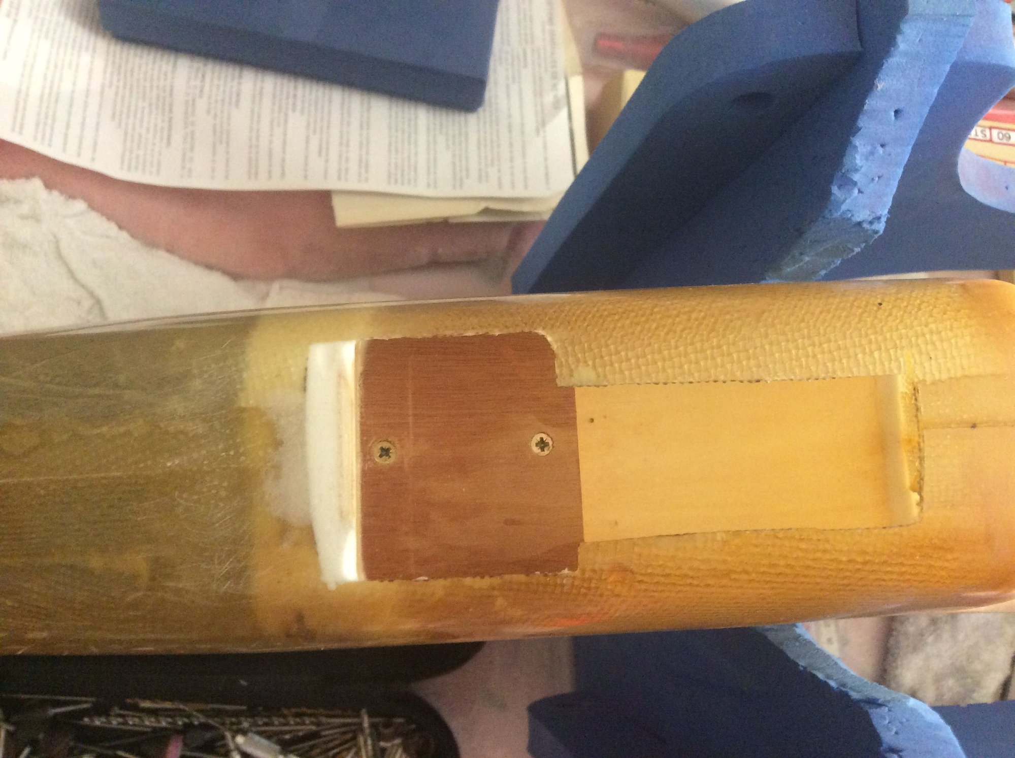

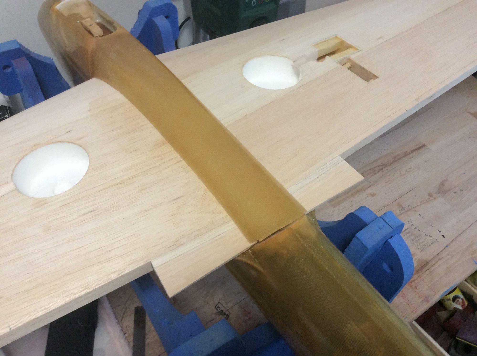

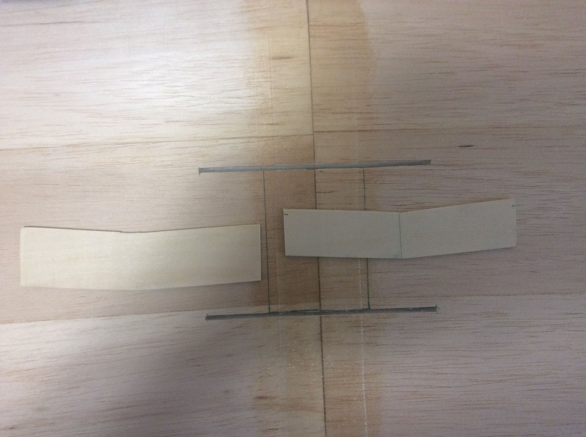

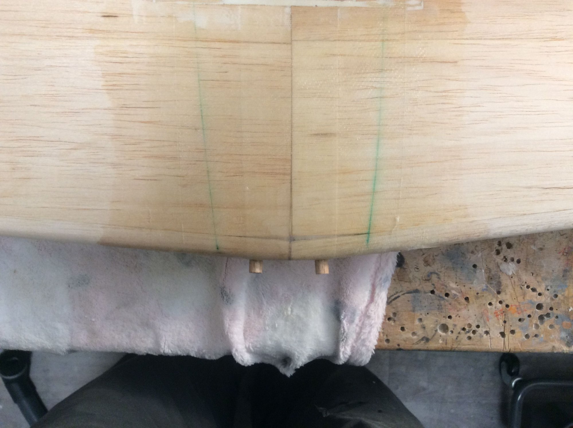

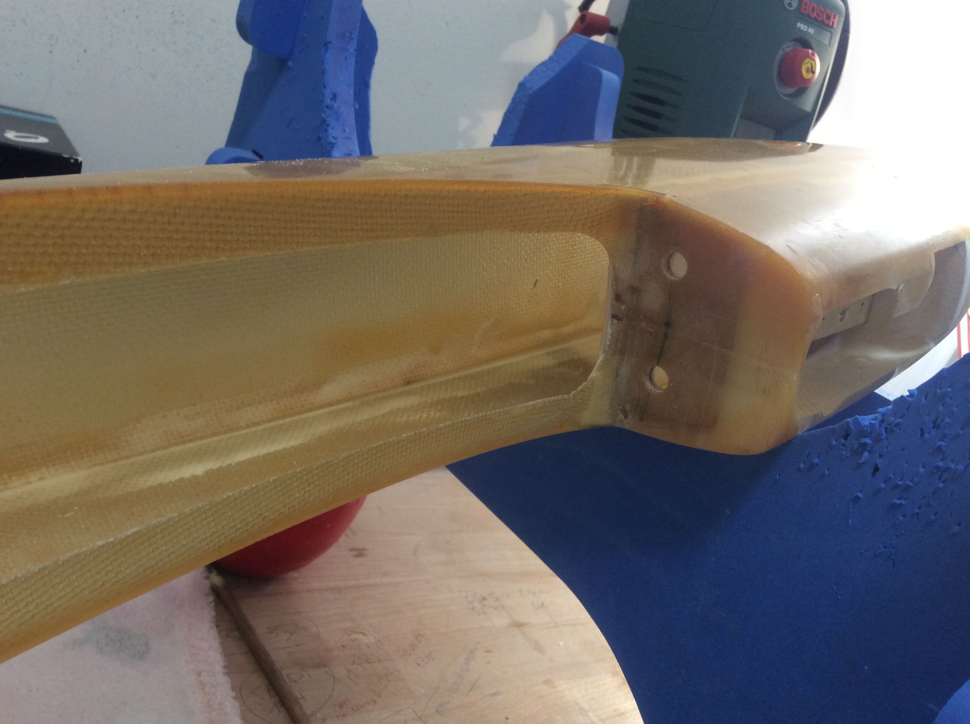

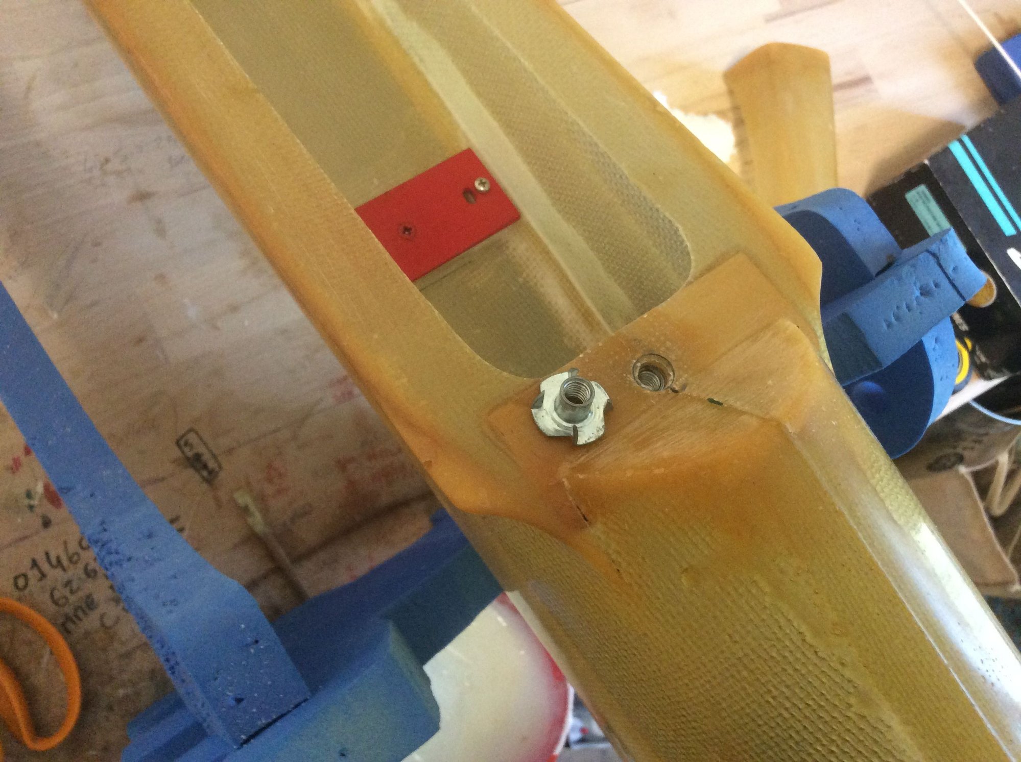

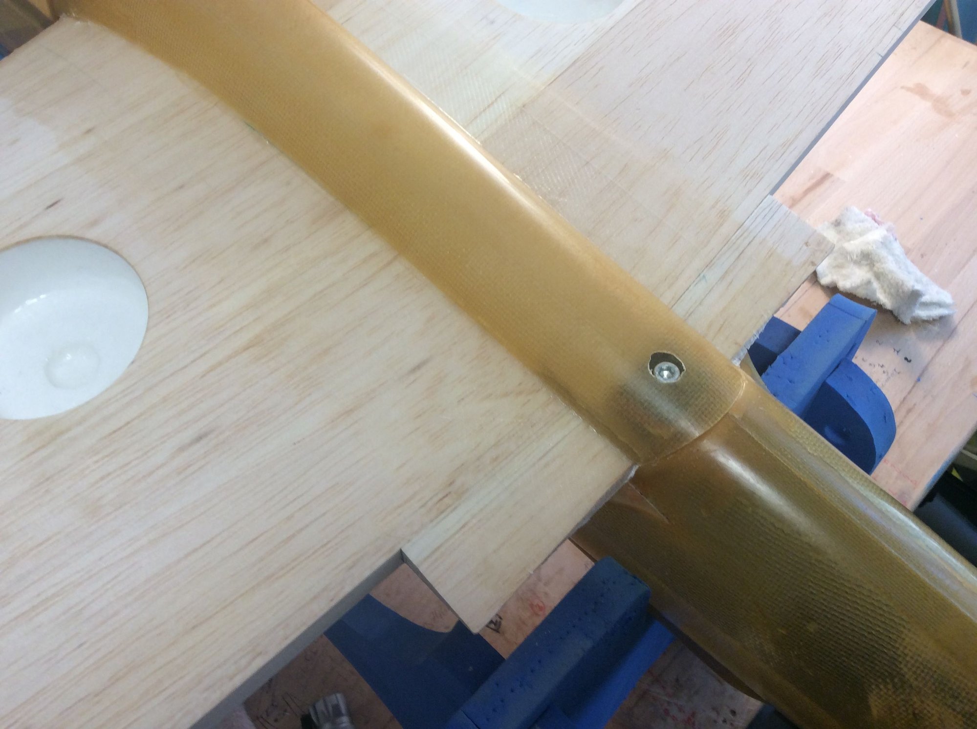

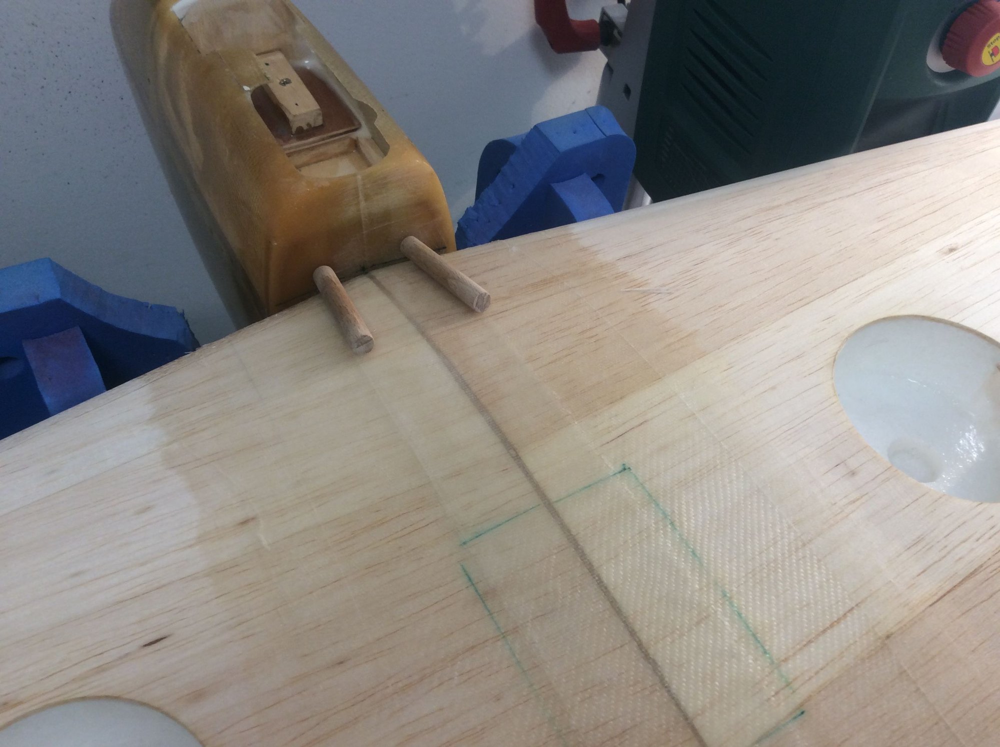

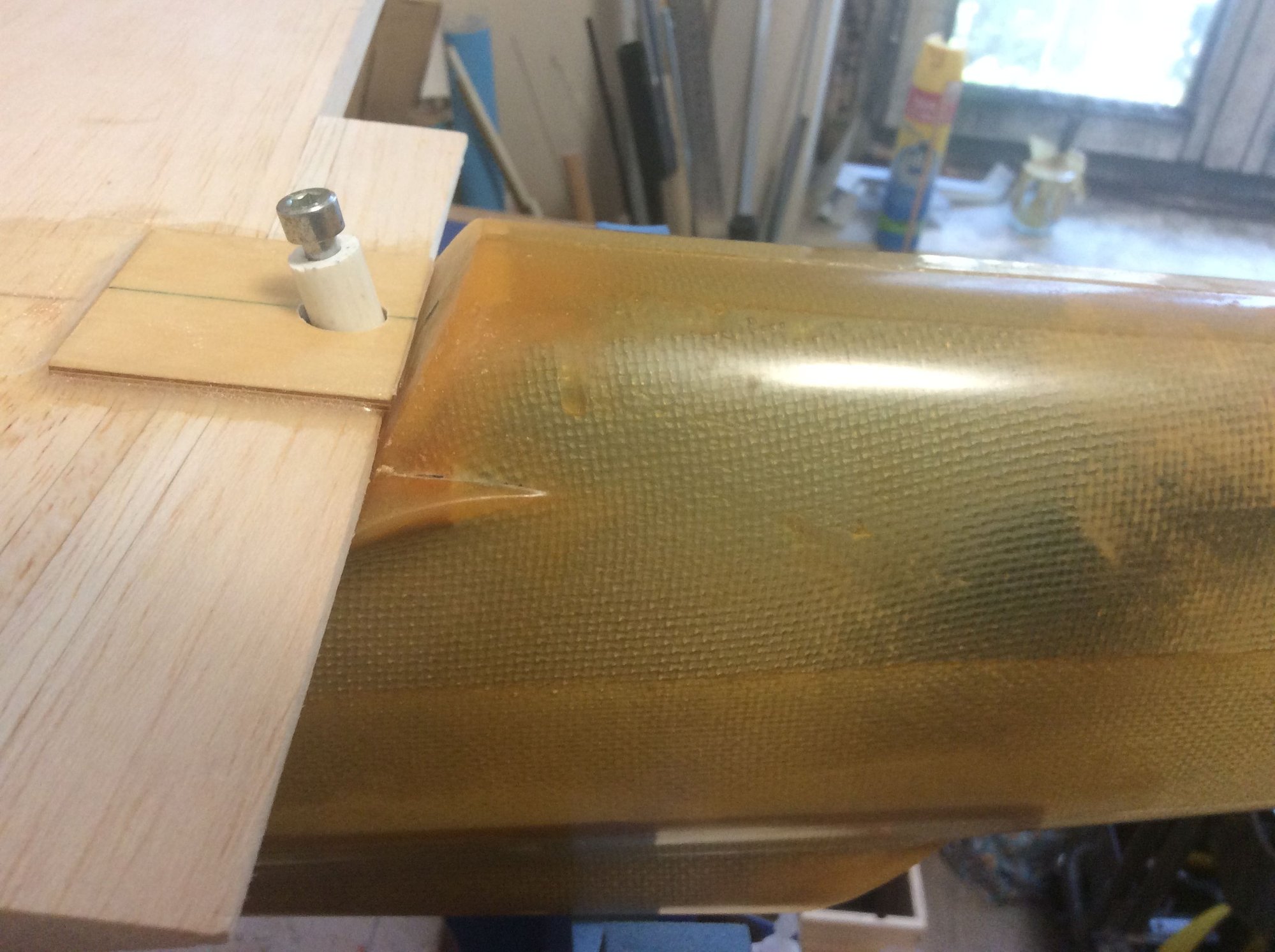

Reflection on the optimal fixation of the wing

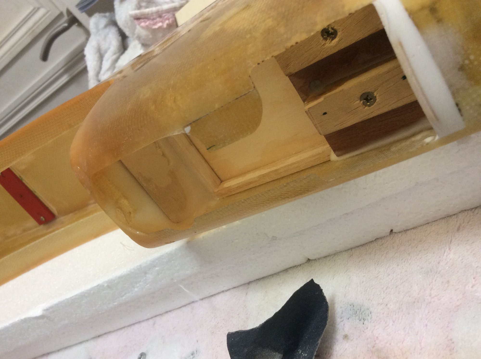

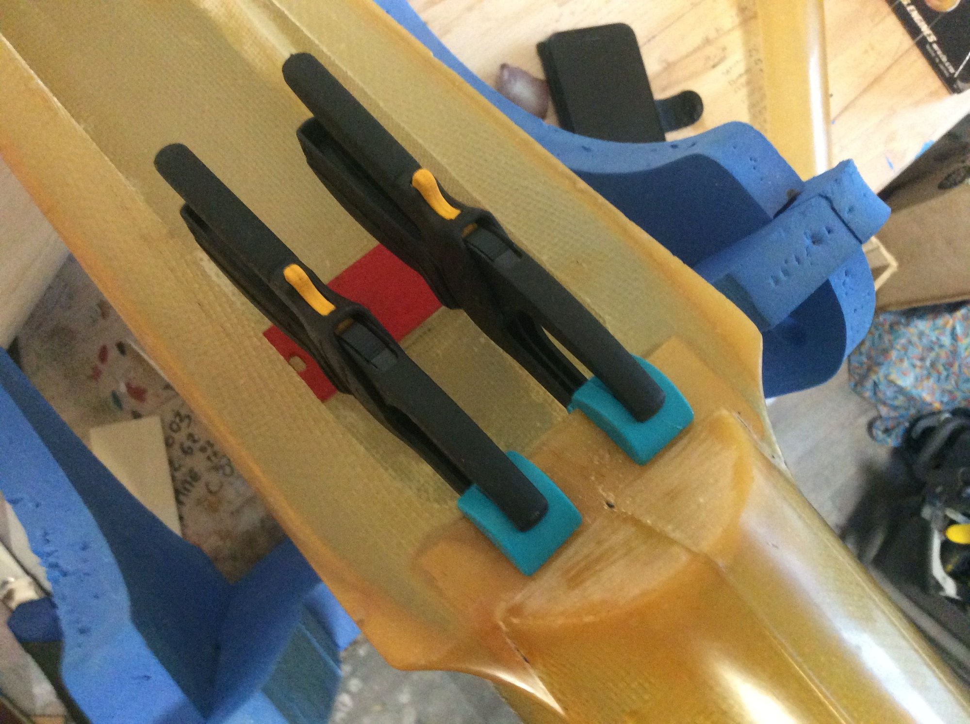

Hello Fred
What is it to protect foam ?
Old 05-04-2020 | 07:51 AM
  #42
Joined: Dec 2019
Posts: 109
Hello Claude
Epoxy resin 30 minutes and micro balloon.

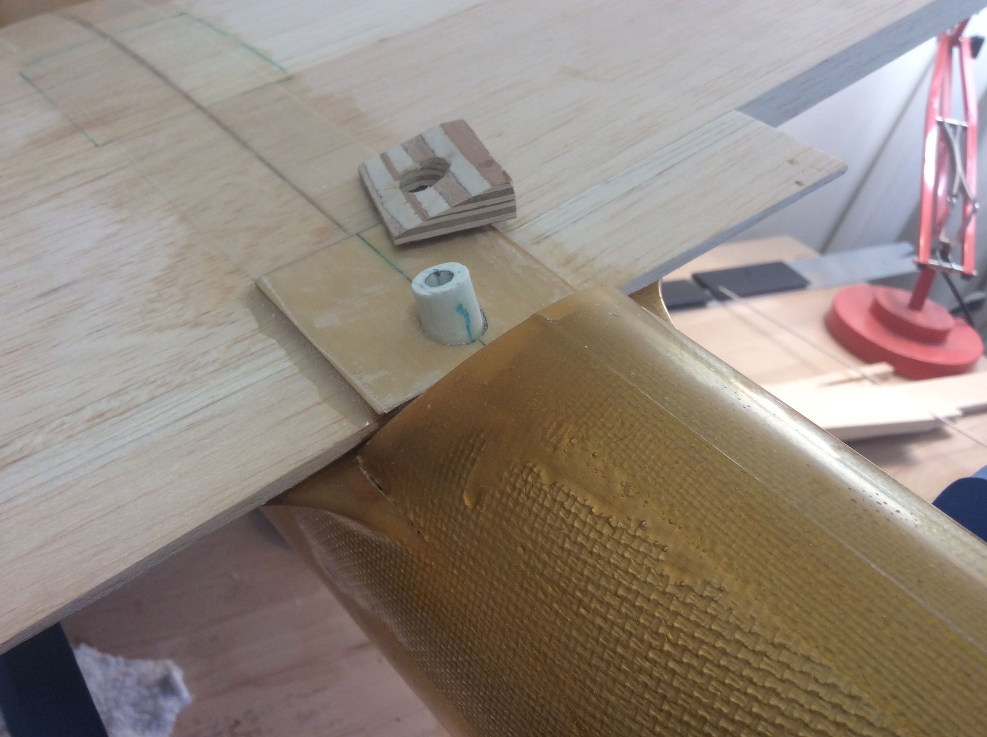

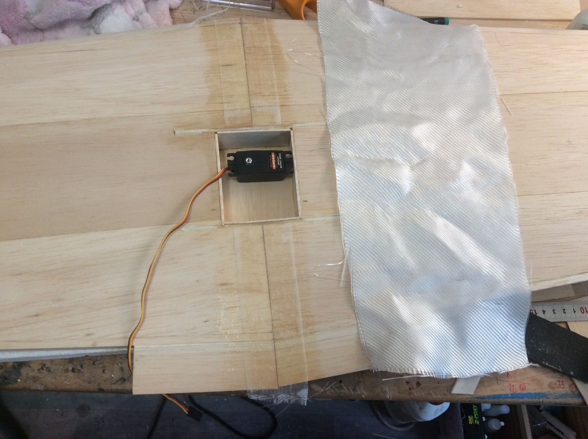

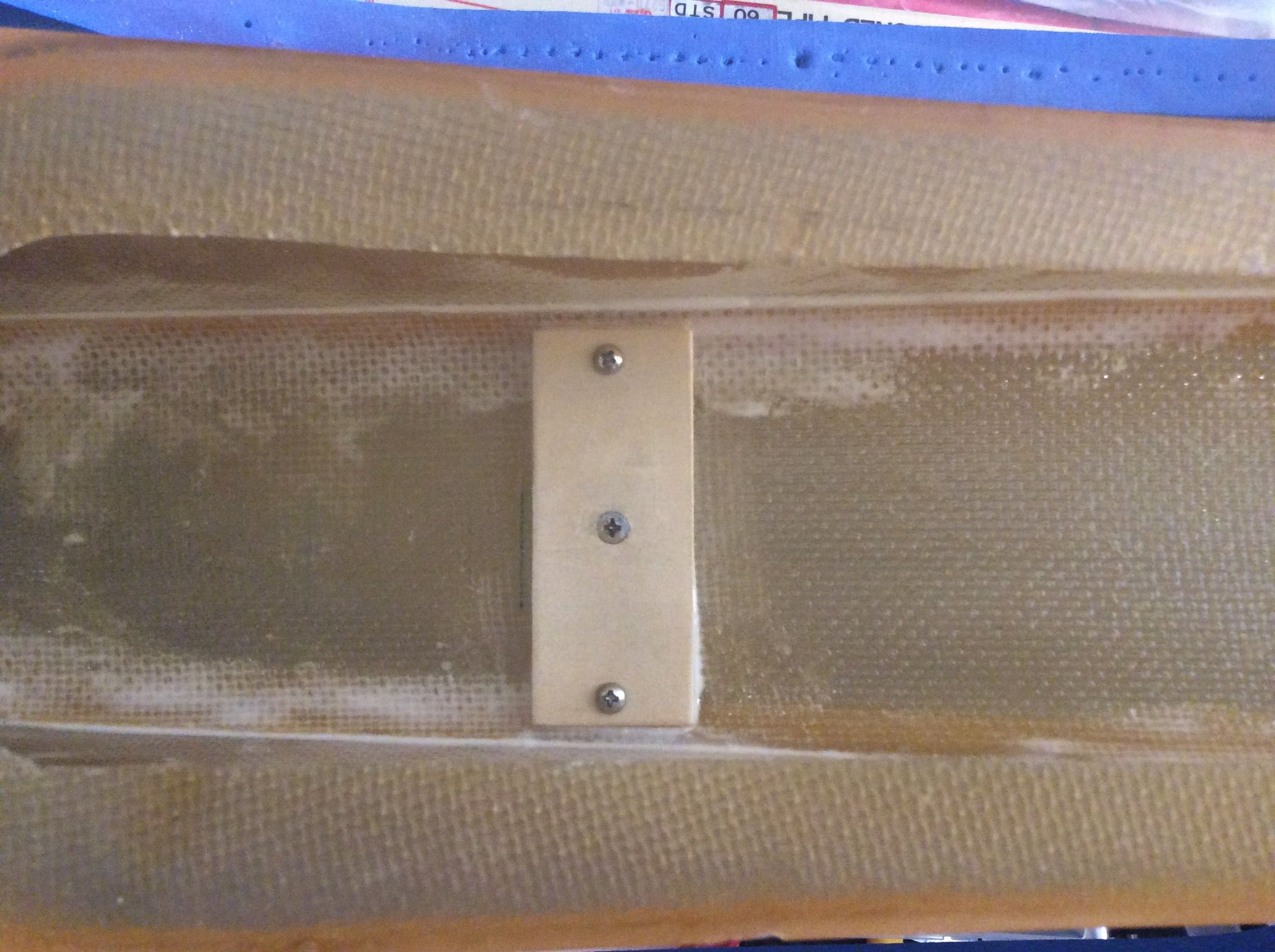

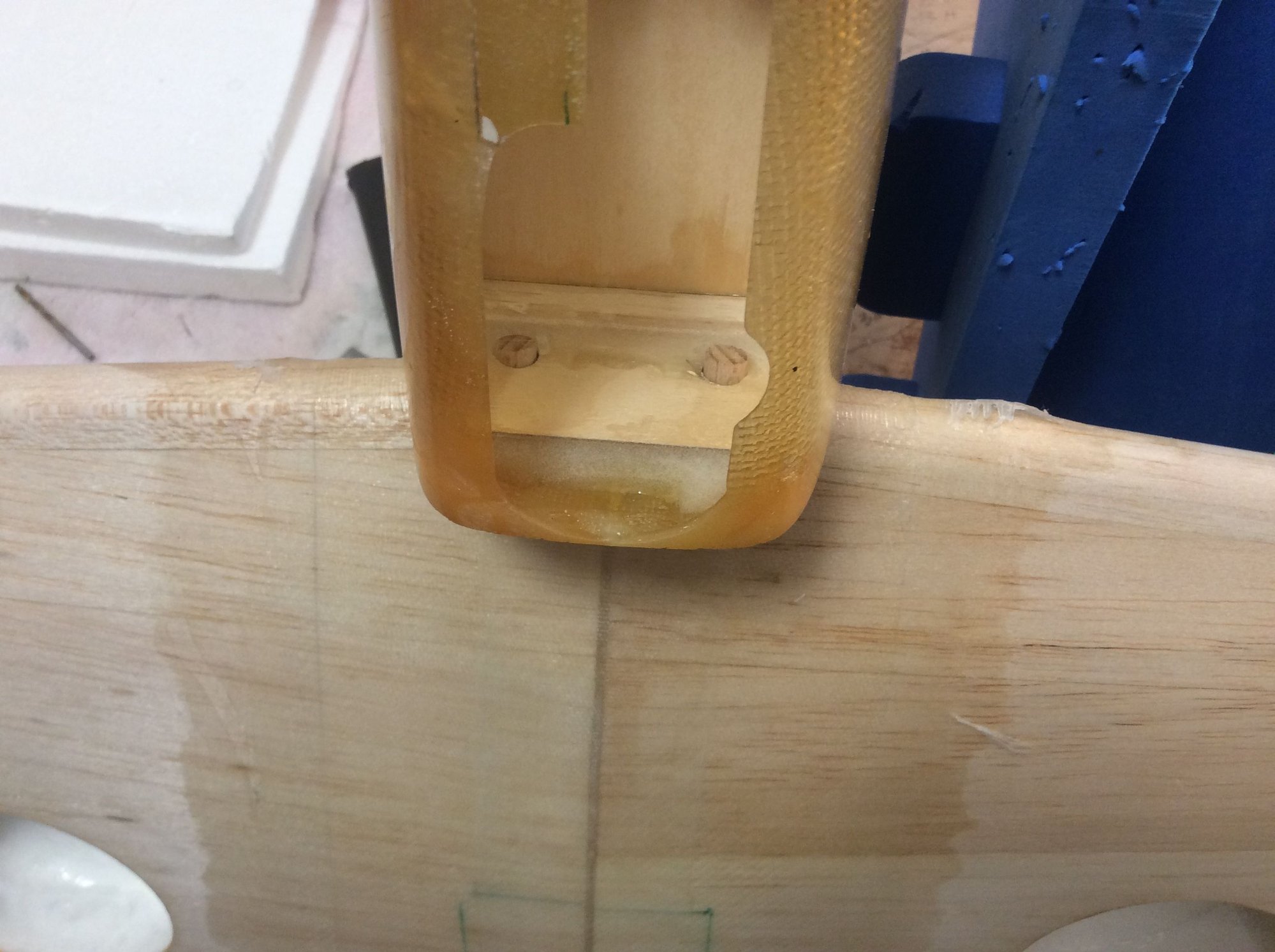

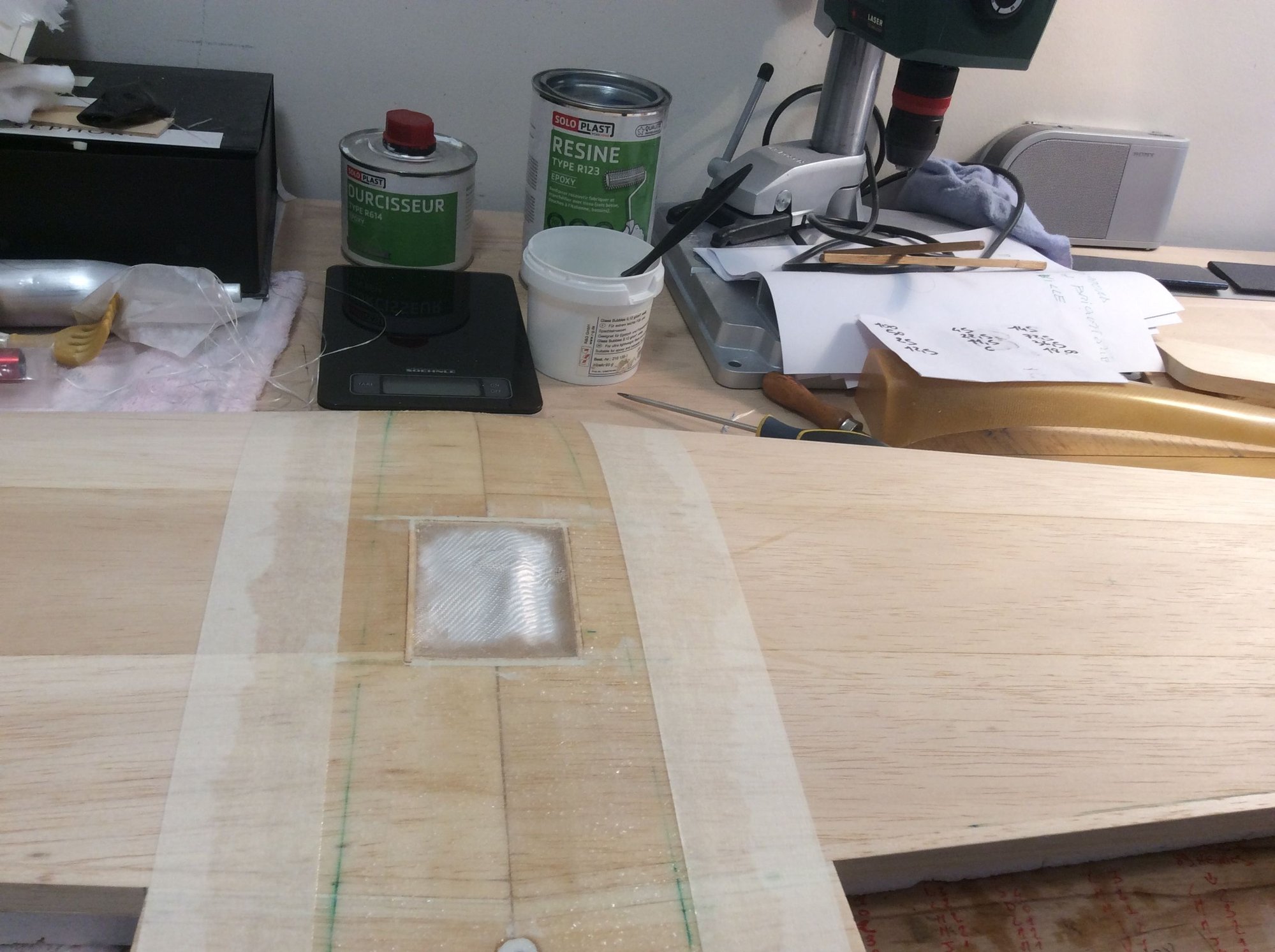

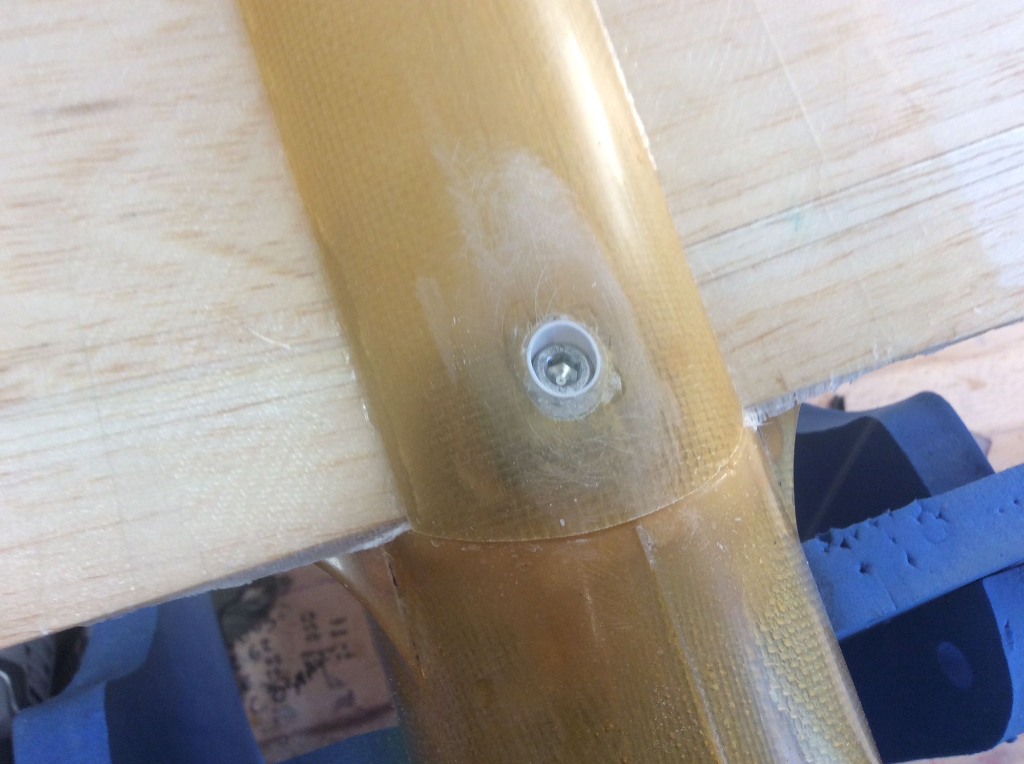

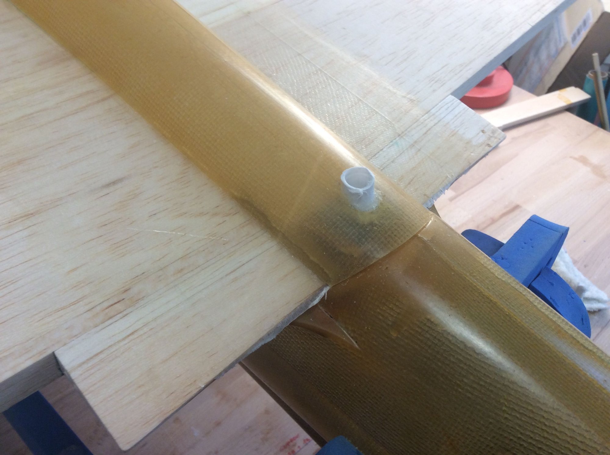

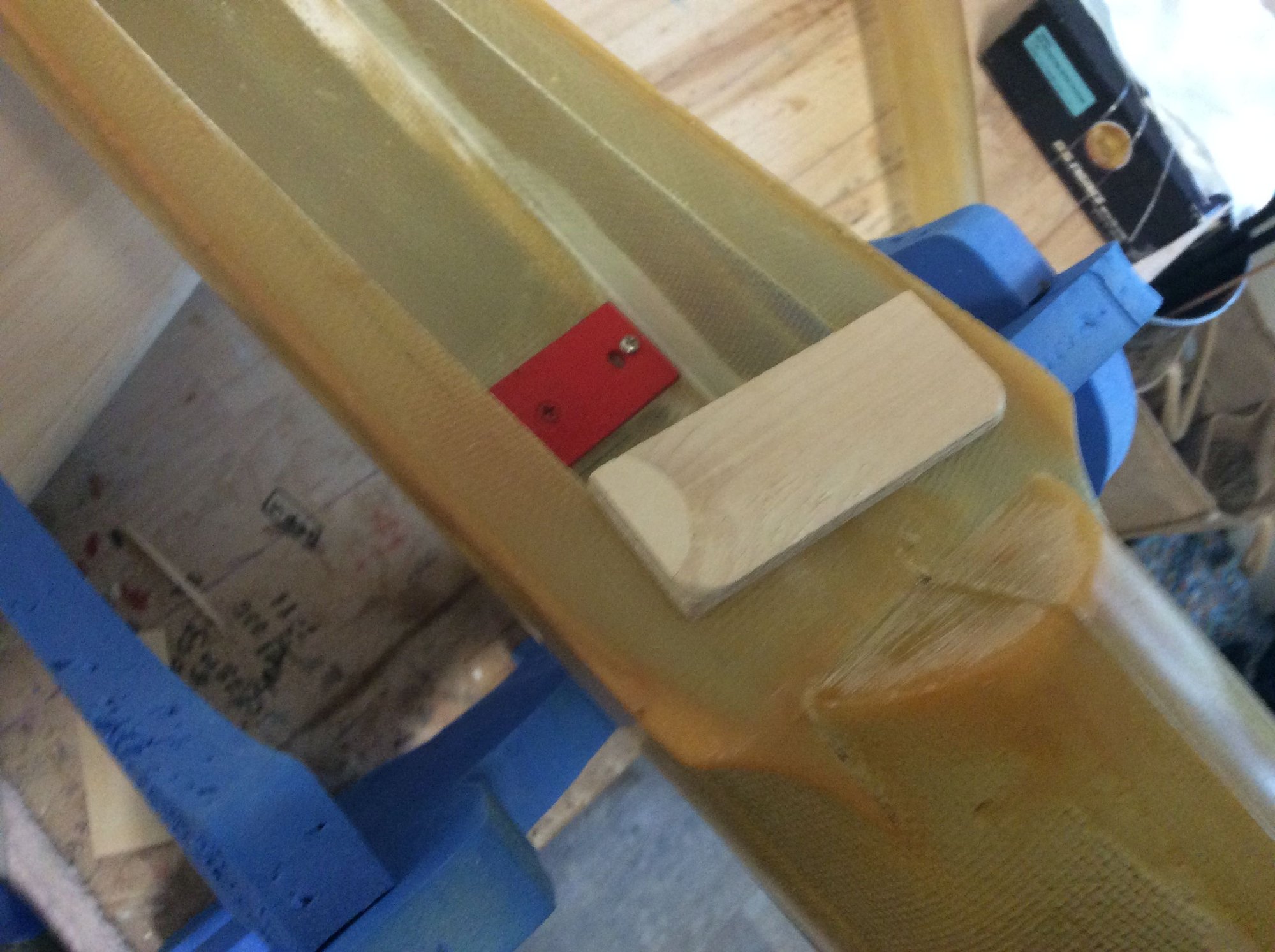

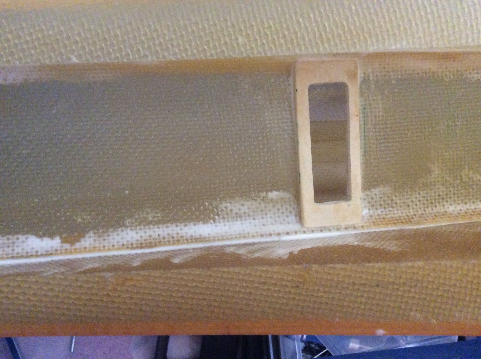

Hello Fred
Glasscloth width seems little !

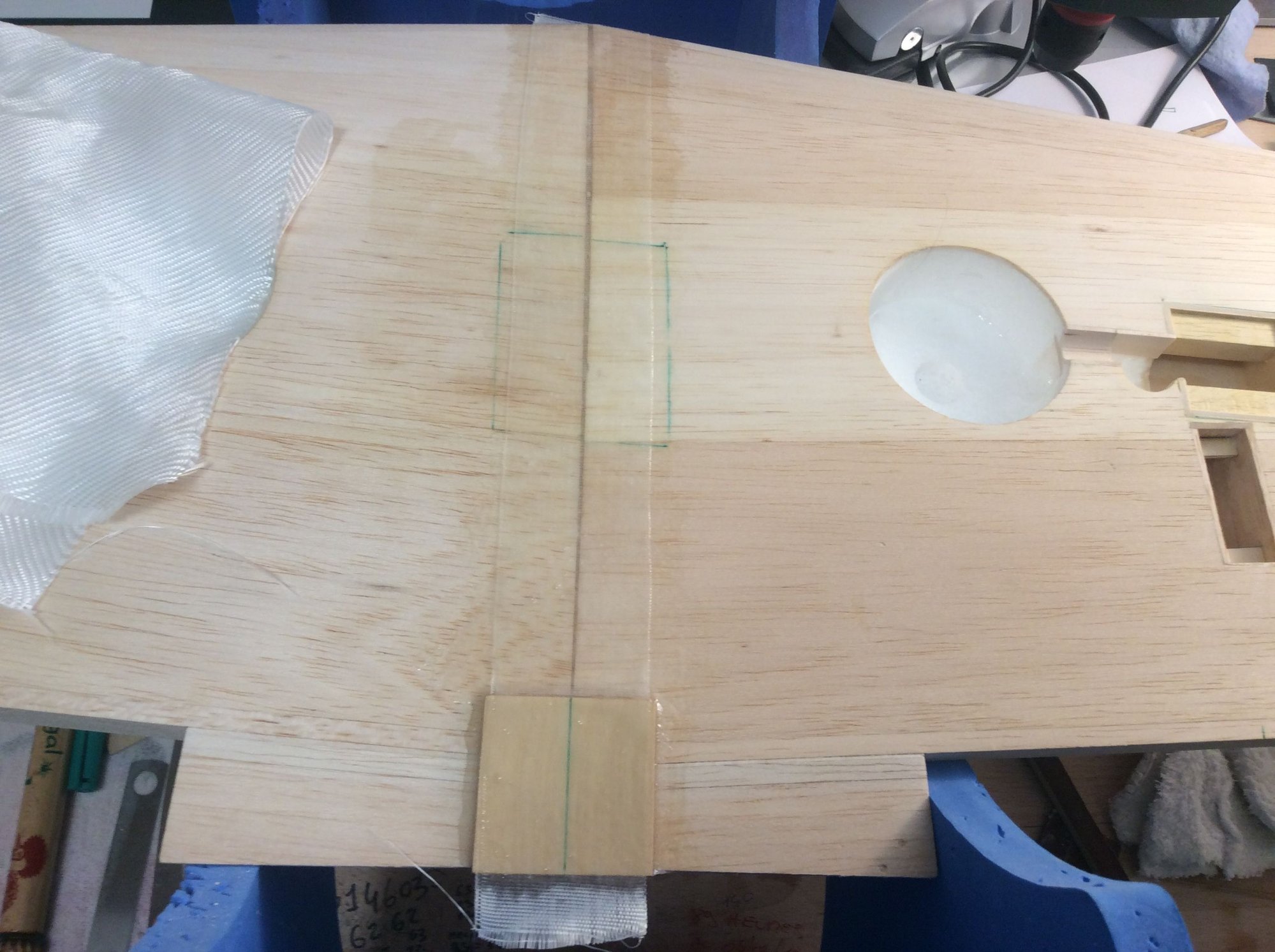

Which dimensions and grammage of glasscloth which connects the wings are ?
Old 05-07-2020 | 05:12 AM
  #48
Joined: Dec 2019
Posts: 109
Hi Claude.
Exactly, it is a first layer of glass fabric, I apply a second layer of 120 grams m2 by 20 cm wide.
These are the following photos.
Fred
