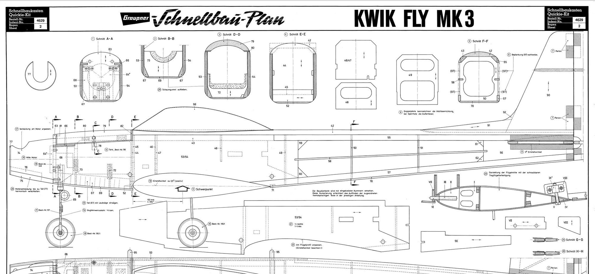

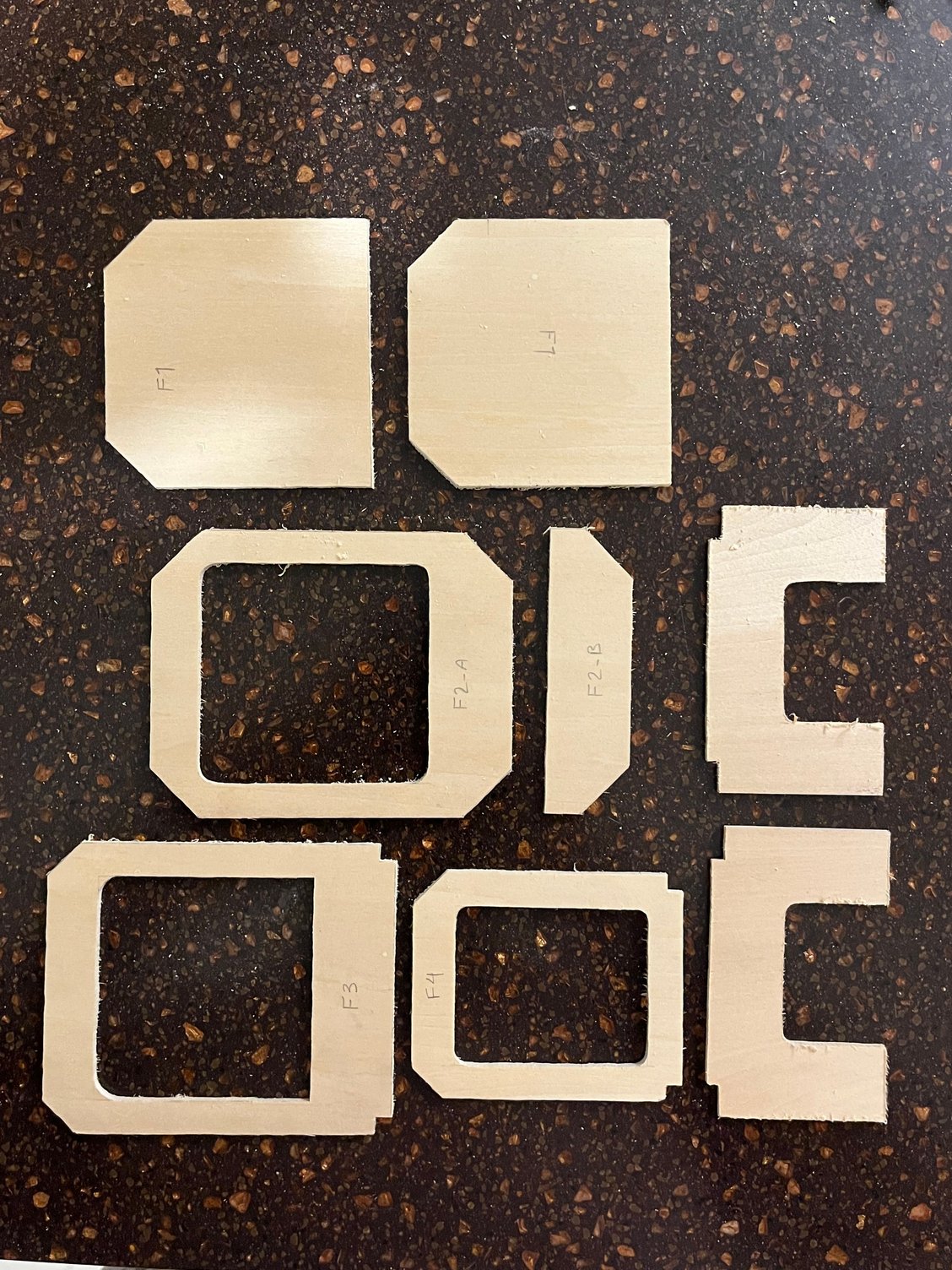

I will use Graupner Plans which are available for download from outerzone.co.uk
plans are very detailed, precise and from my point of view a little bit complicated.
so I will a some modifications to the internal structure with respect to the outer shape of the plane.
In other words I will simplify the structure.

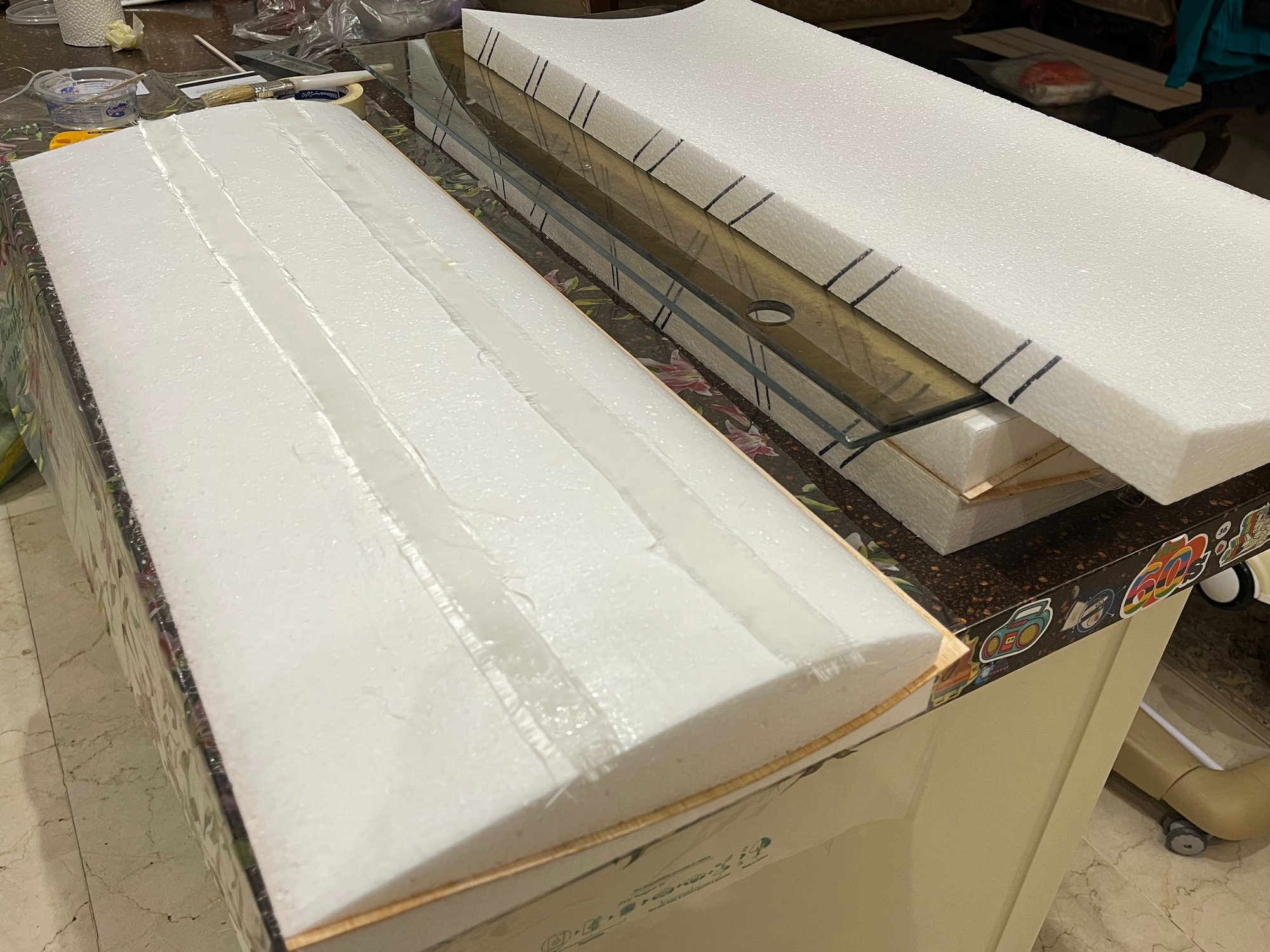

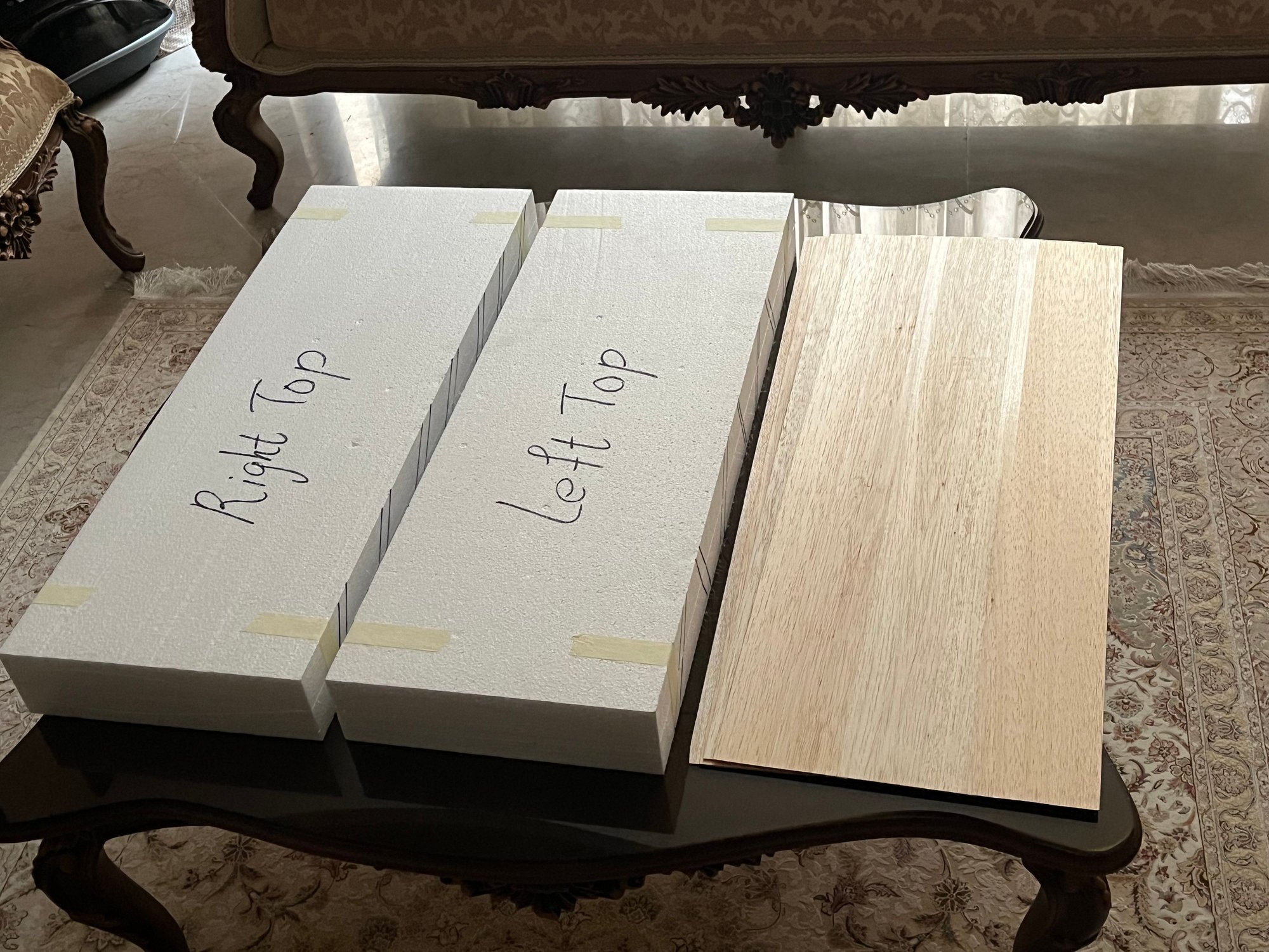

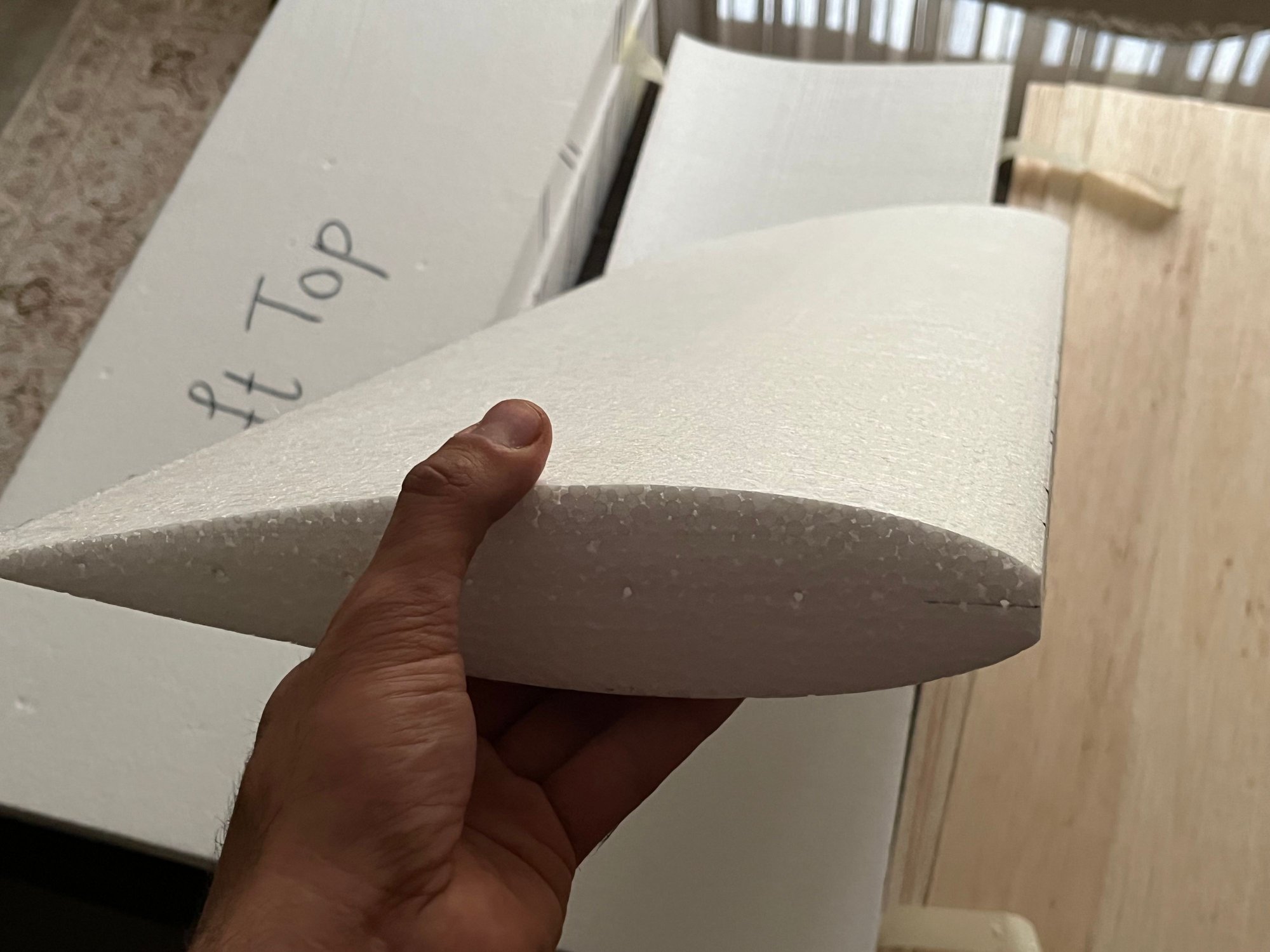

by the way as all my projects I will go for a foam core wing.

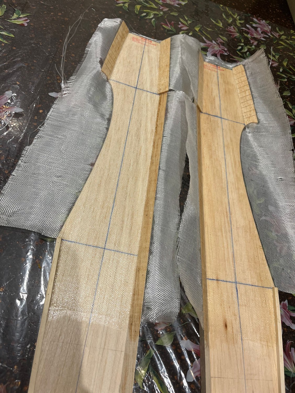

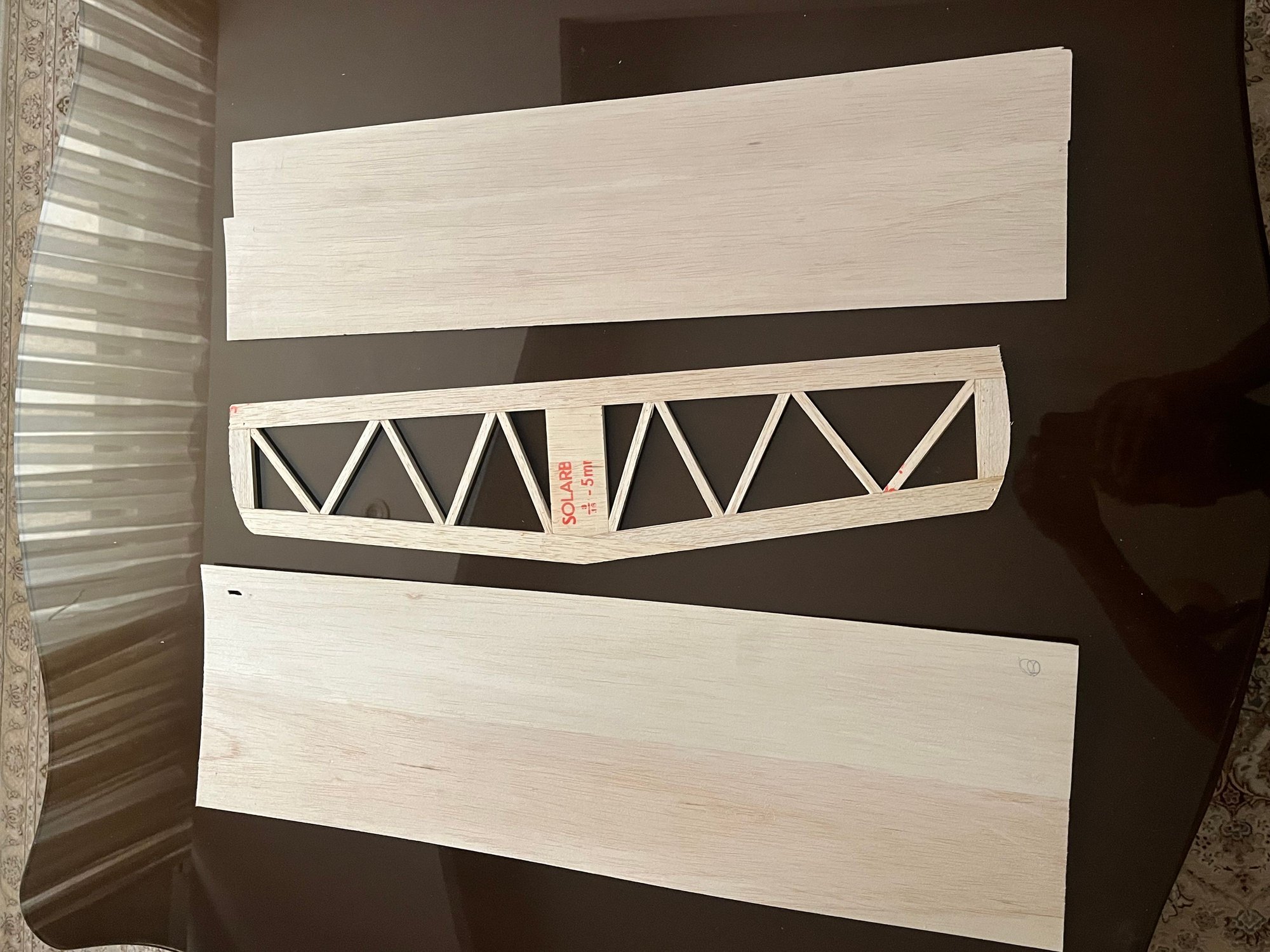

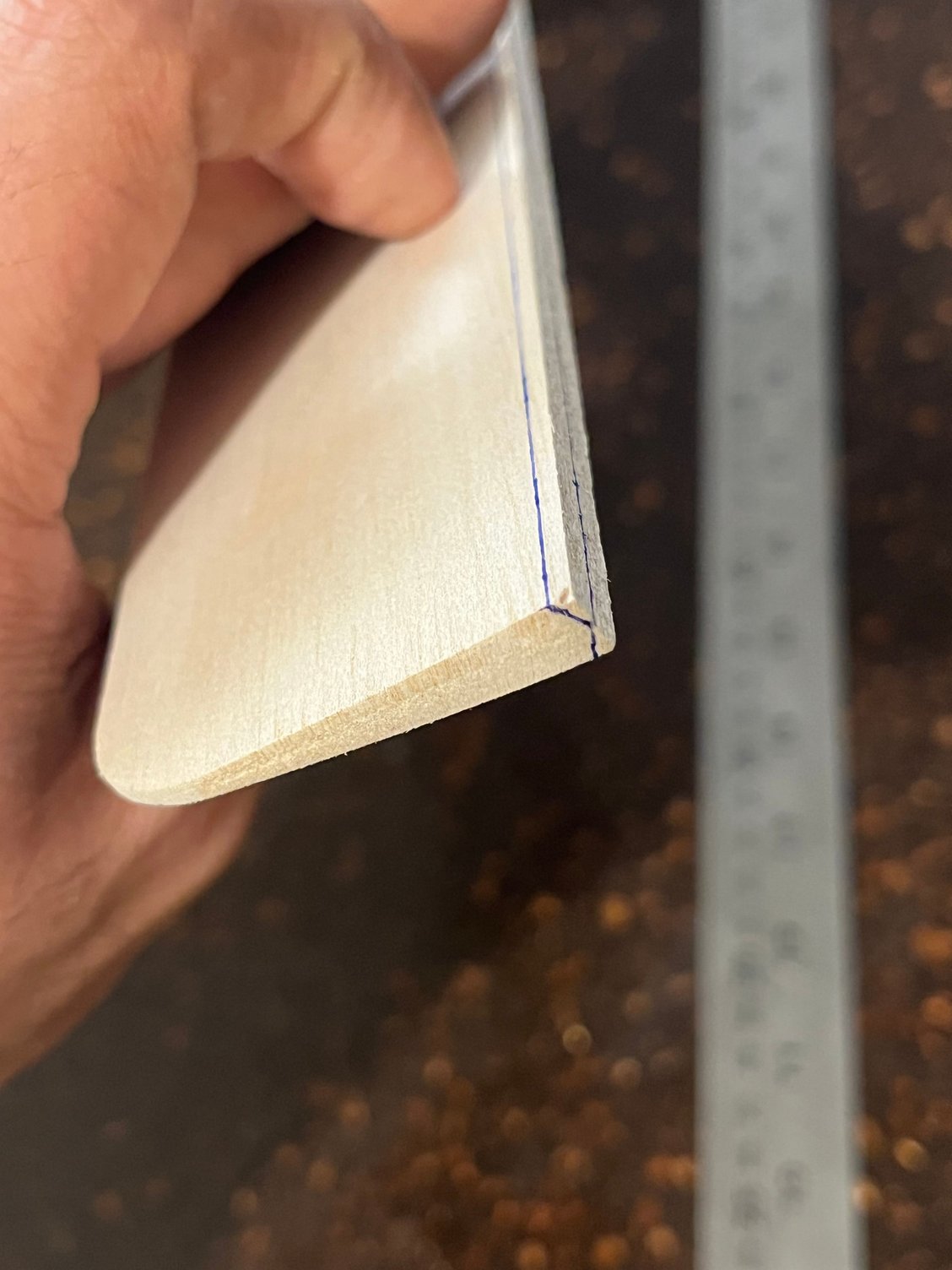

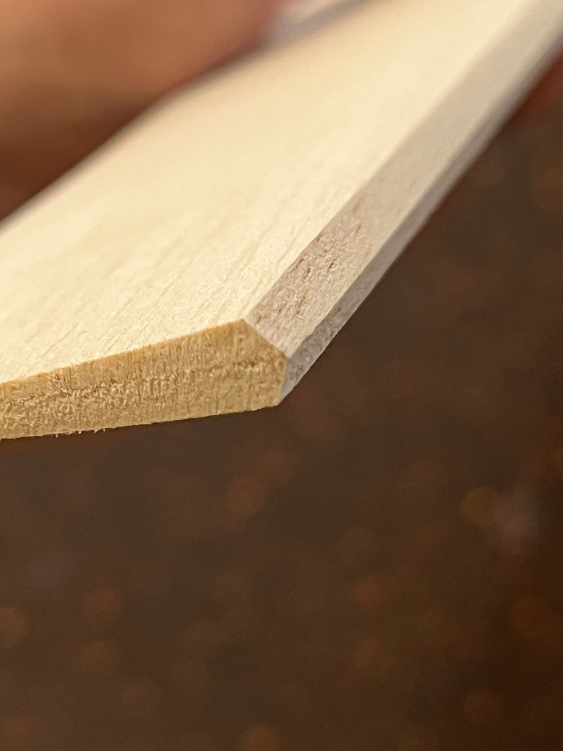

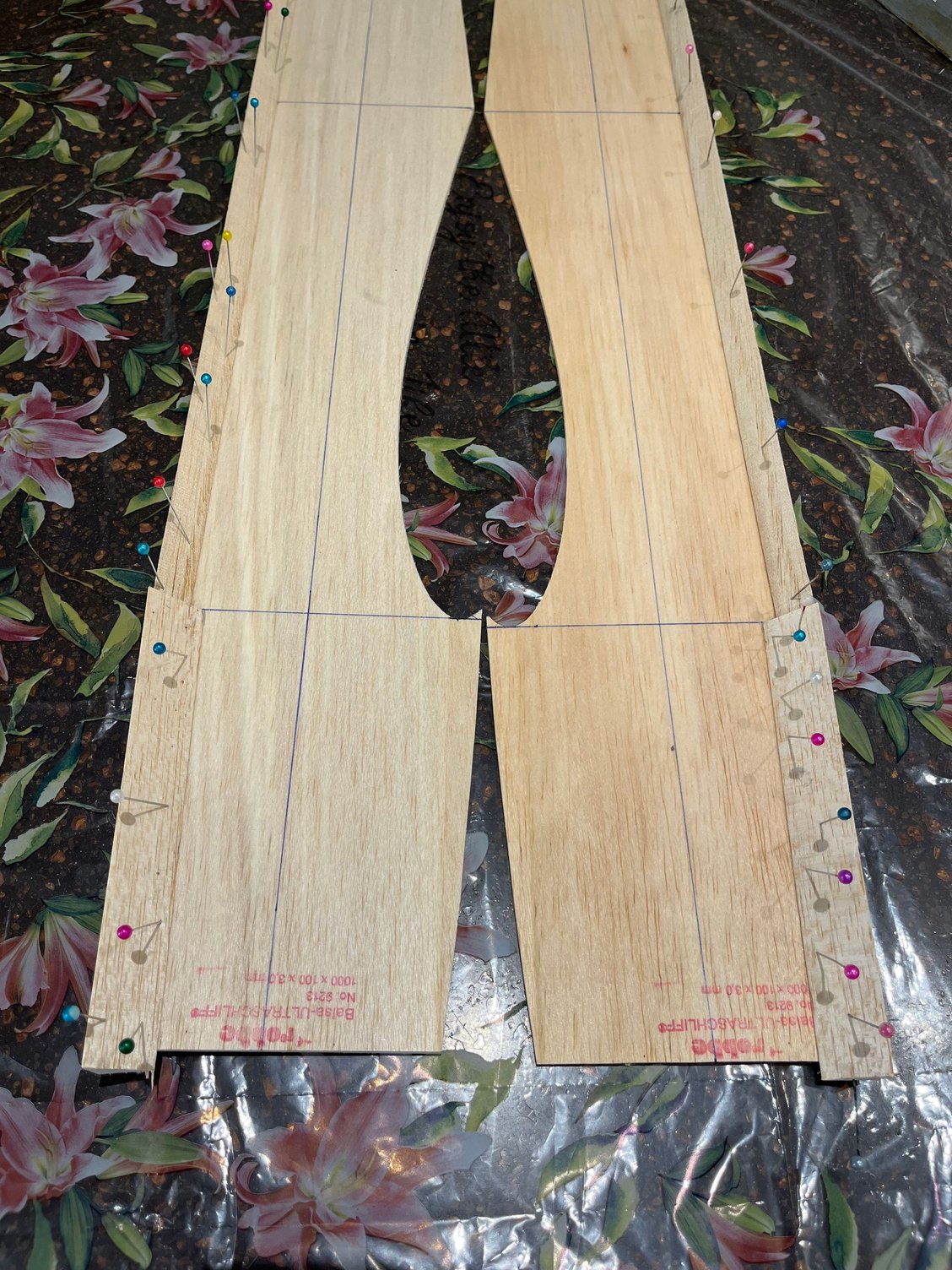

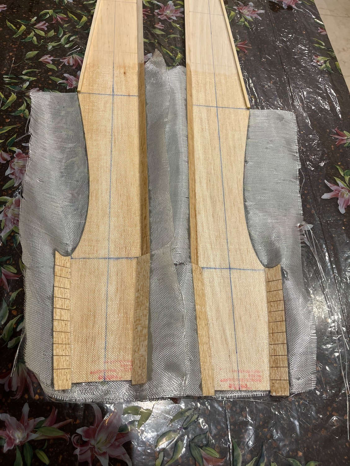

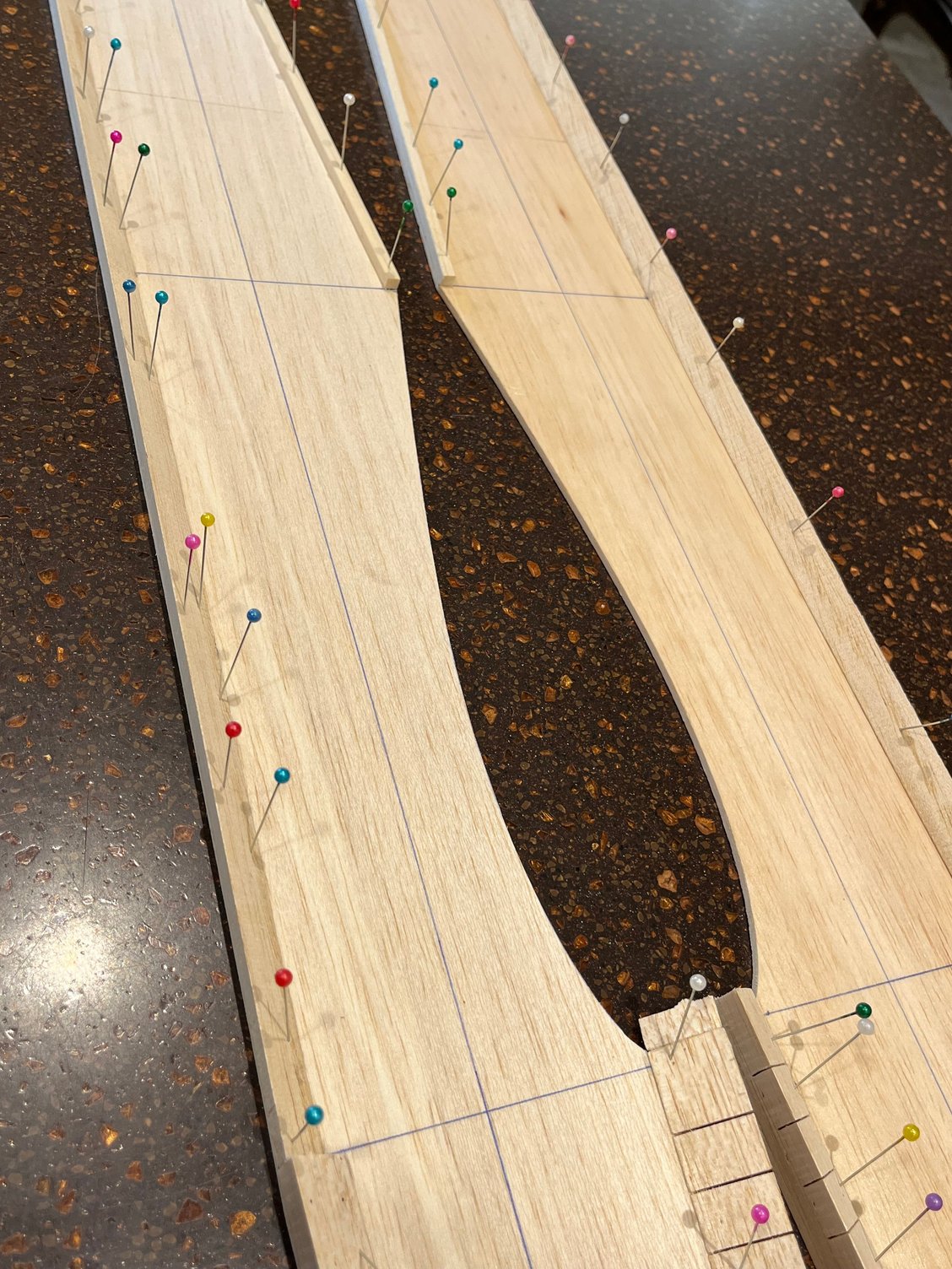

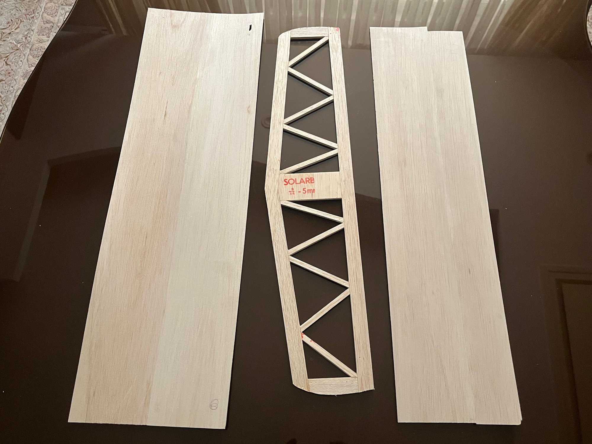

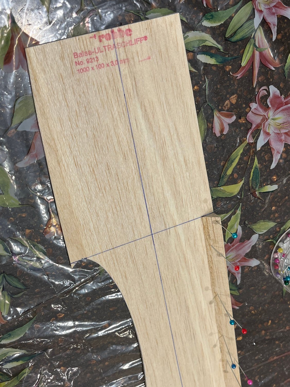

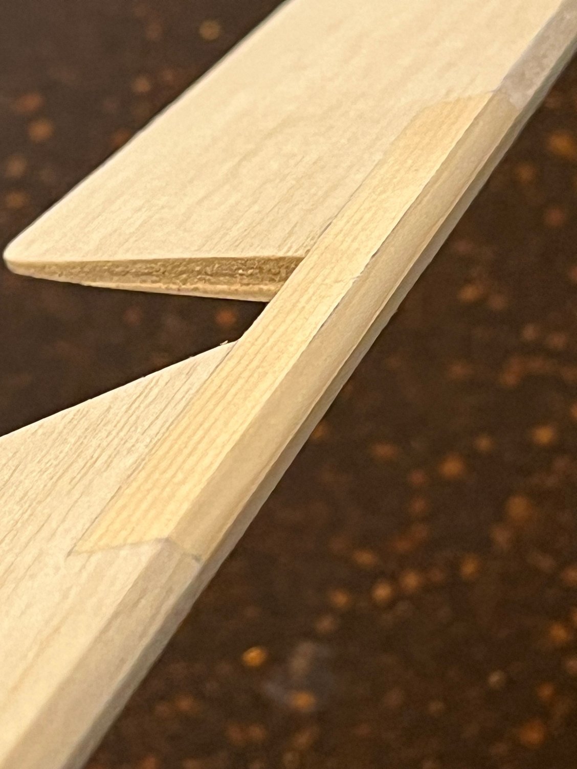

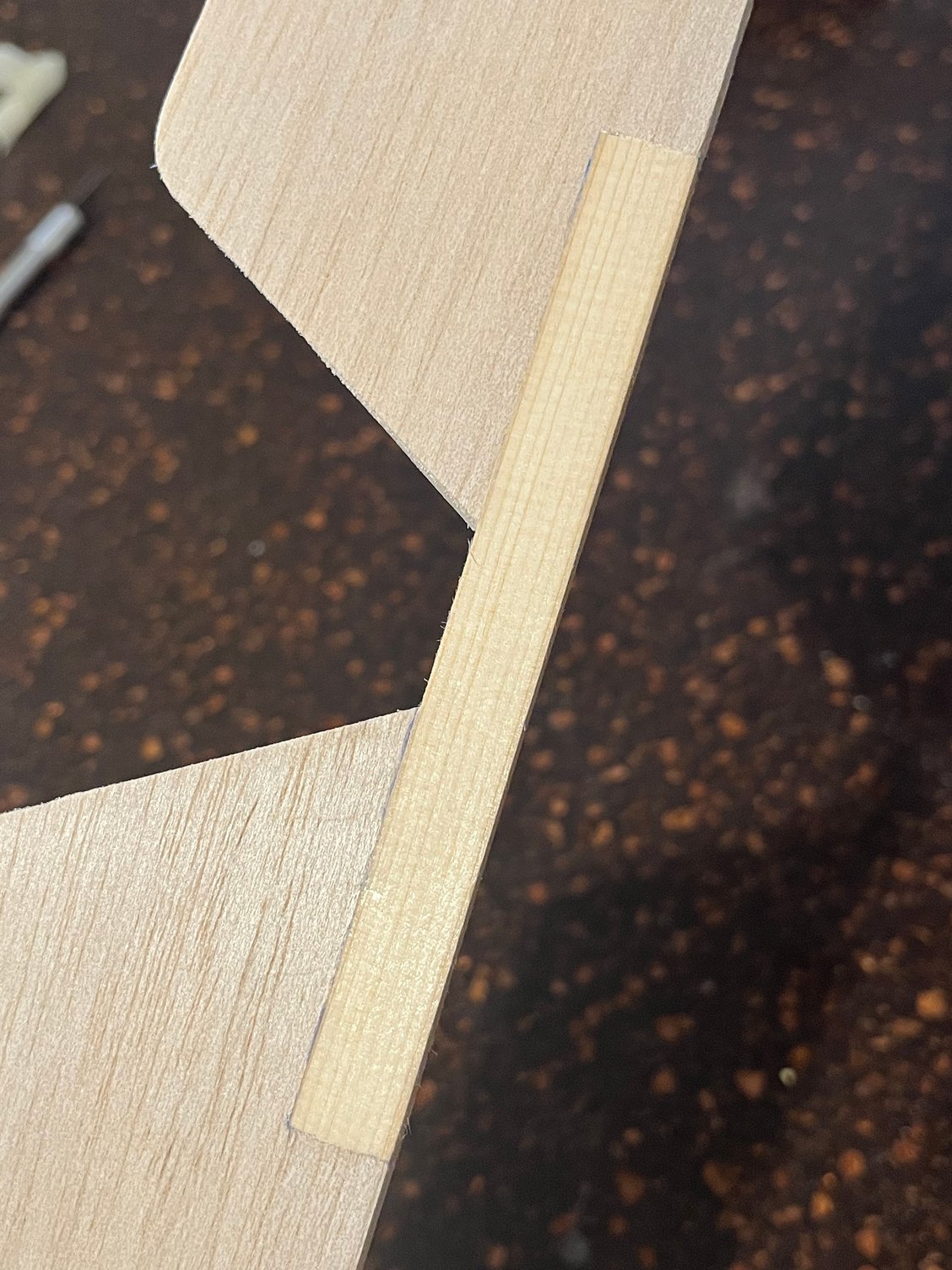

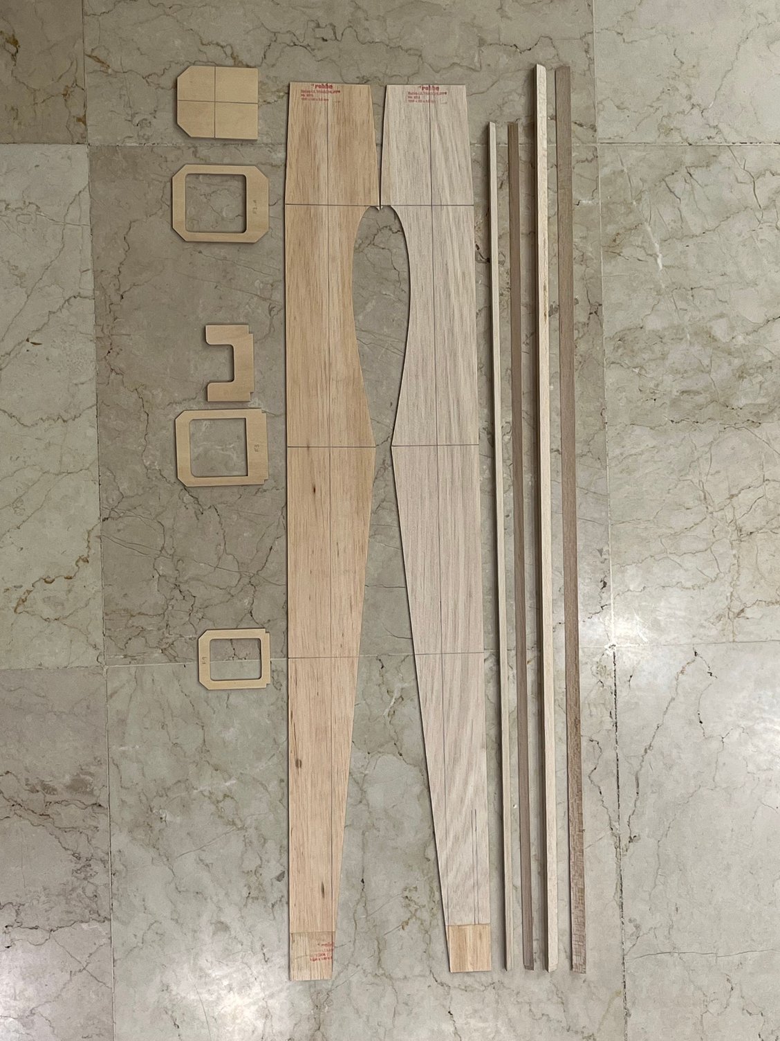

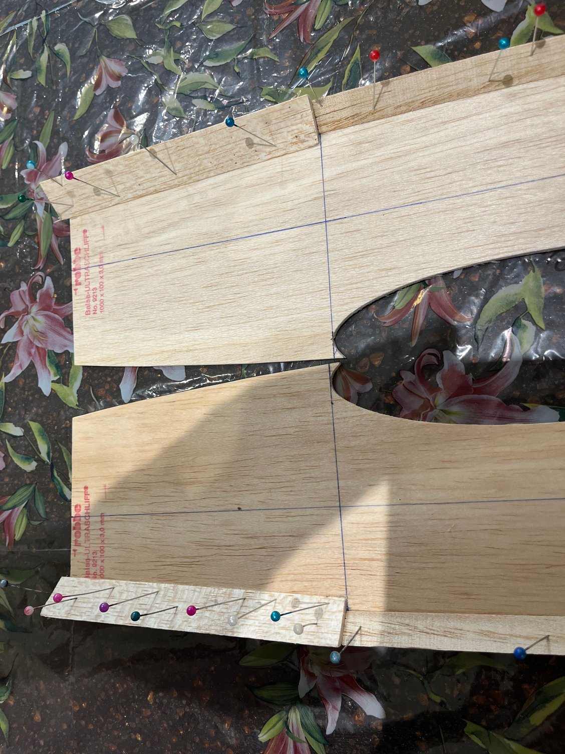

[img alt="Fuselage sides are made of 2 ply of 2.5mm (3/32”) balsa reinforced with a 0.8mm (1/32”) plywood.
There are also open bays in the back which looks to be a little weak.
I will use one piece 3mm (1/8”) balsa sides that are reinforced with a layer of 100 grams glass cloth.
So the thickness of the sides will be less than the plan. This means that the formers should be a little wider compared to the plans to save the outer width of the fuselage.
"]https://cimg2.ibsrv.net/gimg/www.rcuniverse.com-vbulletin/2000x922/img_4130_d31b99722989f996503c96310fc4e375f4c3cdec. jpeg[/img]
Fuselage sides are made of 2 ply of 2.5mm (3/32”) balsa reinforced with a 0.8mm (1/32”) plywood. There are also open bays in the back which looks to be a little weak. I will use one piece 3mm (1/8”) balsa sides that are reinforced with a layer of 100 grams glass cloth. So the thickness of the sides will be less than the plan. This means that the formers should be a little wider compared to the plans to save the outer width of the fuselage.

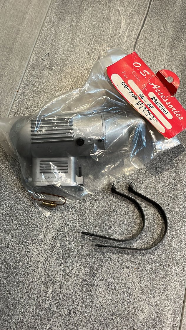

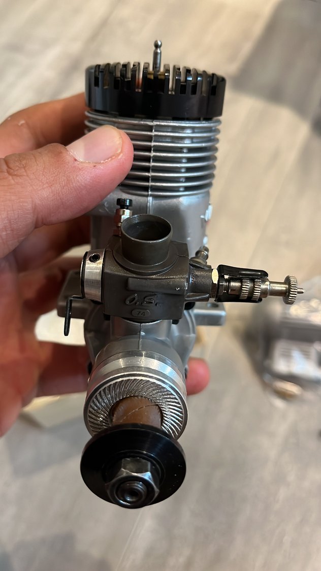

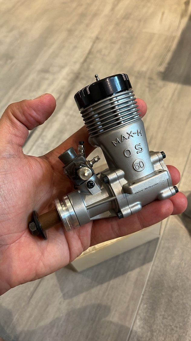

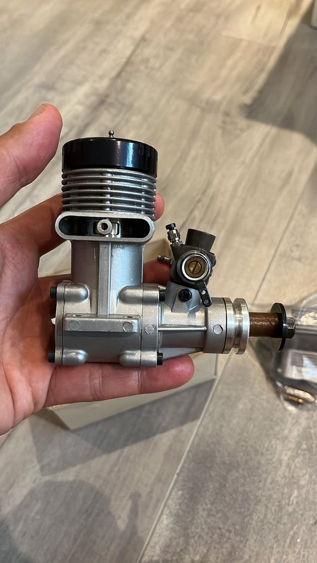

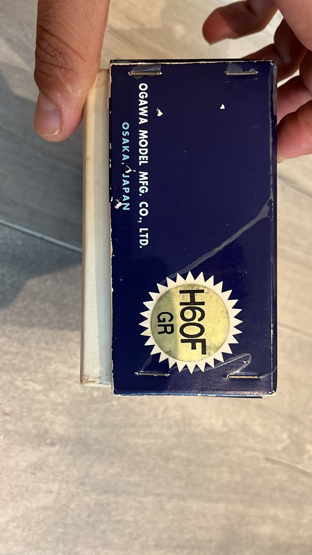

The engine will be exactly the one in the Graupner 1978 catalog, an OS max H60F GR black head.
Was so lucky to find a NIB one with muffler from ebay last year.

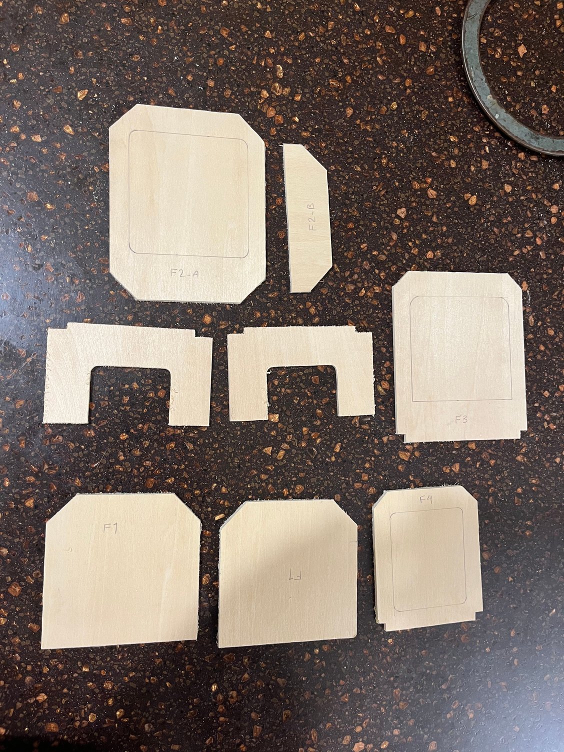

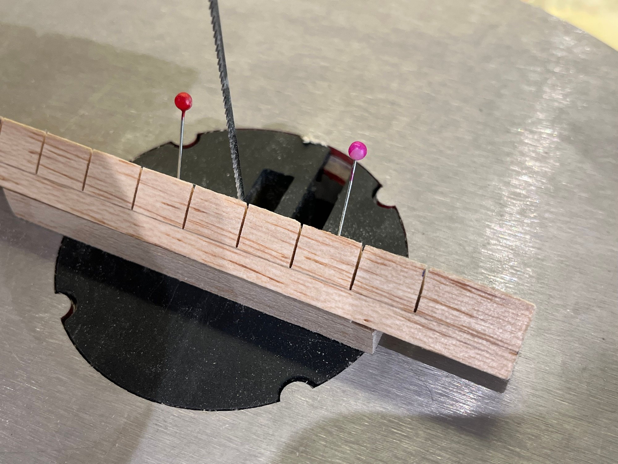

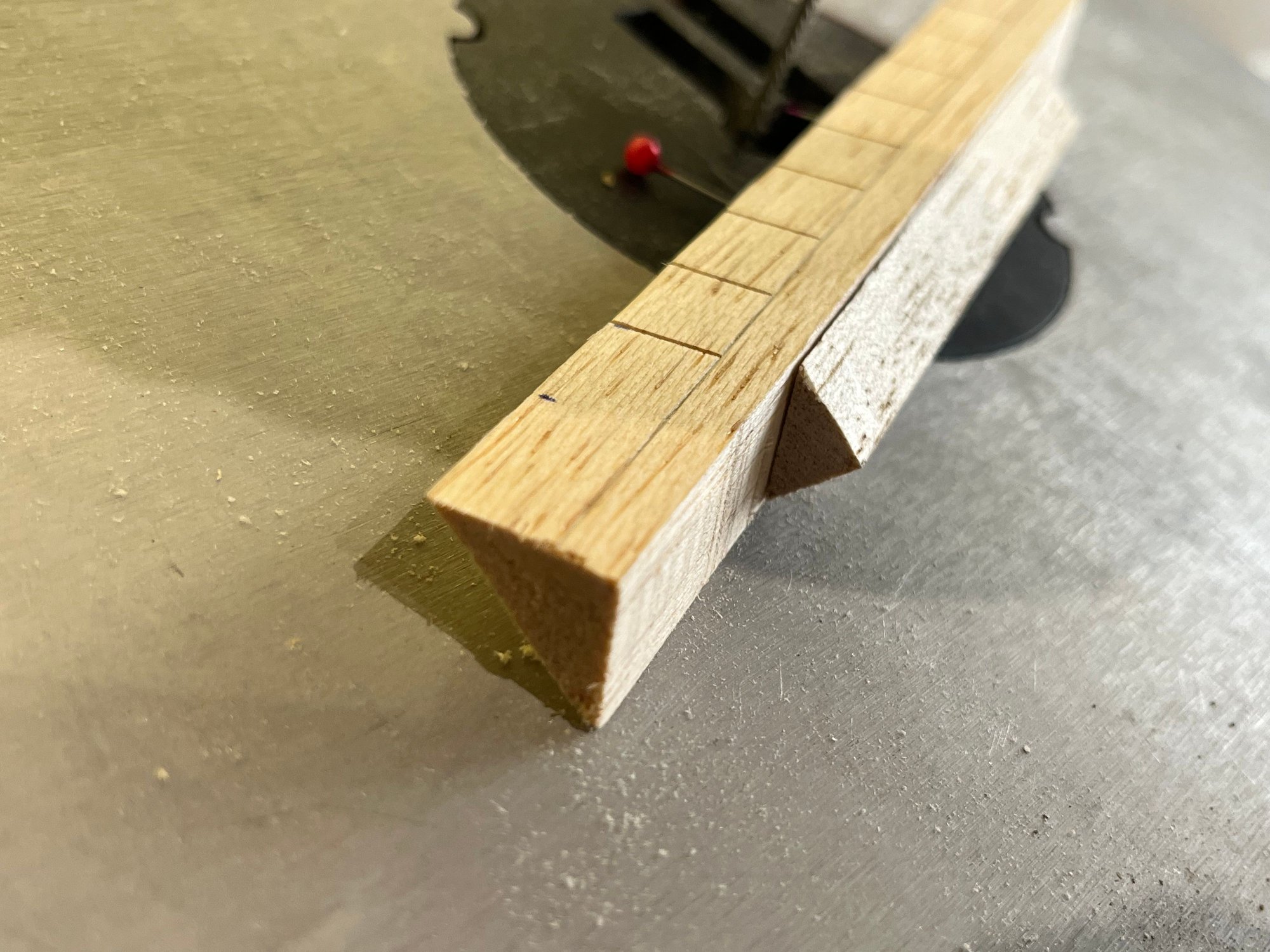

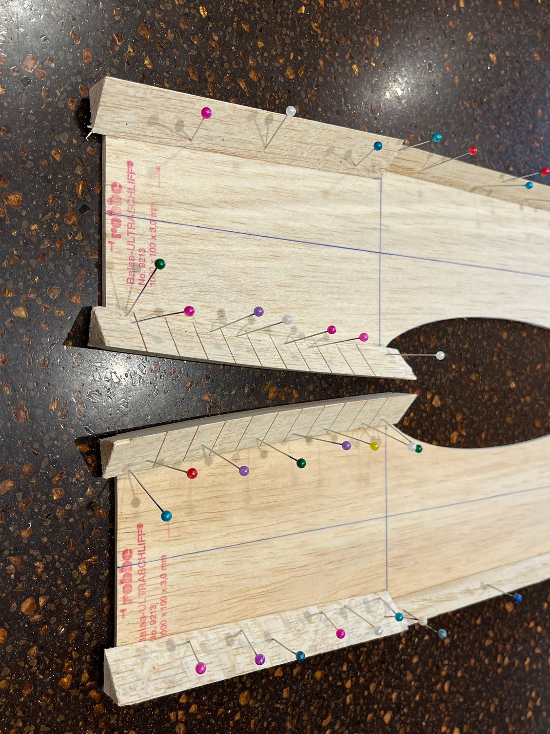

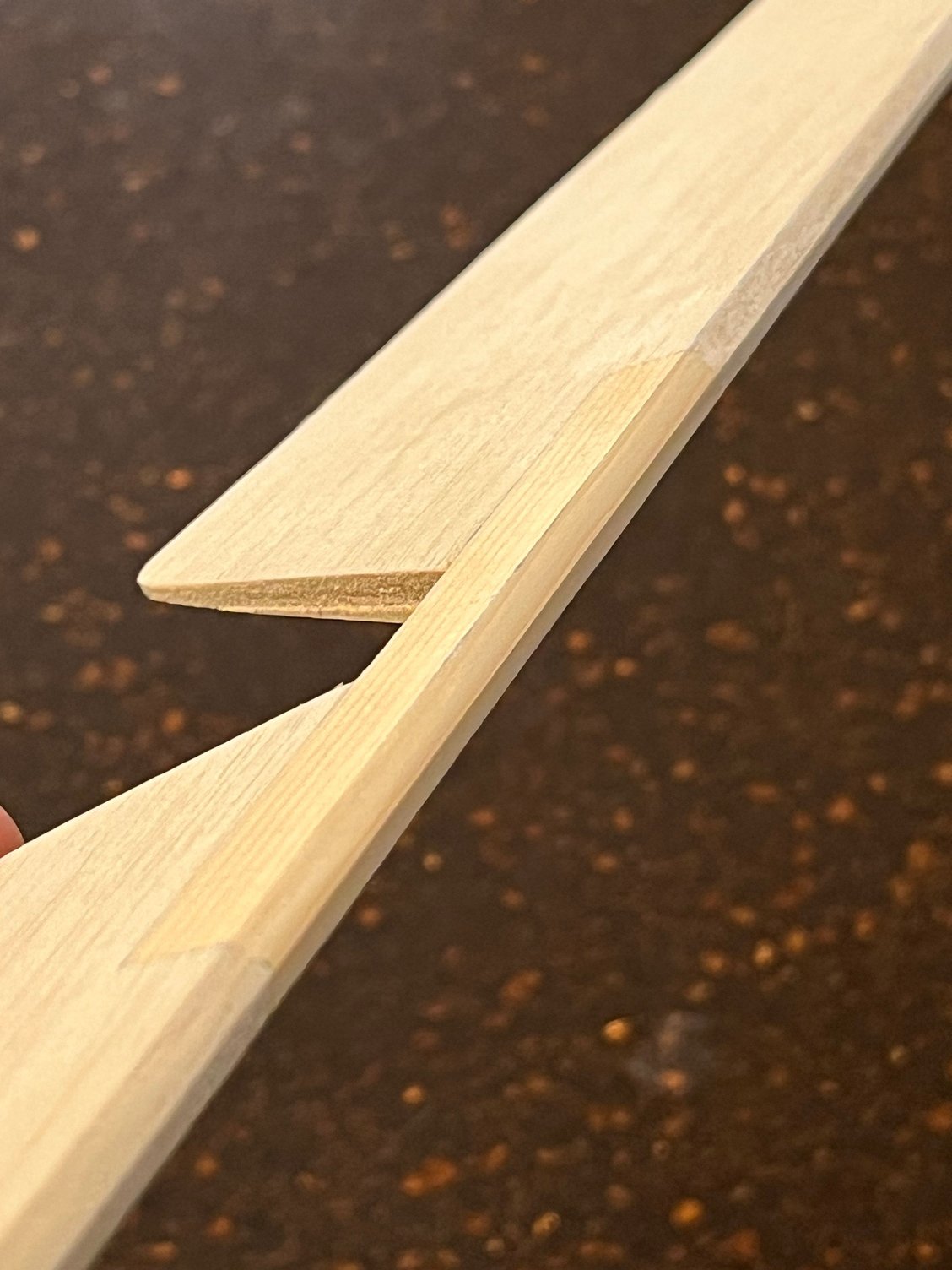

Other changes, in addition to the modified fuselage sides and the redesign of the formers, will include the use of triangular longerons in the corners and a top fuselage sheeting consisting of two layers of 5 mm balsa.
following the same construction method that Joe Bridi employed in many of his aircraft designs.

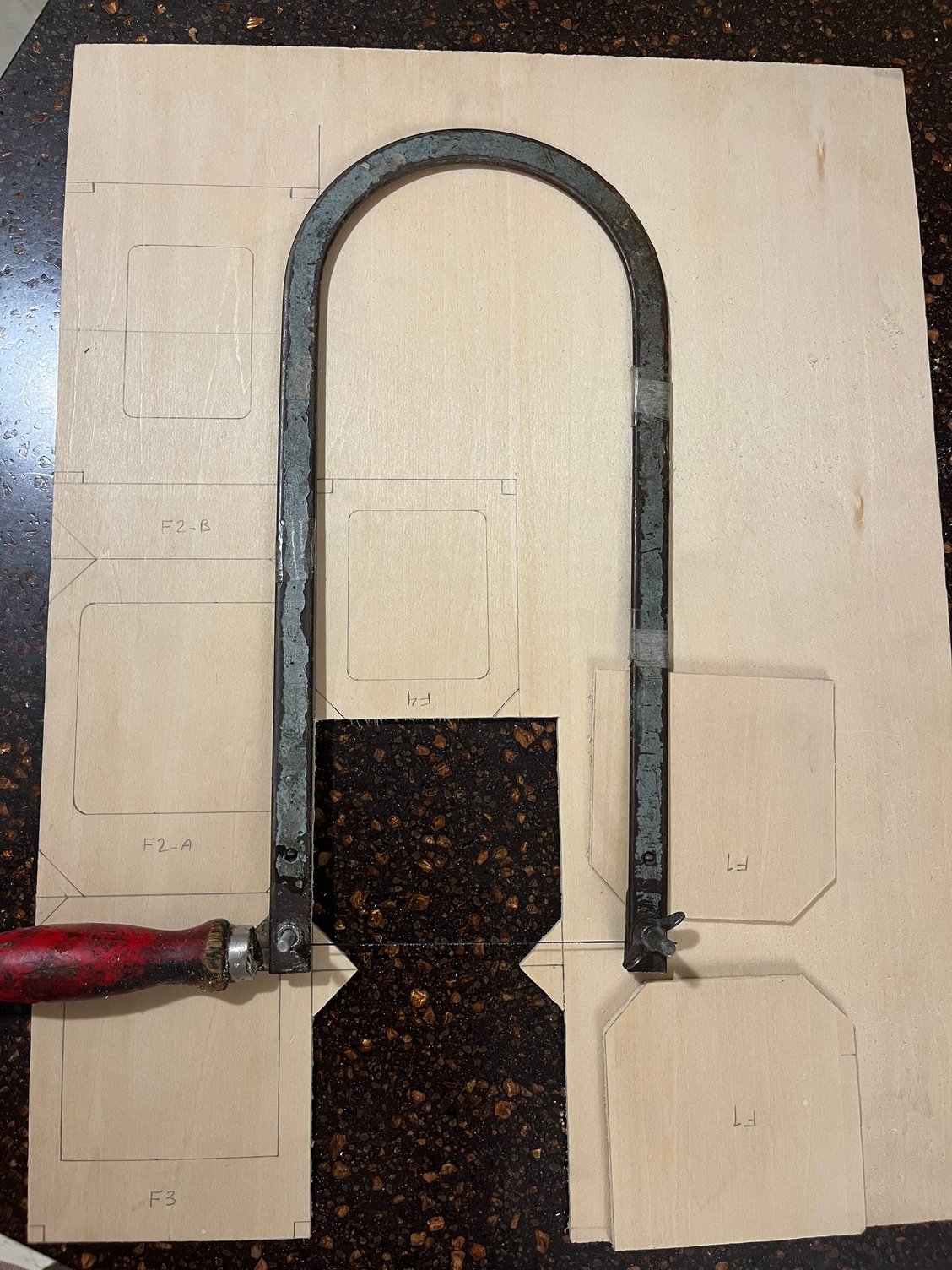

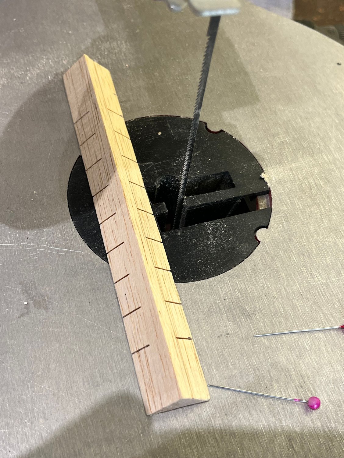

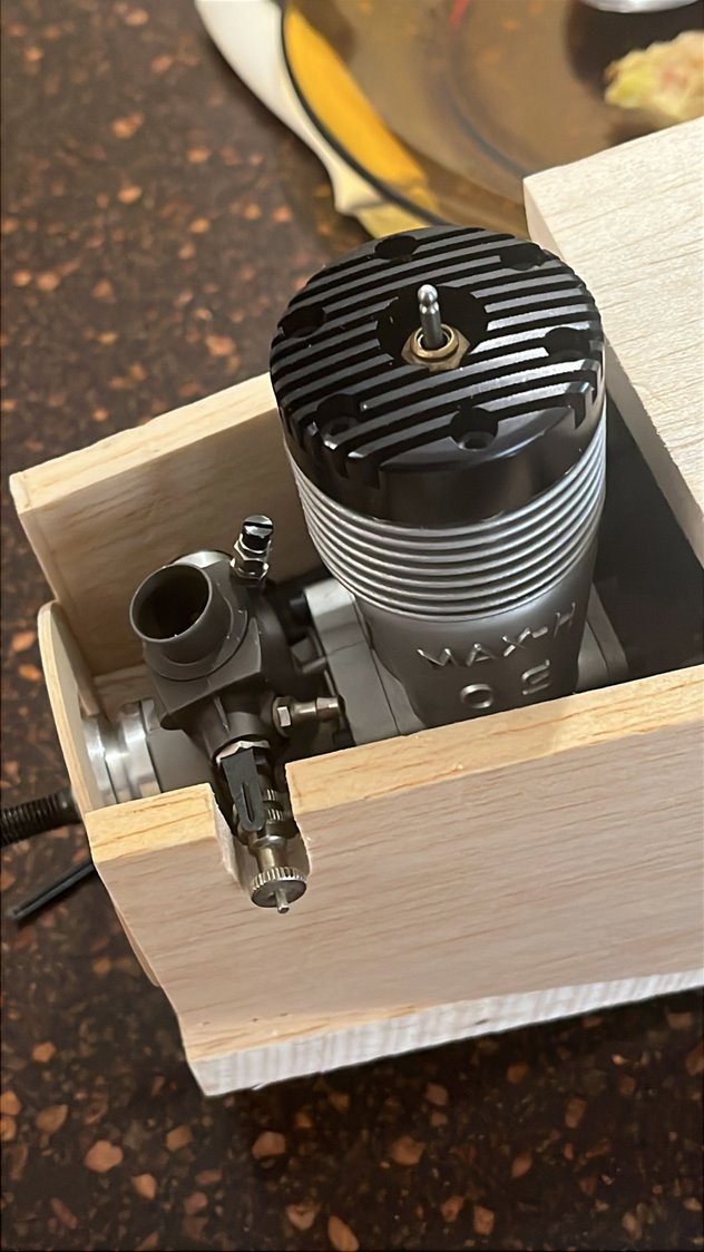

Very nice work. I admire your patience to hand cut parts with a coping saw. I have a band saw and a jig saw which speed up the process. The OS blackhead is a very nice engine. Not a powerhouse, by today’s standards, but perfect for the Kwik Fli. Looking forward to the rest of your build and, of course, the flight report.
-Will
-Will
The main reason I chose this engine was that I wanted the airplane to look exactly like it does in the Graupner catalog photos.
I doubt it produces any more power than a modern .46 or .50 engine.

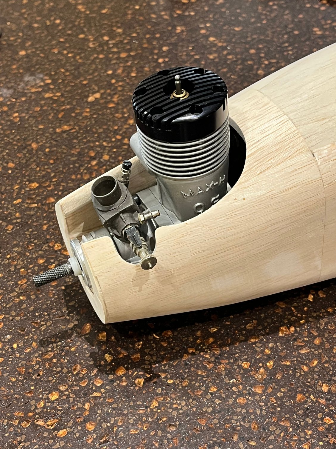

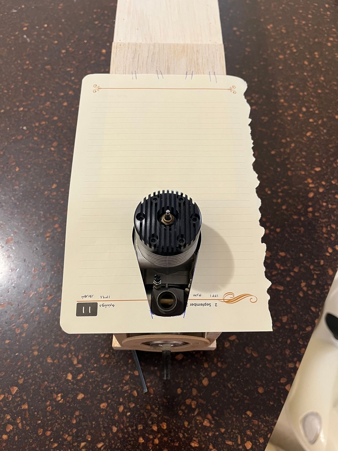

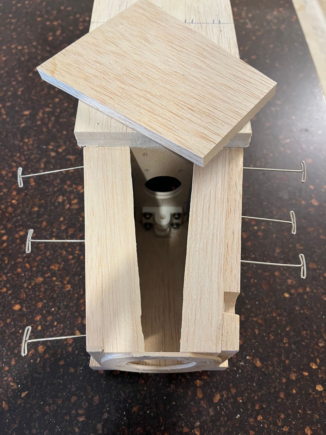

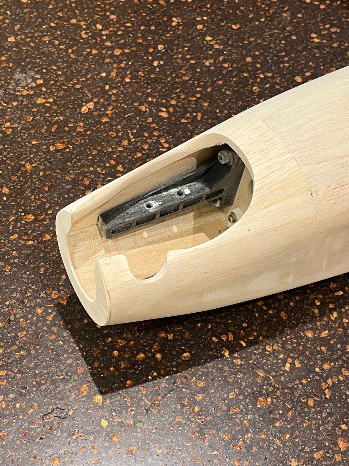

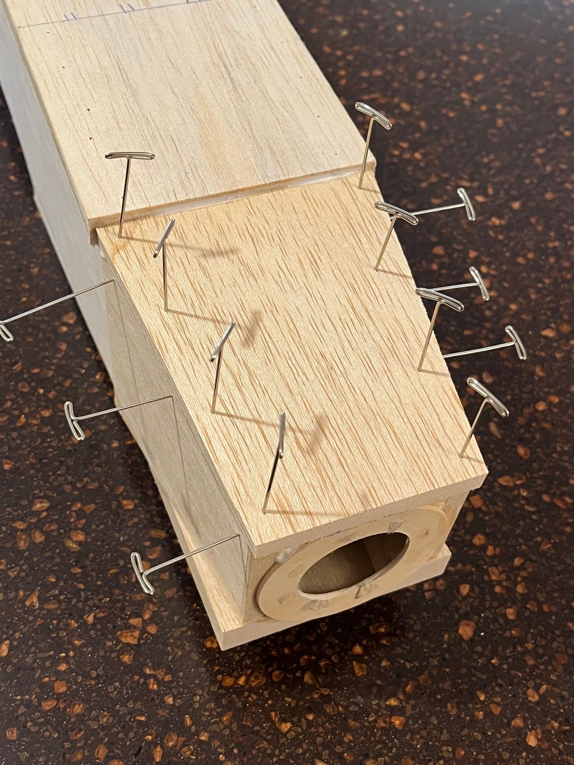

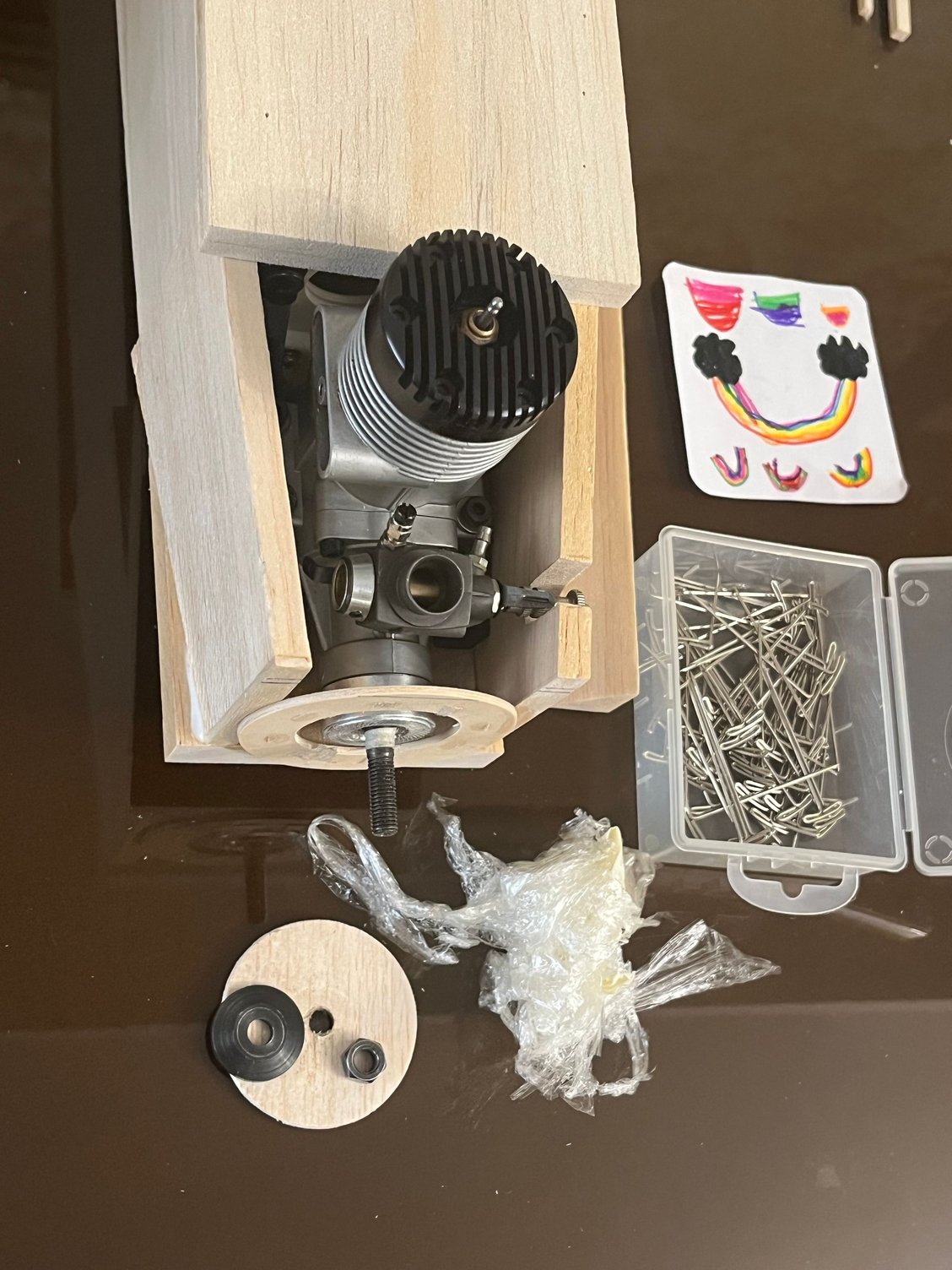

I finally found some time and managed to get the fuselage framed up.
Now it’s time to move on to the cowl and start fitting the wood blocks in that area.

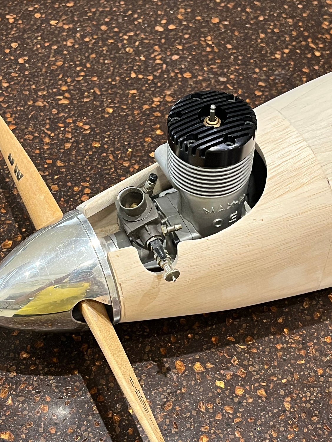

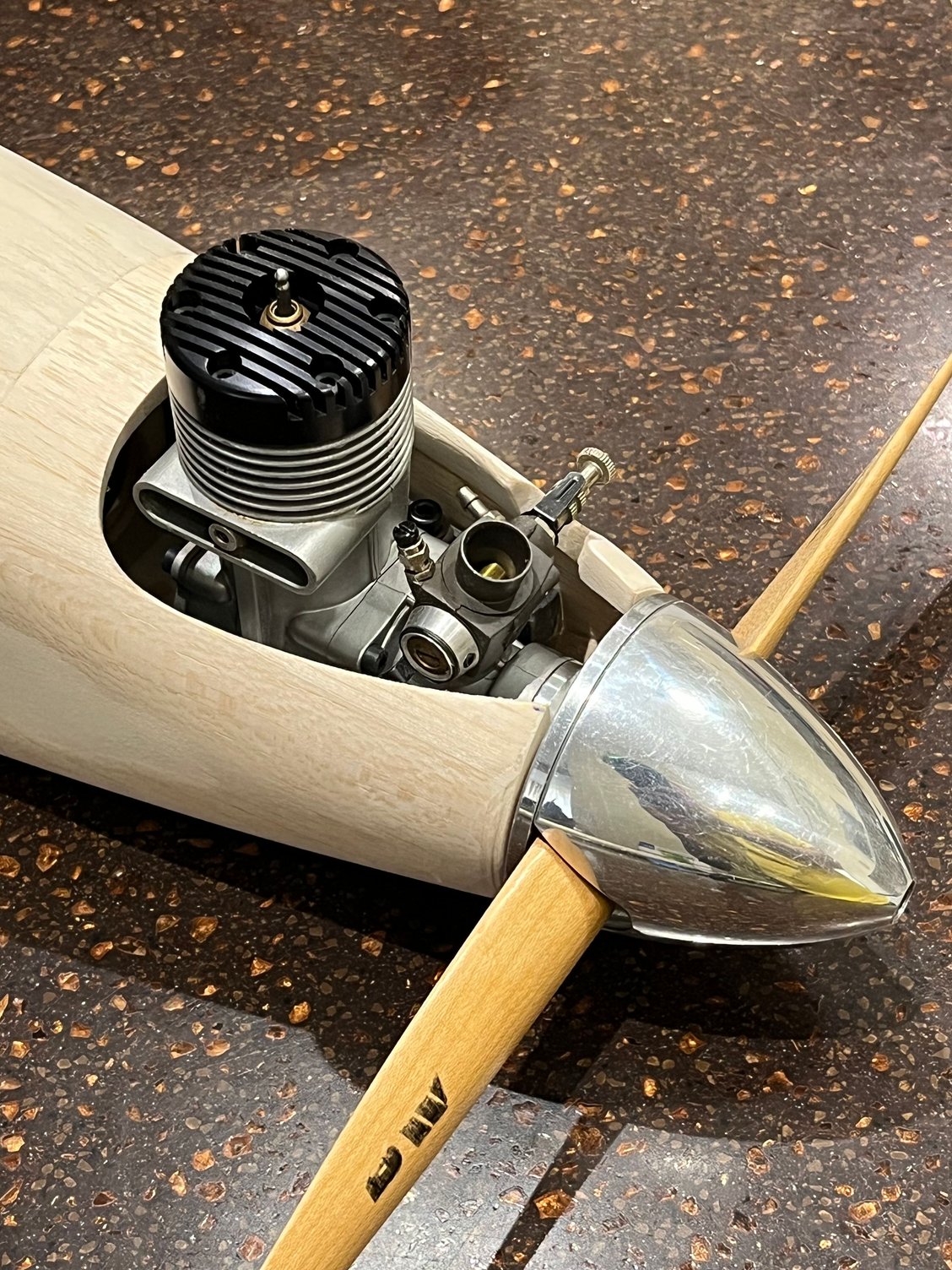

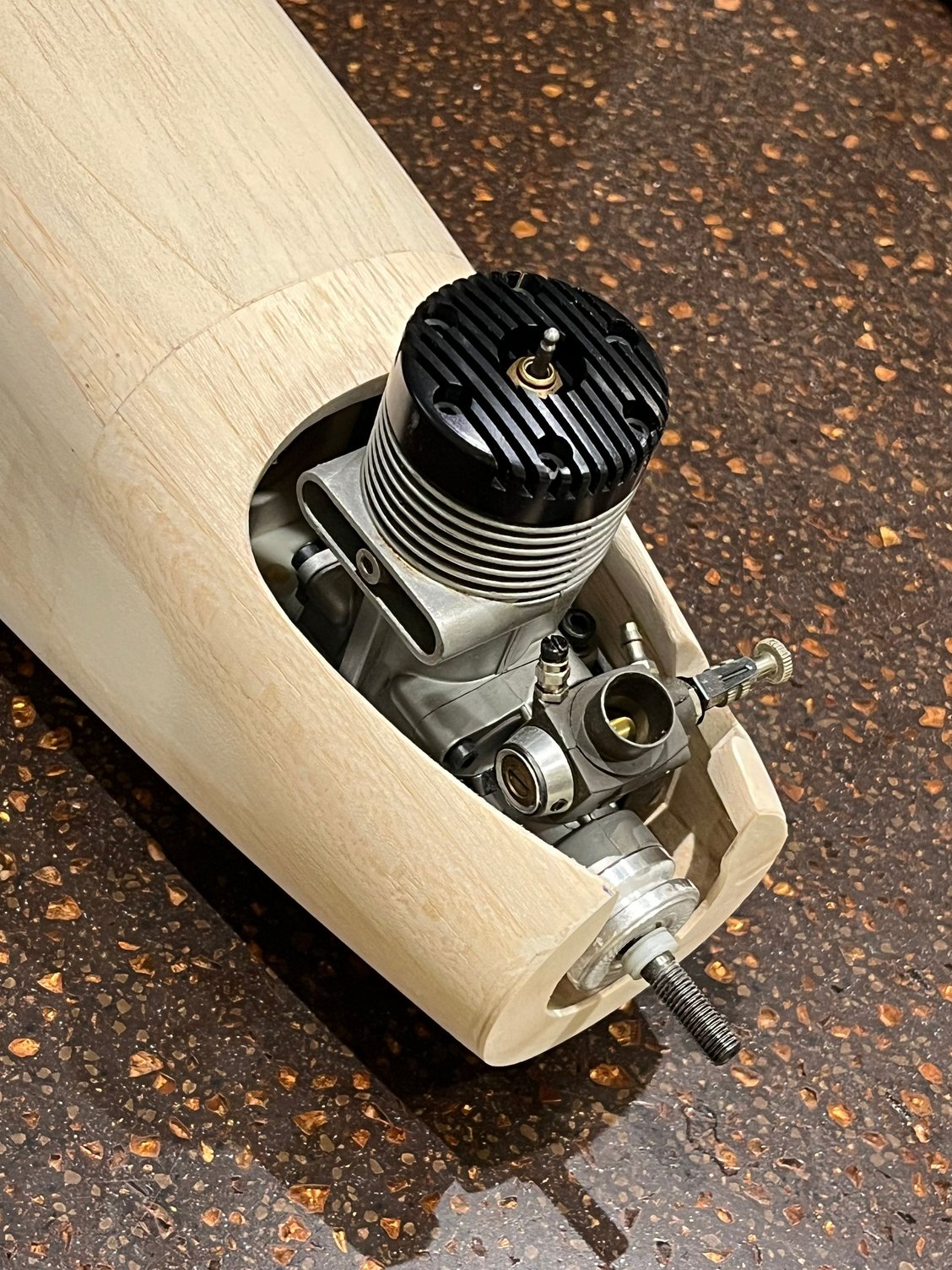

One of the details I’ve always appreciated on model airplanes is having the spinner backplate sit with a nice, even gap to the cowl.
At the same time, I don’t like the cowl opening to be overly large, leaving too much of the engine exposed. I prefer a balance where there’s still good access to the engine, while keeping it sufficiently enclosed for a clean, scale-like appearance

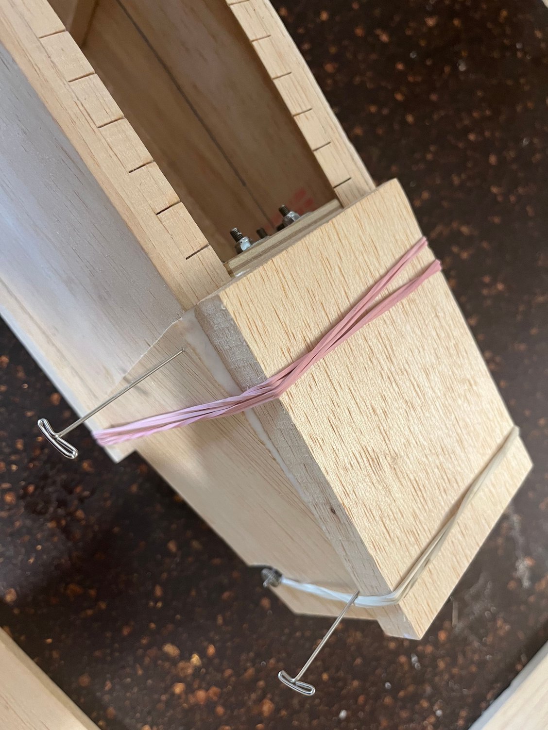

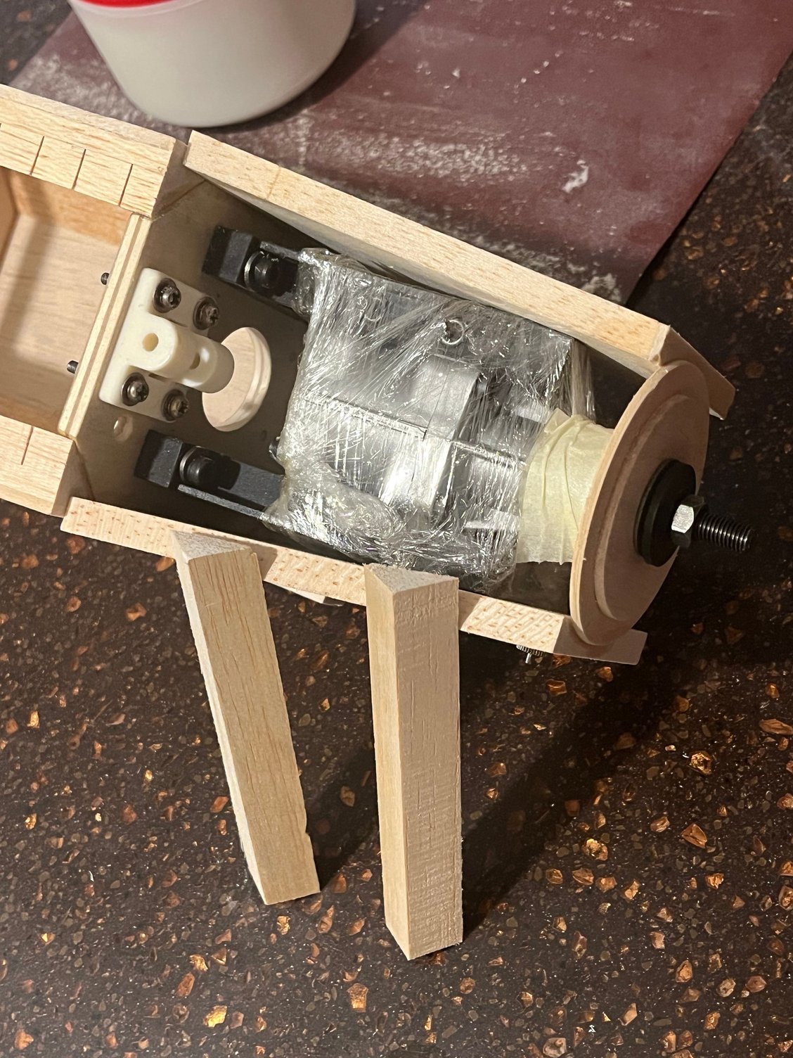

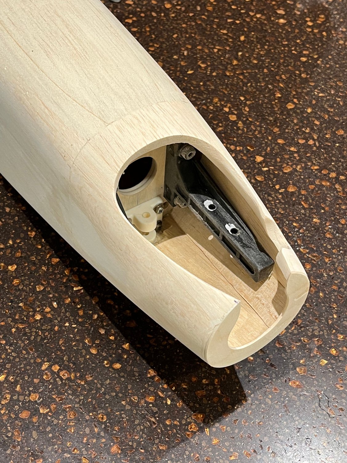

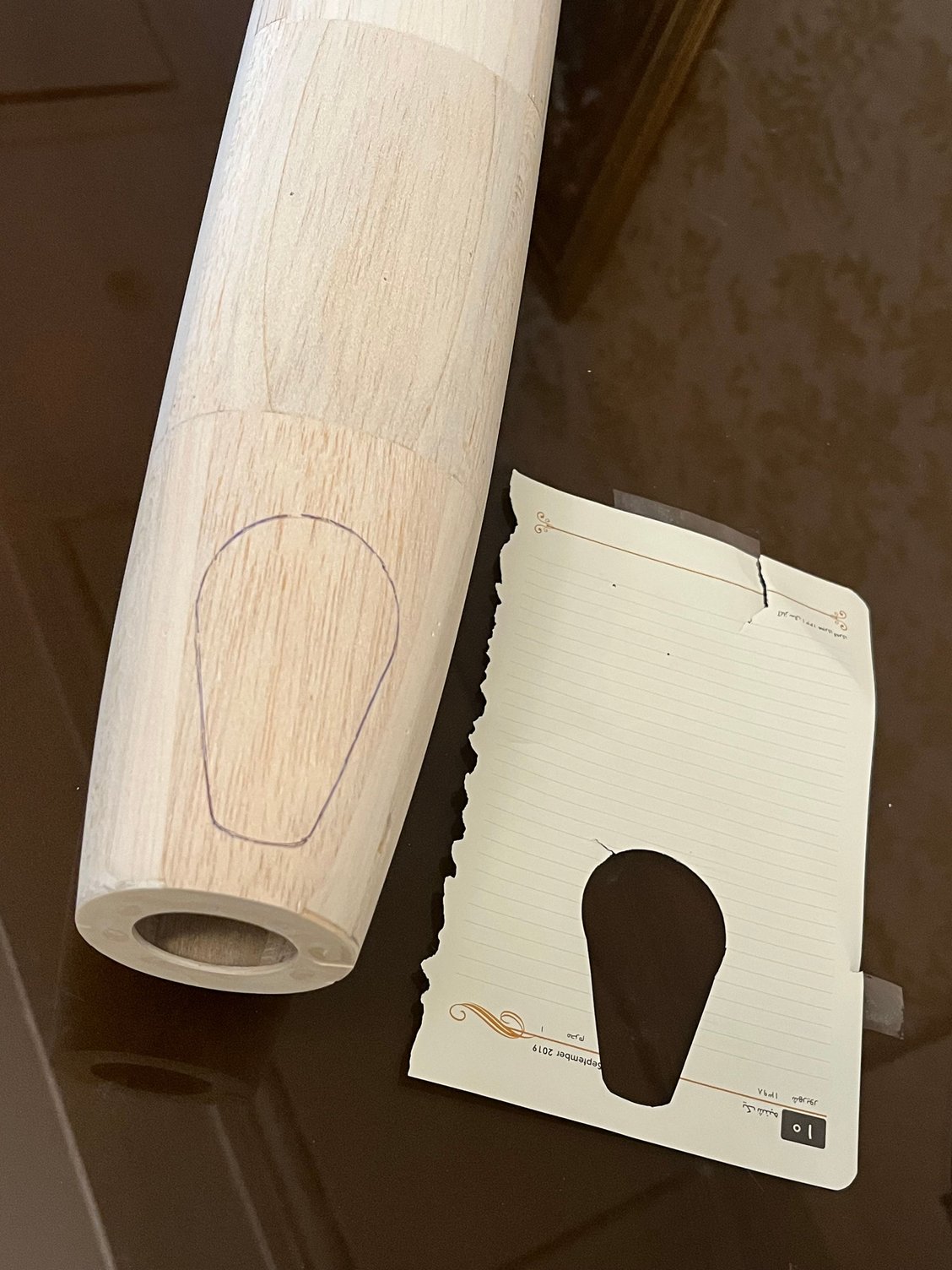

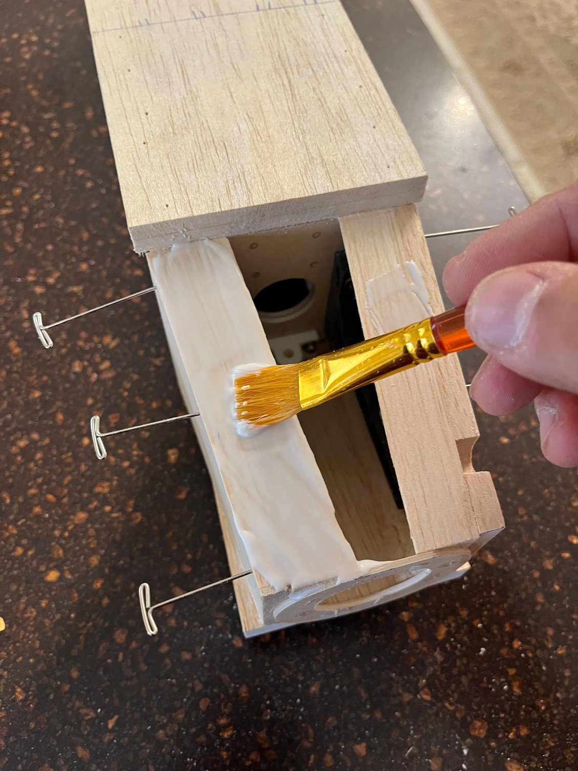

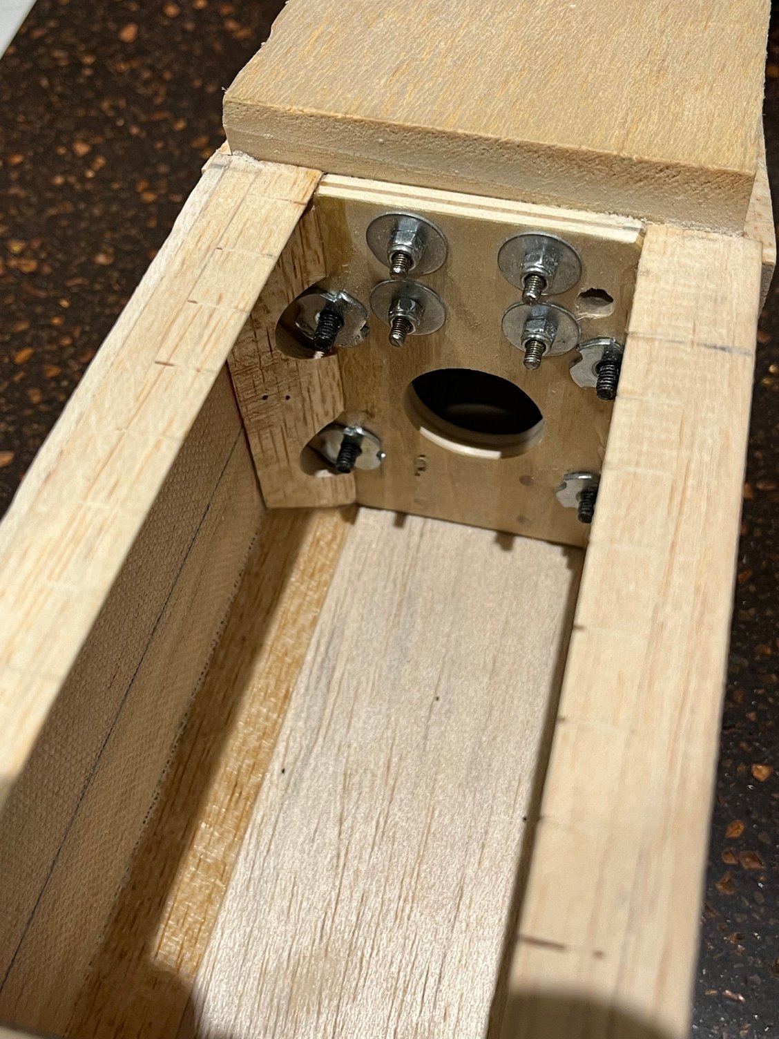

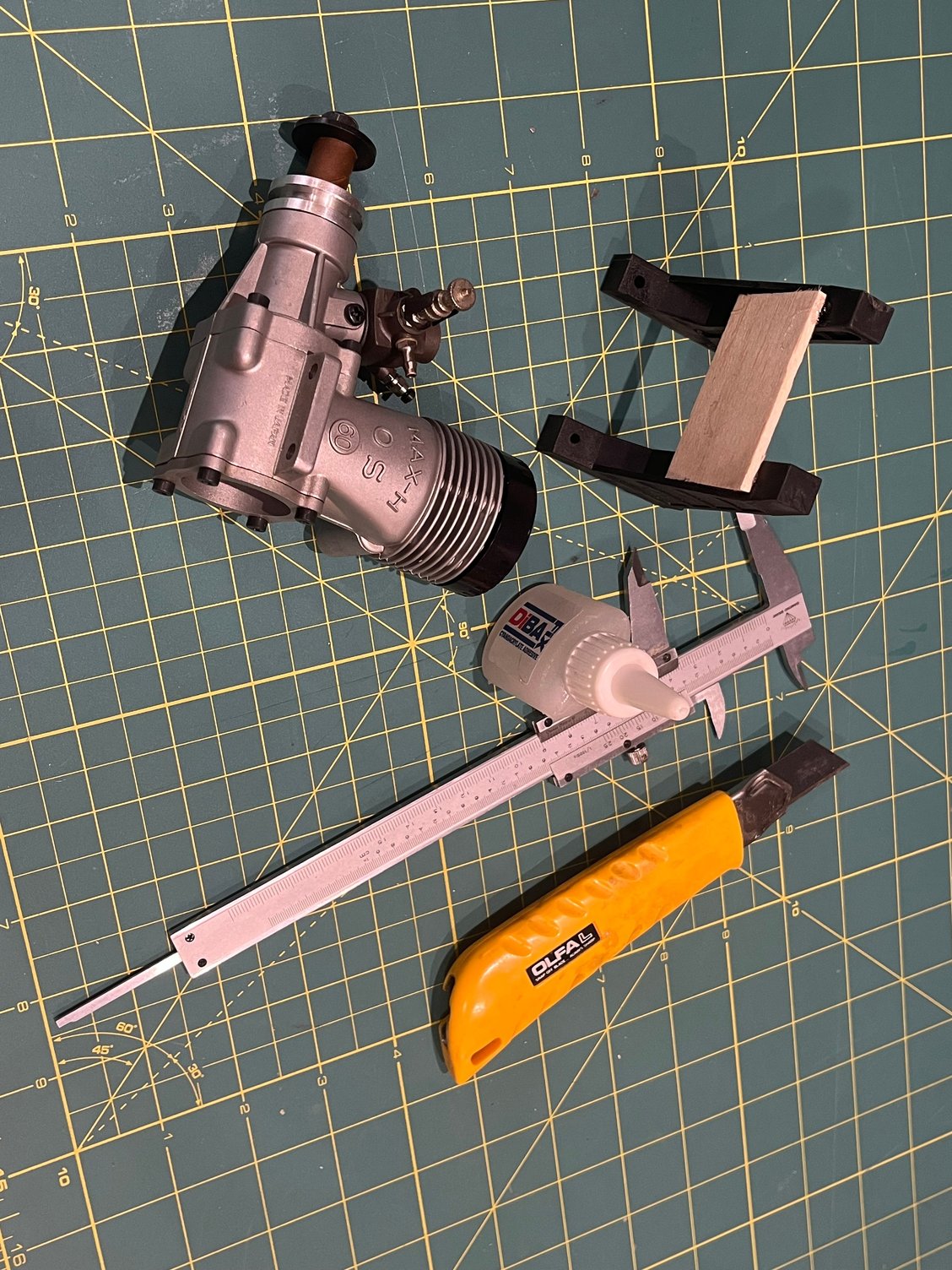

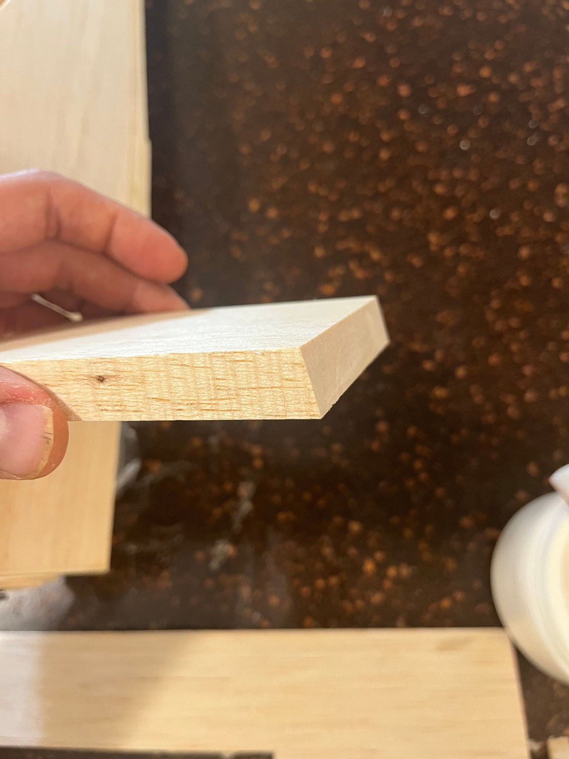

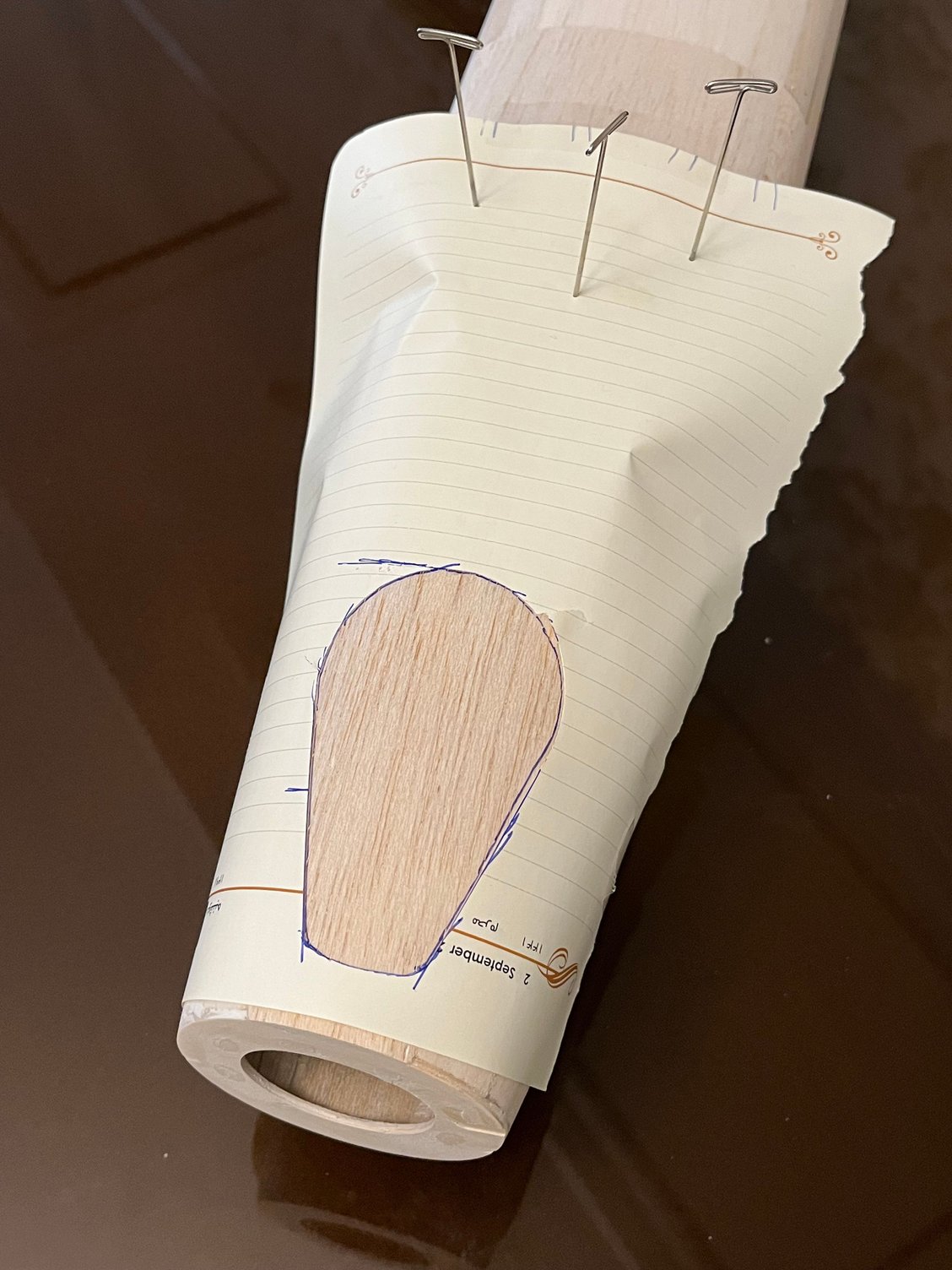

This is probably a method many of you already use, and it’s the one I prefer as well.
Before mounting the engine, I make a paper template with a cutout that represents the exact clearance I want between the engine and the cowl all the way around.
I then mount the engine on the airplane, place the template in position, and mark its location on the fuselage with a pencil. That way, even after removing the engine, I can put the template back in exactly the same spot using those reference marks.
Once the engine is removed, I start building up the cowl area by adding wood blocks until I have a solid structure to work with. Then I reposition the template using the reference marks and transfer the same opening onto the wood blocks.
I’ve found this method to be fairly accurate and repeatable, with very little error.
The following photos should help illustrate the process better than words.

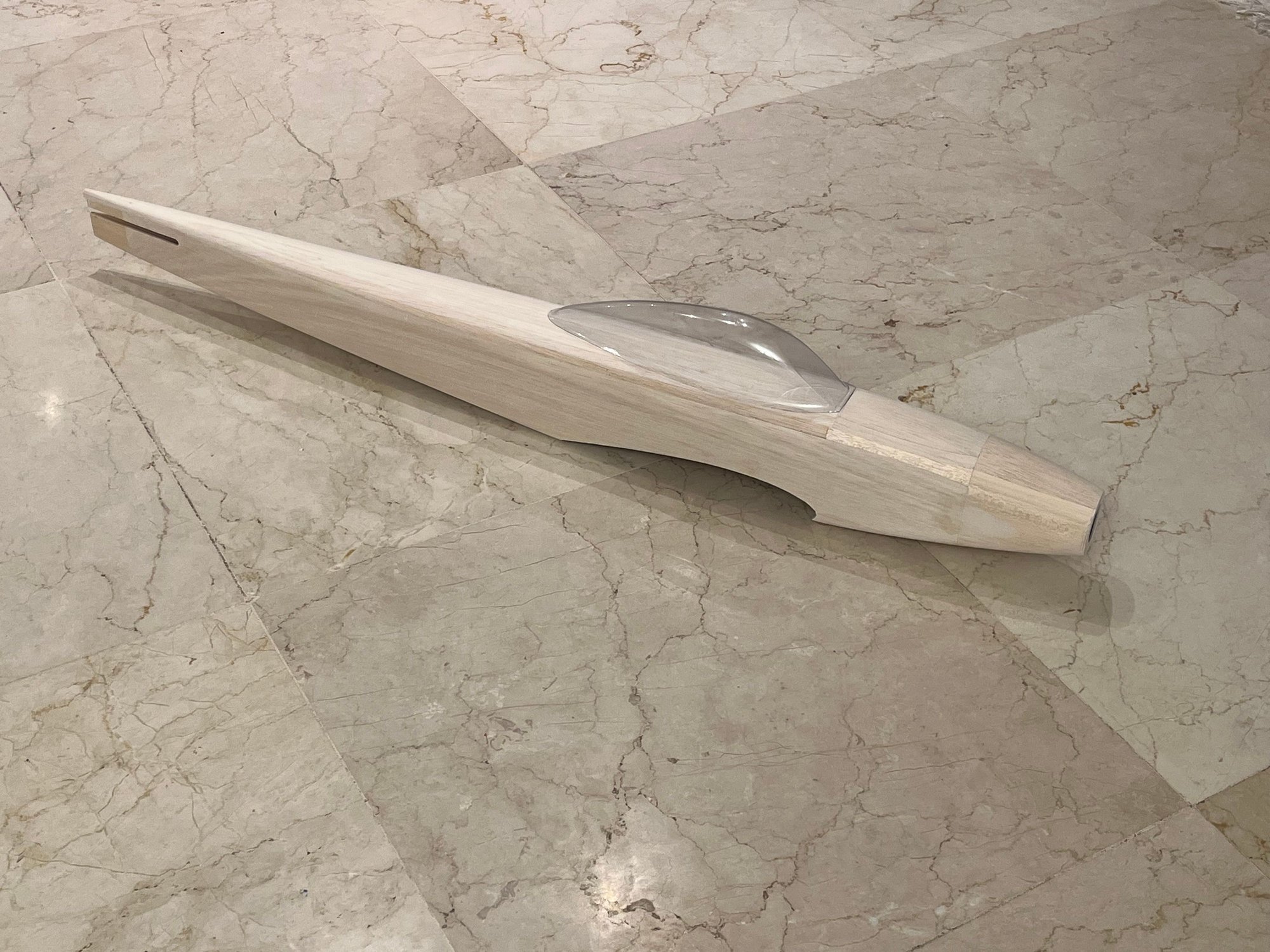

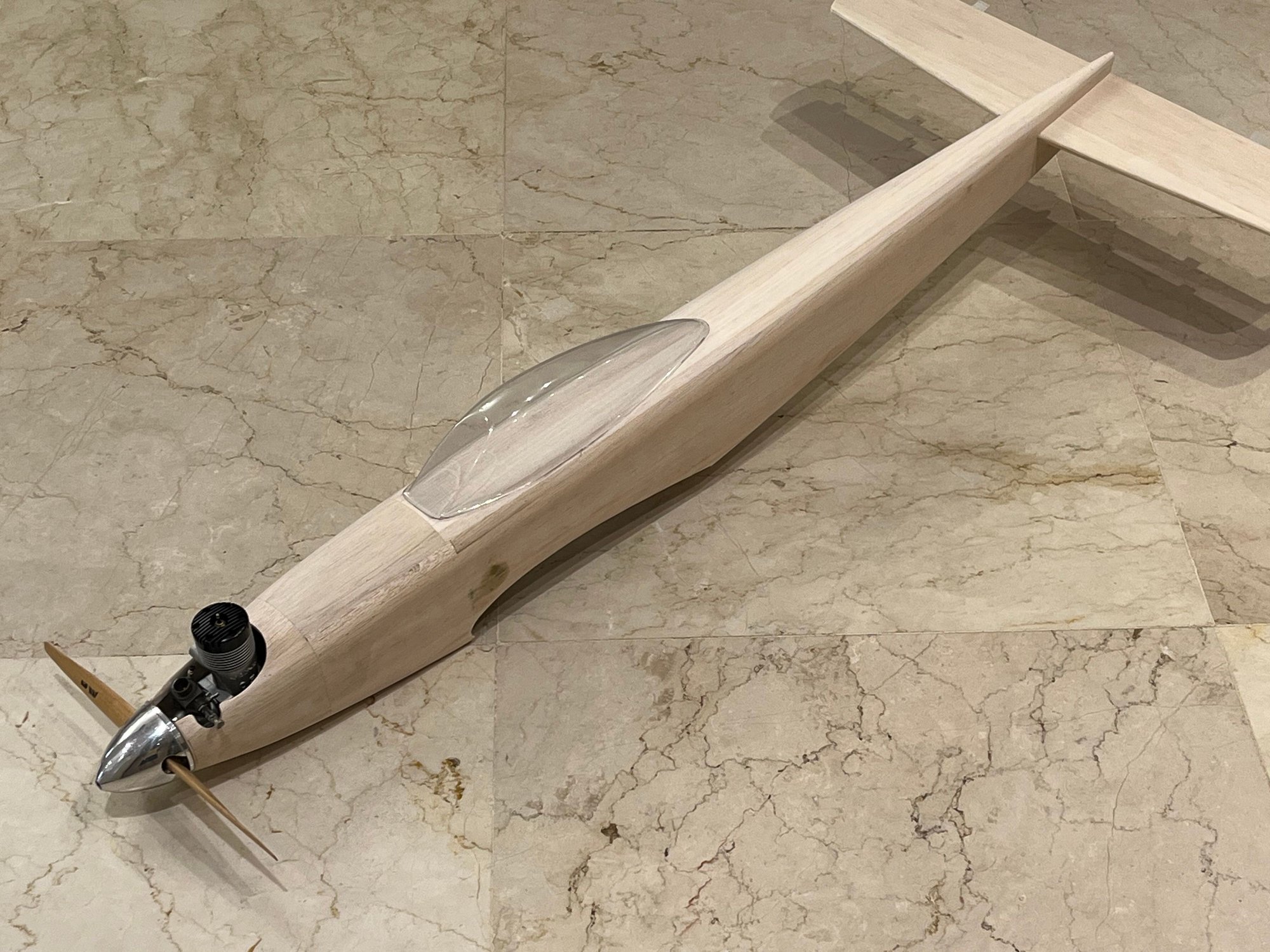

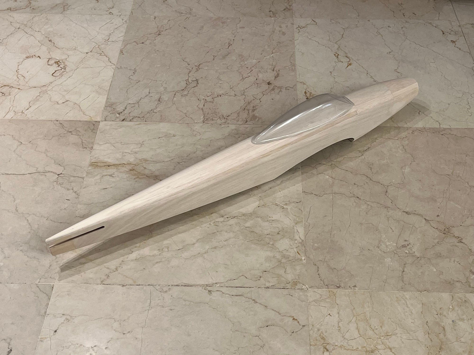

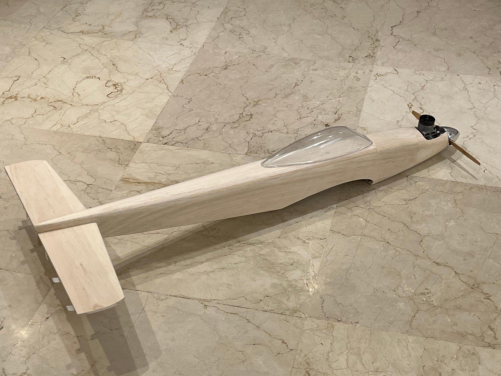

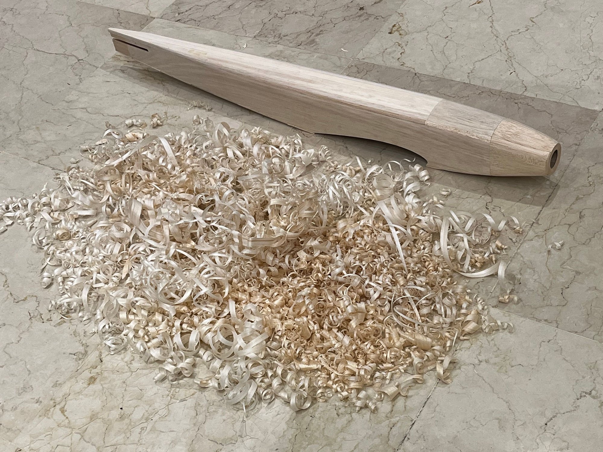

By the way, I’m also posting a few photos of the fuselage shaping process. The airplane’s form is now starting to emerge, and you can finally see what it will look like.

She is shaping along nicely. Very pretty lines. And looks very good wearing that O&S engine in the front.
