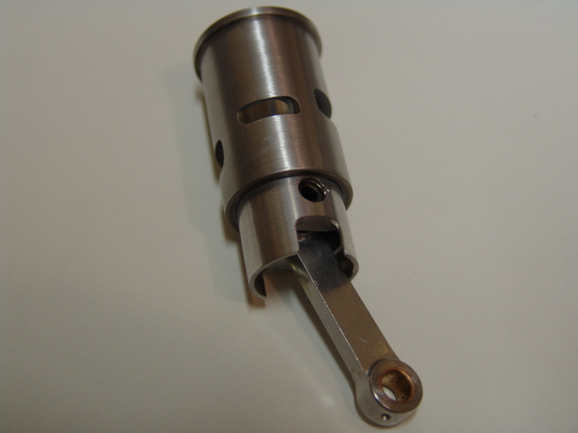

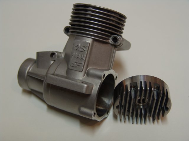

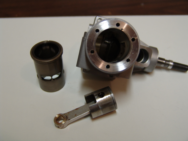

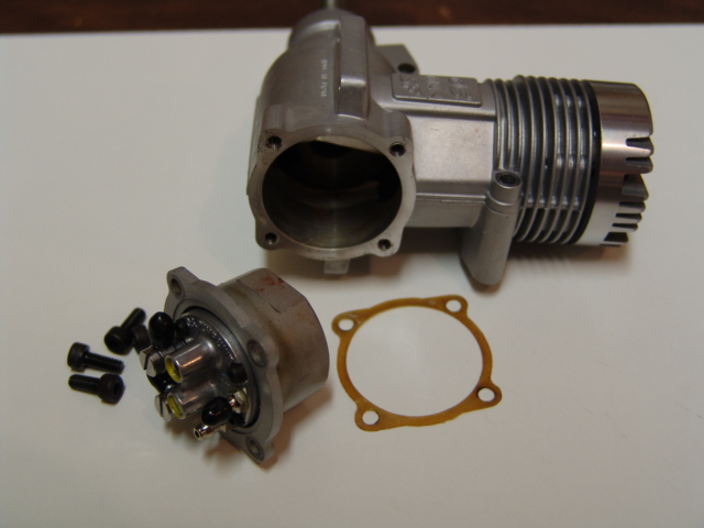

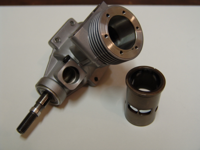

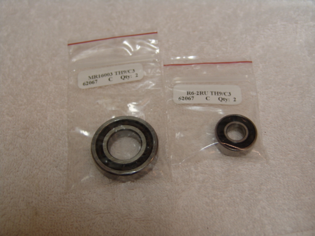

After giving the engine choice more thought I decided to tear down the engine that I tested for the Blue Angel and install one of my Nelson liners and pistons. The aluminum chrome Nelson liner is almost two ounces lighter than the stock ABC OS liner and has improved porting. That may result in an ounce or so less tail ballast too! While I had it apart I decided to replace the bearings because even though they felt and sounded good they didn’t look very good on the outside.
I expect most of you following this thread are very experienced at doing engine rebuilds but I thought I’d share my approach to the process.
My usual process is to remove the head (need to use an Allen wrench that is in like new condition to fit the bolts), remove the pump and drive washer. If the sleeve is stuck tight leave the drive washer on and install the prop. Insert a small piece of plywood between the top of the piston and the exhaust port. Turn the prop with a light force so the piston contacts the plywood and gently push the sleeve up.
After the sleeve is out turn the crank to top dead center and pull back on the rod with your finger. The piston should move to the back of the case, the rod should slide back on the connecting rod and the rod should almost fall off the crank shaft crank pin. Sometimes gunk can build up on the connecting rod preventing the rod from sliding all the way to the inside of the piston. Believe it or not, the professional engine rebuilders that I have talked to use a little heat from a propane torch on the bottom side of the piston through the back of the engine to free the rod. It sounds brutal but it has worked for me many times without any negative results. Just be careful with the heat.
Next I put the engine in an oven set to 350 degrees and let it heat for ten minutes or less. I remove the engine and hold it in a small towel and slap the back of the engine down on a block of would that is covered with a towel. Be careful. 350 degrees is darn hot!! With a good hard rap the crank should move back taking the back bearing along with it. Once the crank gets to the back of the case it should easily slide out with the bearing and you should be able to slide the back bearing off the crank shaft with a little force. I accomplish this by tapping the nose of the crank shaft on a piece of wood.
While the case is still hot I use a ½ inch dowel to push the front bearing out by tapping the case down with the dowel held against a hard surface.
After I get everything apart I clean up the case and head with Dawn Power Dissolver. Be careful that you do not leave the Dawn on the parts very long or it may tarnish the aluminum. At any rate, if it does get tarnished you can use Twinkle brand copper cream and a tooth brush to gently scrub the case and it will look like new. It takes a good bit of scrubbing and washing with hot water but the results are pretty impressive.
I do not mess with the pump other than clean it with fuel.
See images below to view the process and the images of the Nelson piston and liner kit. Unlike the OS piston the Nelson piston does not have an arrow on top pointing to the exhaust port and can be installed on the rod either way.
My new bearings are on their way from Boca Bearing and I will cover the assembly shortly.
To be continued…

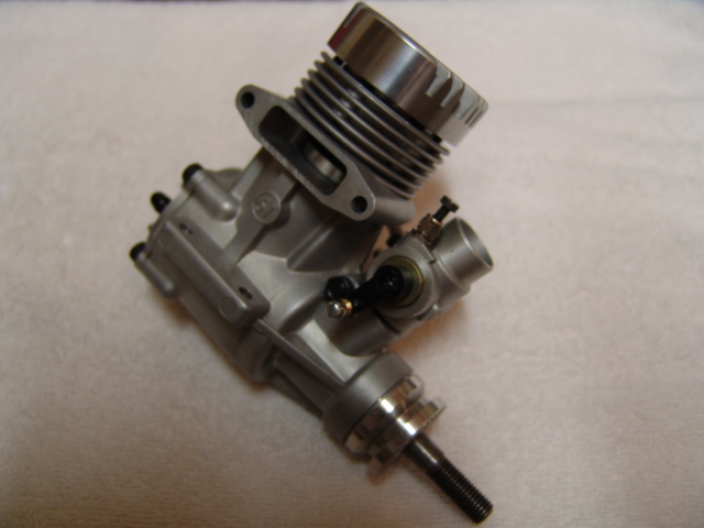

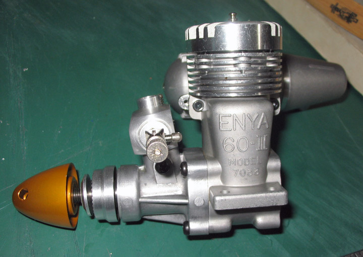

I love restoring used engines and I've done a dozen or so over the last several months that I've picked up cheap at auction. I will vouch for the copper cream; it works like magic!
8178, one thing I do different - and this is just my preference - is to remove the crank before heating the case and bearings in the oven. I find it a lot easier to get rear bearings out of a case than trying to get them off of a crankshaft. The crank and the bearing's inner race are both steel and expand around the same amount, but the aluminum case will expand more than the bearing's outer race. So, they usually fall out after heating in the oven. This is more of an issue with older engines with lots of castor varnish inside.
Just to show you how well the copper cream and Dawn Power Dissolver work, I bought this engine for $23 off *bay. It was covered with black carbon and castor varnish. New ring, conrod, bearings, gaskets and O-ring and it's like a new engine (I did buy the muffler from Ken Enya new).
David

The Boca bearings arrived today so I reassembled the engine. The engine with the Nelson liner/piston installed is a little over 1.5 ounces lighter than the stock ABC liner/piston configuration. Pretty decent for a used engine.
To be continued…

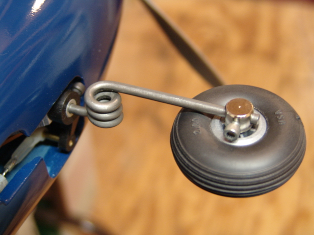

Got the gear strut flats ground for the axel and strut bolts. For some reason I just hate doing it but it is a must do to keep the strut parts locked together in the correct position.
I’m just a tad nose heavy on the recommended CG point and I’m not going to change it with tail ballast. From my calculations on the swept wing the recommended CG point is at 33% of the Mean Aerodynamic Cord (MAC). My CG will be at about 30% of the MAC and I’m OK with that rather than adding ballast. I may change my mind after I fly it for awile.
To be continued…

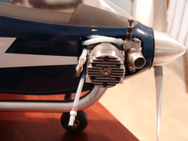

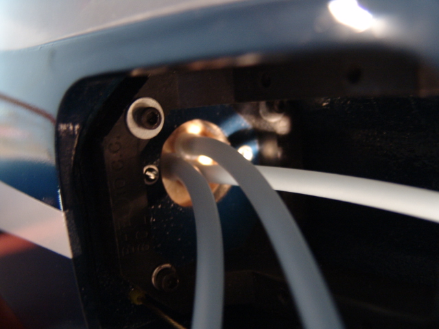

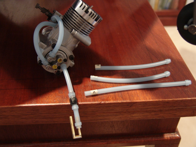

I test ran the rebuilt engine today and after about 16 oz of fuel it was turning 10.4 K RPM a couple of times when I leaned it out a little. Didn’t want to peek it up too much but also not run it rich with a new AAC liner and piston. My pipe length is 18” from the center of the glow plug to widest spot in the pipe which I believe is a good starting point for the pipe length when running an APC 12 -10W. Looks like I picked up 300 RPMs with the new bearings and Nelson sleeve/piston set. The pump and carb are working great with a good idle and smooth transition to full RPM. I expect with some more running the RPMs will pick up some as the engine still has a pretty good squeak as the piston moves through the upper part of the cylinder. The only significant event during the test was when a curious wasp got a little too close to the front of the prop and I got a face full of wasp parts! Ugh!!
Next step was setting up the fuel lines. I like to put a piece of fuel tubing over the end of the lines to keep them in place. I open the loop with a hemostat and slip the line trough the loop. It’s kind of tricky process but not bad after you figure out how to do it. It is pretty tight behind the engine for the lines but I think I got everything in without any line kinks. We will know soon! The brass U is a part I made for the Tiporare so I borrowed it for the Blue Angel. The top line is removed for fueling along with the vent check valve on the vent line. The black thing on the engine fuel supply line is a fuel filter with a piece of heat shrink on it to prevent it from making metal to metal contact on the engine. The check valve keeps the vent line from dribbling fuel and loss of fuel at various flight attitudes and keeps the airframe a little cleaner.
Not much left to do now. It is a little heavy on the right side even though I used my heaviest balsa on the left wing to offset the weight of the side mounted engine and pipe. I’m going to add a smidge of lead in the left wing to fix that. Got to glue the rudder hinges and check and adjust the control throws for final trim.
To be continued…

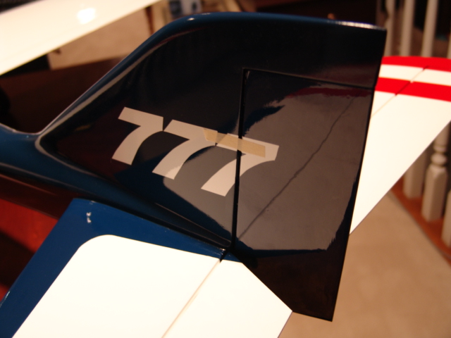

Making good progress. Glued the rudder hinges and added a little over ½ ounce of lead to the left wing tip to offset the weight of the pipe and side mounted engine.
To be continued…
