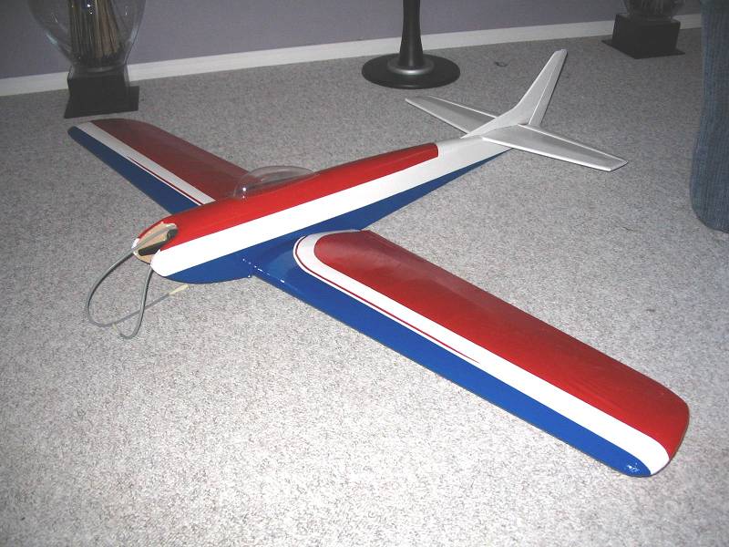

Here's my Taurus/Primus in the final stages of completion. Balsa is great all around and the laser cutting crisp. I have two other Taurus' in the box plus Jeff's recent Kwik Fli. Great kits. Will post better photos when complete and the Kazmirski paint scheme done a bit better.

What engine will you use?

I'm planning on an OS .61 FS which is more engine than the aircraft needs....I just had one lying around and had built the fuse a bit tail heavy. I had an original Taurus with an ST .56 w/Perry carb and it too was more engine than required. I have a Sun Fli IV with a Thunder Tiger .45 that flies great....suspect the same engine would be good for the Taurus.

Duane (King Altair) put a OS 61 FX in his. It flies beautifully! I'm surprised how quiet that engine is. Looks like you straightened the wing out a bit. Is that standard dihedral or less?

The dihedral is as designed, it's just the camera aspect. Mr Kaz nailed the dihedral on this machine as it looks right and gives that slight "barrel" to axial rolls. Joe Bridi built dihedral into his earlier machines by keeping the top surface of the wing straight, but tapering the ribs out to the tips thus giving dihedral on the bottom surface only. Should be on it's legs this w'end, so when complete I'll fire off that photo I've promised ya for the last several months!

You have made a fine job of the Taurus. What technique did you use for the finishing, dope/silk/nylon or film?

Initial intent was plain coverite painted, but to make sure I got the first hop in this June, I decided on Century 21 Fabric. Heavy, but worth it. The scheme isn't quite done yet, so I have to put a few more details on the vertical and horizontal stab to get it looking like the original. I believe Kazmirski used a deeper, almost back, shade of blue.
