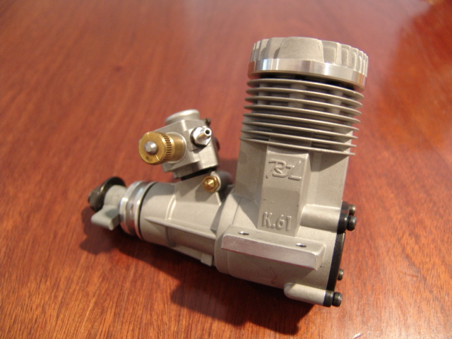

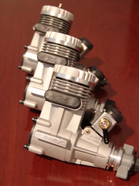

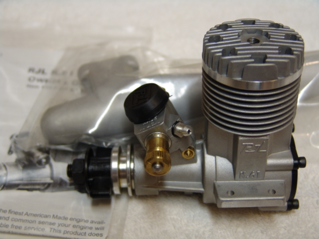

I have three new RJL K.61s. I’ve only run one of them so far and had a little problem with the carb. I looks like the two first engines I bought had a small problem with the low speed needle valve so I put the newest carb on and it runs outstanding. Meanwhile RJL is taking care of the carb problems for me and apparently none of the new carbs have the problem. The RJL K.61 is one of the few engines left that have the small case like the Webra 61, Veco 61, silver case Irvine 61, etc. RJL engines are available from Sheldon’s Hobbies http://www.sheldonshobbies.com/ .
Happy with American made stuff and do not and never will own a four stroke!

A very fine looking engine. I think the exhaust and intake caps are a nice touch. As for performance, do you know how this engine compares with imports (read OS 61) in the pattern? I also was looking at the "new" K&B's that Razor was talking about. I wonder how they compare to the favorite 2C pattern engines.

When I was building my Cold Duck I did a lot of research to find a non-piped 61 engine that was powerful, had a small case, was good quality and was readily available with spare parts. Cost was not a major factor in the research. The RJL became the clear choice over all others because of its quality, power, size and availability. The K&B twist head, although very powerful and small lost out because the disassembly issue of the twist head.
The RJL K.61 http://www.mecoa.com/rjl/k61/k61.htm is rated at 1.8 HP and 15,500 RPM and the current offing from OS http://www2.towerhobbies.com/cgi-bin...?&I=LXBY46&P=0 is the 61 FX Non-Ringed rated at 1.9 HP at 16,000 RPM. HP ratings are little hard to compare especially when the OS needs another 500 RPM to get the .1 HP over the K.61.
The K.61, at 20.3 oz with muffler, is 3.3 oz lighter than the OS FX and the K.61 uses the small 39 mm wide motor mount as well. The RJL has a two year warranty, same as the OS. I prefer the smaller K.61 case over the OS because it makes it easer to fit in the classic airframes that usually were engineered for the smaller case engines. Cutting 3.3 oz off the nose and total weight of the aircraft is a plus as well. The K.61 fits perfectly in the front of my Cold Duck that has very little room for the engine because it was designed for a Veco 61. I did move the firewall back ¼” because most of the engine choices are longer than the Veco.
My Cold Duck is 5 lb 7.5 oz and the K.61 with a Rev-up Pro Series 4 11-7 1/2 prop hauls it like a ballistic rocket! Lucky for me my Rev-up props last for decades!
And to top this all off the K.61 is $45 less than the OS! But the OS engines are very good and I have a bunch of them too.
