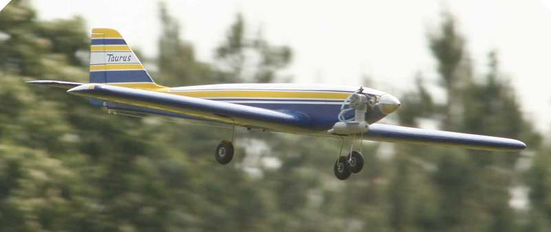

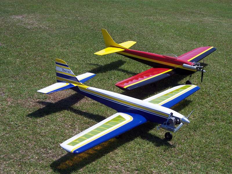

Referring to your first picture, looks like there is a lot of "fin changing" going on---I did the same with my Taurus, and it looks and flys very well. I left mine a "trike", and side-mounted the engine. There is a photo of mine on approach, and another with Jeff's Taurus prototype.

Thanks for the photos of the 'fin' changes. Have you noticed any difference in flight? I like the looks of the modified fin better.

You did a great job on these planes. I like taildraggers so I am going to modify my plane as such. I am also going to use a much larger canopy for knife edge effect and looks . I debated using the side mounted engine but thought I would just stick to the original to save some work. Skip

I think the hinge line on my fin is more vertical than the one Skip is using. It was mainly done to make it look a bit more modern, and to improve knife-edge flight. I'm still essentially a beginner, but an expert pilot who has flown my Taurus was able to do slow rolls, 4-point rolls, knife edge, even figure Ms with it. It was absolutely great to see what an accompliched pilot could do with a Taurus--- in spite of the semi-symmetrical airfoil the Taurus uses. IMHO, this is a wonderful plane to fly under low or moderate wind conditions.
I also removed about 1/2 of the dihedral, as a side-by-side comparison shows.

That's right 8178-----I did find a canopy for it, and it changed the whole looks of the plane to give it more of a Taurus look, (got the canopy from Jeff--I think it's a SIG canopy). One of my regrets, is that the great Dick Pettit photo of the approach doesn't have a canopy. The picture was taken at a VR/CS meet last year, and at the time the "static" picture was taken, the plane had never been flown. I now have 83 flights on it, (yes, in this one case, I've actually logged the flights in a log book[X(]).
