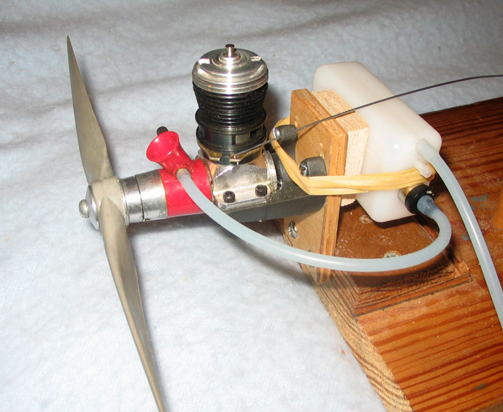

Today a friend gave me a Cox .15. It's not a Conquest, but a throttled Medallion. I will run it tomorrow and tach it. If I feel like it's strong enough I might build a PP around it. At least it will be loud. But with today's mini servos and rx's it will be easy enough to build one very light. I've generated a set of rib patterns for a built-up wing that could be lighter than the foam cores, too.
#28
I had a chance to tach the Cox .15. I knew beforehand that Medallions have no where near the power of a TD or Conquest. Still, it's a good running little engine and would definitely fly a 2lb plane. I got close to 12,500 with an APC 8x4 on 10% fuel and just over 15,000 with an APC 7x4 and 25% fuel. The throttle actually works well. It's more of a wide open/idle type control without much midrange, but it doesn't stutter or hesitate. I don't remember what my FP .15 does, but I'm sure the FP is stronger, and a lot more quiet. The Medallion is very loud.

I used to fly a Cox Medallion .15 (unthrottled) on control line models. This was back before electric starters were around. It was one of the hardest hand starting engines I have ever owned. All of my usual tricks did nothing to get this engine to start. With today's electric starters, it will be a piece of cake, I'm sure.
I expected it to be a howler, but it wasn't. It was even with the other sport .15 engines (Fox .15X, OK Cub .14, OS and Enya .15s), so it was not a disappointment that way. Some fellows had worked out how to get it going quickly, but I never got a chance to pick their brains. I still have the unthrottled Medallion .15 in my collection. I bet you'll like yours.
It just occurred to me that I have a brand new Enya Ultra11CX ABC. If this one runs anywhere near as fast as the old AAC version, I'm sure it would make PP really honk.
If all else fails, I still have the original ST G20/15 that powered my original PP on its maiden flights. While I wouldn't call it a powerhouse, it was no slug either. I just expected more from a pylon oriented engine. Looking back on it, I probably should have shimmed the head and upped the nitro. The original G15 was set up to burn FAI fuel. Maybe that was the problem?
Ed Cregger
#30
Thanks, Ed. What the Medallion has going for it is its weight of 4.5ozs. That's about two ounces lighter than current r/c .15s. Once I got the NV set it starts with a bump of the electric starter. Finding the right NV setting to get it started took some fiddling at first, but it's easy to start now.

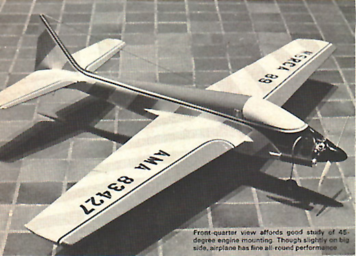

I have emerged from the dungeon, and boy, did I find out stuff!
Here's the whole, complete evolution of all the Peppermint Patties:
Niris: I have a print of the original plan w/ some notes - no date on the plans. It was published, however, in Model Aviation October 1975.
Niris II: a copy of the original plans, with notes for versions III, IV, V, and VI. Changes noted were engine mount, Aileron placement and shape, rudder cross-section, and the like. Funny thing, I don't remember building all these versions. Unfortunately, no dates are on the plans.
Major fuselage changes generated the Peppermint Pattie .60 - I have the original plans, with a note that they were modified in 11/79. Then I found the Peppermint Pattie II ! This is what Master Kit produced, but that was after it was sold from CT to the Midwest somewhere. It was dated 12/81. Notes on the plan state the nose was lengthened 1" for a 16 oz tank, the tail 2" for lateral area, bottom of fuse was made parallel to thrust line for increased side area (read smoother knife edges) Main gear changed to make retract and fixed gear placement the same, gear lengthened 1/2" for ground clearance, and lastly, the fuse doubler was extended beyond the wing TE to disperse forces. (must have been a crash breakage point?) The .60 Pattie was marketed as "the pattern ship of the '80's"
Now let's back up to the .15 Pattie: Published in March 1978 R/C Sportsman, I have early photos of my first one, which differ from the Masterkit version. I have a photo of me hand launching it at Rocky Hill. Sadly, I could not find my original plans. I think I gave them to M/K to reproduce, they might have had the same sort of notes I put on the other plans as I evolved each design.
Pattie .40: I have the original plans, dated 7/79. Sadly, I only built one of them, and didn't like the way it flew. It needed stab anhedral to prevent a pitch problem in knife edge, I remember clearly having to cut the stab and make the modification. After one season, I sold it at the WRAMS show. I remember doing it after Rhett Miller won the Nats with a .40 Contendor(?)
So that's the complete history that I can document. I will findo out what it costs to reproduce plans and keep you posted.
By the way, my current .15 Pattie is done like Ed Kasmirski's Taurus, MAN Jan '63 cover. And yes, I had one of those, too.

rainedave,
Man O Man, that Horizontal stab and vertical stab are shouting "Banshee" at me (Jim Martin design)
Yeaaaaaaah Baby ! ! ! ! ! You strap a Jett 90L on the nose of that puppy and you've got true Ballistic Speed for out of site vertifcal!
I'm guessing after reading Nic's post that the .60 Pattie had more area toward the back of the fuse based on reports of the "horizon to horizon" knife edge that Nic was famous for!
This one definitely deserves a spot, in the building line up!
Yo Nic! ! ! Ya gotta get the get those plans available!

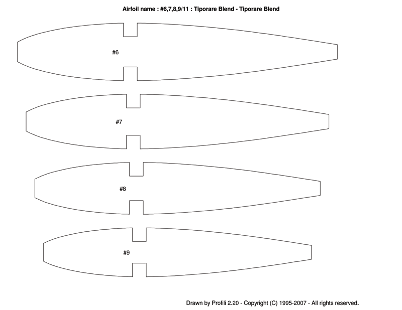

what program is that?I have profli2 and every time I try to import a scan of an airfoil I get spikes in places for some reason and then have to manually smooth it out before generating the rib set.

aerowoof, I have a three step process that I've settled on after trying several different methods.
1. I import a jpg of the template into my CAD program and carefully trace the airfoil. A point about every 5% is good with a few more around the LE.
2. A friend wrote a macro for me that exports the CAD drawing into a .dat file. The .dat file is simply a text file with a list of all the coordinates.
3. Profili2.2 will import this .dat file and generate the airfoil.
It's faster than it sounds and I've been getting very good results. With symmetrical airfoils I only trace the top and then mirror the spline to make the bottom half. Splines are not the best way to draw curves, but the macro was written to work with them.
Once the airfoils are in Profili I simply enter the LE and TE widths, size and placement of the spars and sheeting thickness. I found a free program on the web that allows you to print to .pdf files; it's called CutePDF Writer. Since Profili arranges the rib patterns to fit on 8 1/2 x 11 sheets the .pdf files are perfect for saving and printing from.
Here's an image of one of the .pdf files:

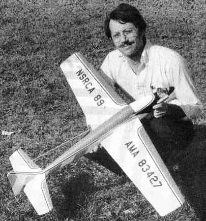

Here is a picture of Nic and his Peppermint Pattie.
From the construction article in RC Sportsman, March 1978.
(Just a short 30 years ago.)

I still have that issue. I should get a photo of me now. Maybe this w/e?

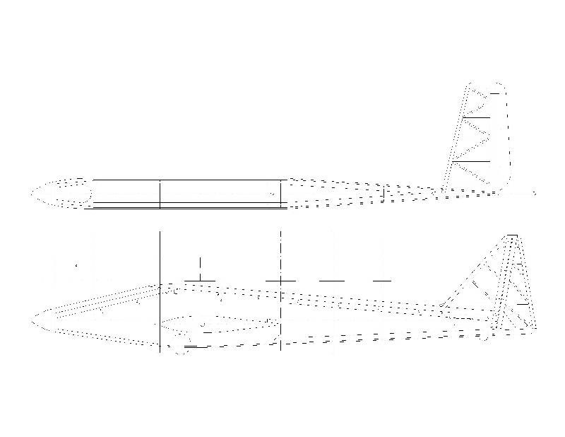

I am trying to draw the pp in cad fron a pdf file of the kit plans.While drawing the side veiw I noticed a dowel pin in the top sheeting as well as a cut line thruogh the top sheeting just before the trailing edge of the wing as if for a hatch but found no reference in the building notes about a top hatch.I know there is a bottom hatch but to those that have built this kit was there a top hatch?if not what is the purpose of that dowel pin and the cut as I could not find a corresponding top cut for the other end of a hatch.

I see no dowel pin on the top sheeting. If you are talking about the cut line above F3, that is simply a butt joint because MK did not make the top sheet one long piece, it was a rectangular piece mated to a tapered one. There is no top hatch.
As I look at the plans, MK also changed the belly hatch. On mine, H3 and H4 had a 30 degree slope down to the rear from the TE, which makes it easier to fit vs the squared off hatch in the plans.
Oh, I wish I could find my original.
