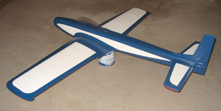

Here's a project I've been working on a little bit here and there. It's Brodak dope over silkspan tissue on the sheeted areas and Koverall over the wing bays. I used Randolph nitrate to seal the wood and attach the tissue and Koverall.
The tissue worked great. I didn't want to glass this thing and I didn't want to use a gallon of dope and primer to fill the wood. One coat of nitrate and two coats of primer and it was ready to paint with no grain showing through.
The stab is built like a DB stab and was lowered on the fuse about 1/4" or so. AUW will be 56oz or less. It's not really a Super Kaos Jr, it's a Super Kaos scaled down to the Jr's 52" span. I don't have the Jr plans so I don't know if there are any differences.
I went for the simplest color scheme I could think of. It reminds me of a Navy jet. Maybe I should put a big star and bars on one wing.

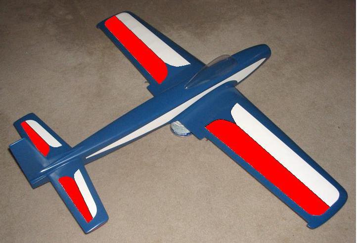

rainedave,
Hope you don't mind, that I couldn't sleep tonight and began to play with "Paint"![sm=shades_smile.gif]
When the SKJ first came out as plans, my flying buddy at the time and I shared the cost of the plans. We made templates for the wings, cut foam wings, covered them with Poster board and ended up with some pretty cheap good flying planes.
BTW-You've got the 'fit and finish' down to a science... GREAT Job..
Thanks, everyone.
I'm working out a means of painting some lettering on the wings. I'm thinking about cutting a mask from drafting paper, attaching it with adhesive spray and shooting a light coat of clear dope to seal it from bleeding. But, other than that I just wanted a really basic scheme. How did they paint the lettering back in the '60s and '70s? Masking off each letter with tape will take longer than the build did! I don't think vinyl letters will look right on top of dope.

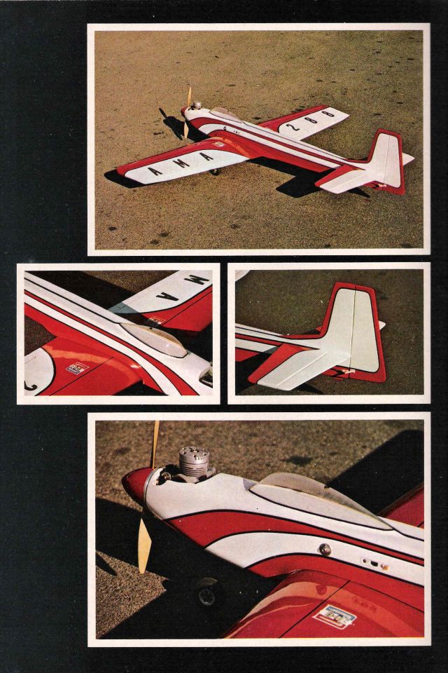

I notice that the plane from the RCM article didn't have wing fillets. Anyone have those plans? I wonder what the original ones weighed. Mine has turned out to be one of the lighted airframes I've ever built for its size at just under 3 1/2lbs.

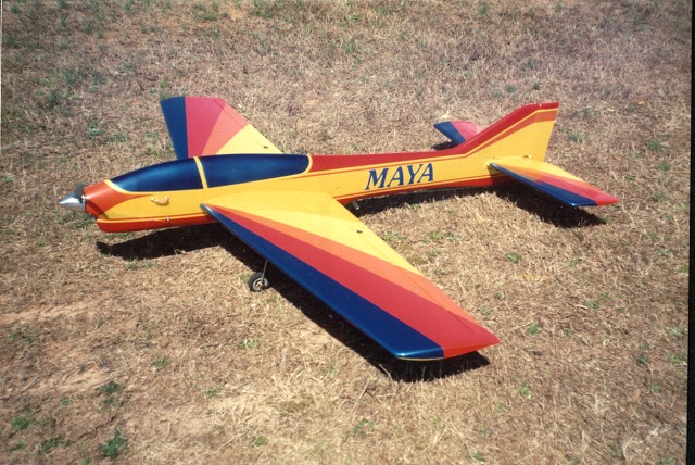

instead of vinyl letters..... the sign shop can cut shaps/text using "masking" material. This is masking adhesive, so it is removeable. Request they leave a bit of additional boarder if possible. Also request that they do not separate or remove anything after it is cut. Remove the parts you do not need on your own - this way there are no mistakes. You may want to aquire some transfer tape (or use wide masking tape)
MAYA lettering here was painted on using sign shop cut method - Ive also painted some of the racing planes this way. The fun thing is, you can get pretty creative with the mask - often enough a DXF file translates and cuts nicely.

my Maya was one of the first batch that Larry Phillips produced. Glass/foam. Built and flew very nicely... had Hanno 61 power.
The masking vinyl is different than frisket - frisket is a bit thinner, and usually is transparent so you can trace on it... and it has a bit lighter adhesive.
The masking material is more like the standard sign material - it is usually white, the big difference is the adhesive. Non-permanent. It is somewhere a bit less sticky than contact paper, but is a bit more sticky than frisket.

The original plans for the Kaos Junior states the final weight as 5 lbs.

Jim, around 5lbs is what I'd expect for a forty size plane from that era. I'm not sure what I did to reach 3.5lbs other than select light balsa. I'm also convinced that dope finishes are very light. Maybe by scaling down the sixty SK to 52" I got a lighter model, who knows? Maybe the Jr is built differently (heavier). I can't imagine the older radio gear would weigh 24oz more.
