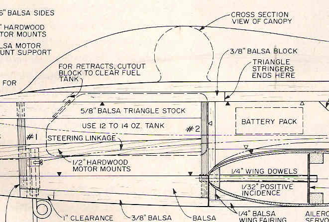

One unusual feature of both the Dirty Birddy and the UFO is the canopy cross section. It is "waisted" toward the bottom as shown below. This was claimed to increase fuselage lift when the model was flying knife edge. I don't think I have seen this used on any other designs and certainly don't understand how (if) it works.

Dick Hanson used that feature in designing his Tiporare, but, did not use it associated with the canopy, rather down the side of the fuselage. I really wish I had my Airborne Associates glass Tipo kit today. That was a beautifully executed kit and a fantastic flying design.
