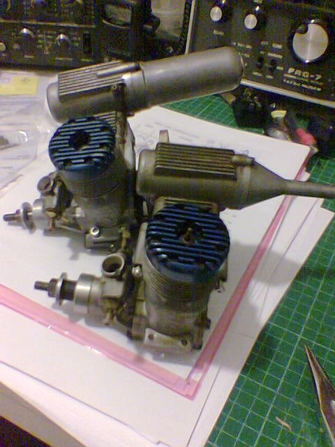

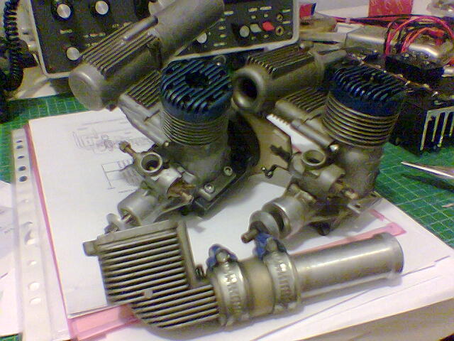

Ralph,
I've attached a couple of picture for you.
The smaller muffler is the original that I bought back in 1983 with my first G60. It's a so called venturi type and rather small. The outlet is 6mm dia. and the front venturi "inlet" is also 6mm dia. The effect here is that the muffler exhausts at both ends (a bit like me) and doesn't muffle much at all. With the front venturi inlet blocked off, the engine looses considerable power.
The bigger muffler has about double the internal voume and an outlet of about 9mm. It is the muffler originally supplied with the first true 60 size schneurle ST, the S60 with the dished head. It is a good useable muffler.
The finned header was also sold with pipe as an extra to fit the S60 and is the combination I mostly use on my G60's.
Bear in mind that the the exhaust dimensions and the hole spacing on the current S61K is still the same as the G60 meaning that any ST 60 size muffler will suit your application.

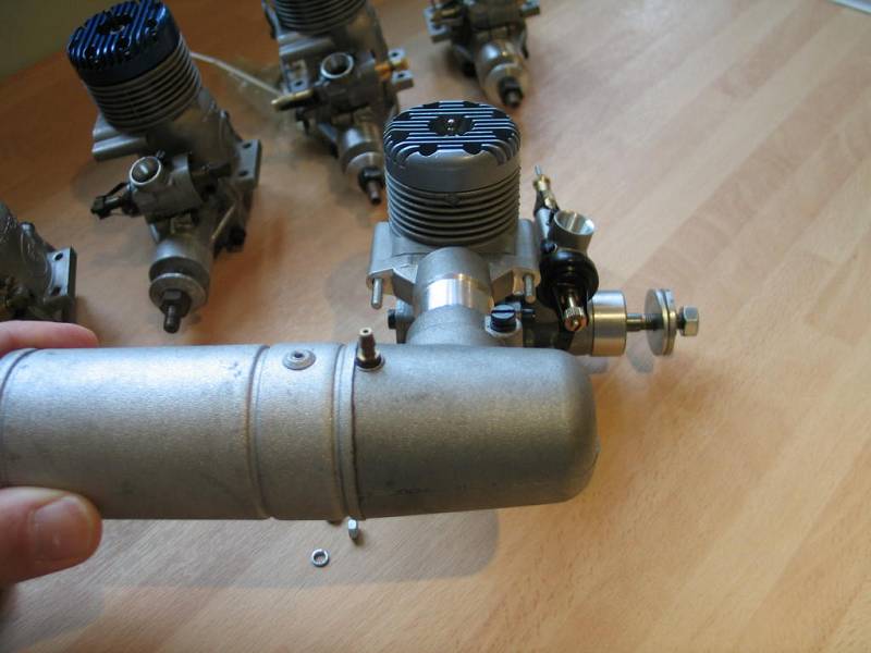

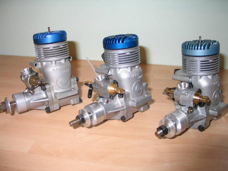

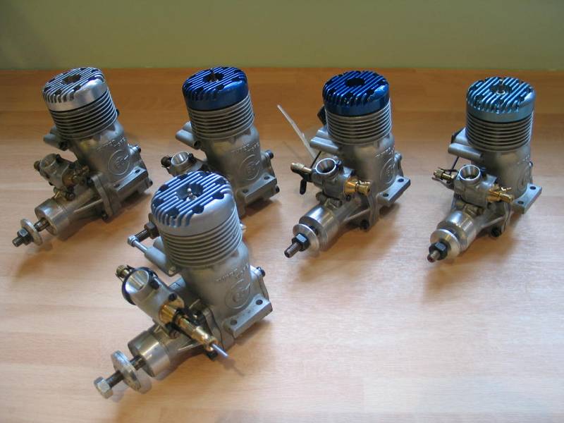

Jim,
With regards ST G60 Blue Head, I do have a small collection of these engines and they all have the 9mm choke. Smaller chokes were certainly produced but I think it was on the much earlier models that did not have the 'mag' type carb. One of the pictures I have posted shows the most recent muffler produced by ST and it will fit the G60. I must admit it is not the prettiest of mufflers but works very well provided you do not push the muffler fully home, if you do the peak RPM will drop by about 2000. For those of you who have a keen eye you will notice that one of the G60's has the 'present day carb,' the motor is a bit a a hybrid, it was made for me by the UK ST agent and enjoys PDP porting and ABC construction. This PDP/ABC engine was quite a rarity in the UK, I believe only about 10 were ever imported, how about the USA?

Windy,
A lovely collection and all of them cleaner than my two! FYI, both of mine are also PDP, abc. One was bought in Sweden and the other here in Australia.
