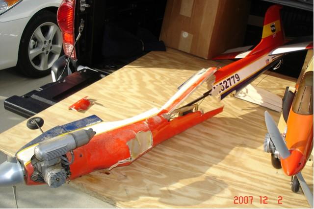

Hey Willy - I am looking at Jett for my next project. I am going to duplicate my Intruder that I stripped and re-covered. Looked at Dubb Jett's site, I am impressed.
Vince

Hey Vince - terrific restoration job, looks brand new!! Nice color scheme, too

Flywilly - Here is the start to finish. You can see my AMA number on the side of fuselage. Moved back a little on this re-build. Made a trip to the graphic's dude. Plane by pool is when if was first finished.
Vince

It may be better then new. As you know, this is a Chinese ARF. Needed quick plane for SPA contest. New it is USN cover scheme, and the covering was like contact paper, IMO. Stripped it, sealed the wood, recover. On the re-build, to take care of the dings fast, I used finishing resin and 3/4 oz. glass cloth. Few coats of resin, final wet sand, coat of dope, then mono-kote.
Right, it came out better then when first done. Lotta work. This time I will change CG where needed, add digital servos. This also gave me the opportunity to change the wing mount bolts to 1/4-20.
Does anyone reading this know if I can get a good finish with silk span/dope on balsa, then monokote on top of that. I am not a monokote fan, usually paint, but I have learned how to do it right.

Vince, I've noticed that Monokote doesn't stick too well to hard surfaces. Try brushing on some thinned balsarite over the sealed surfaces. I hate using a heat gun, but sometimes it works better on these surfaces than an iron.. sometimes. Just watch the heat.

Vintage. Thanks, you are right. Before I re-built this Intruder, I used BalsaRite dope. Look like plain ol' dope to me. Helps a lot. With MonoKote, I do fine on compound curves, it is where I have to seal down on inner dips. Name for that? Like at the bottom of a canopy I monokoted here. Down then flare out. Melting down on wingtips, etc. seems to go OK if you take your time.
Also, sealing where there is filler used, like micro-baloons. This time using finishing resin on lite glass cloth, worked good. Just at the base of canopy area, flaring down to flat is my biggest problem.
What about silkspan applied with dope, couple of clear coats, wet sanded. Monokote that OK? Maybe try UltraCote on next plane?
My QQ Somenizi Yak is UltraCoted, and great. Thanks for the info.
Vince

Monokote can produce a pretty good finish and I will keep using it, but I think I'll try Klasscote and do some more painting. I've used automotive products (lacquers and enamels <PPG&gt which work very well, but are quite expensive. Years ago I had great success with K&B as well as Hobby Poxy epoxy paints.
Vince, I didn't realize that restoration meant repair, too . You should crash more often... KIDDING

Willy - Repair/Restoration. Better second time around.
