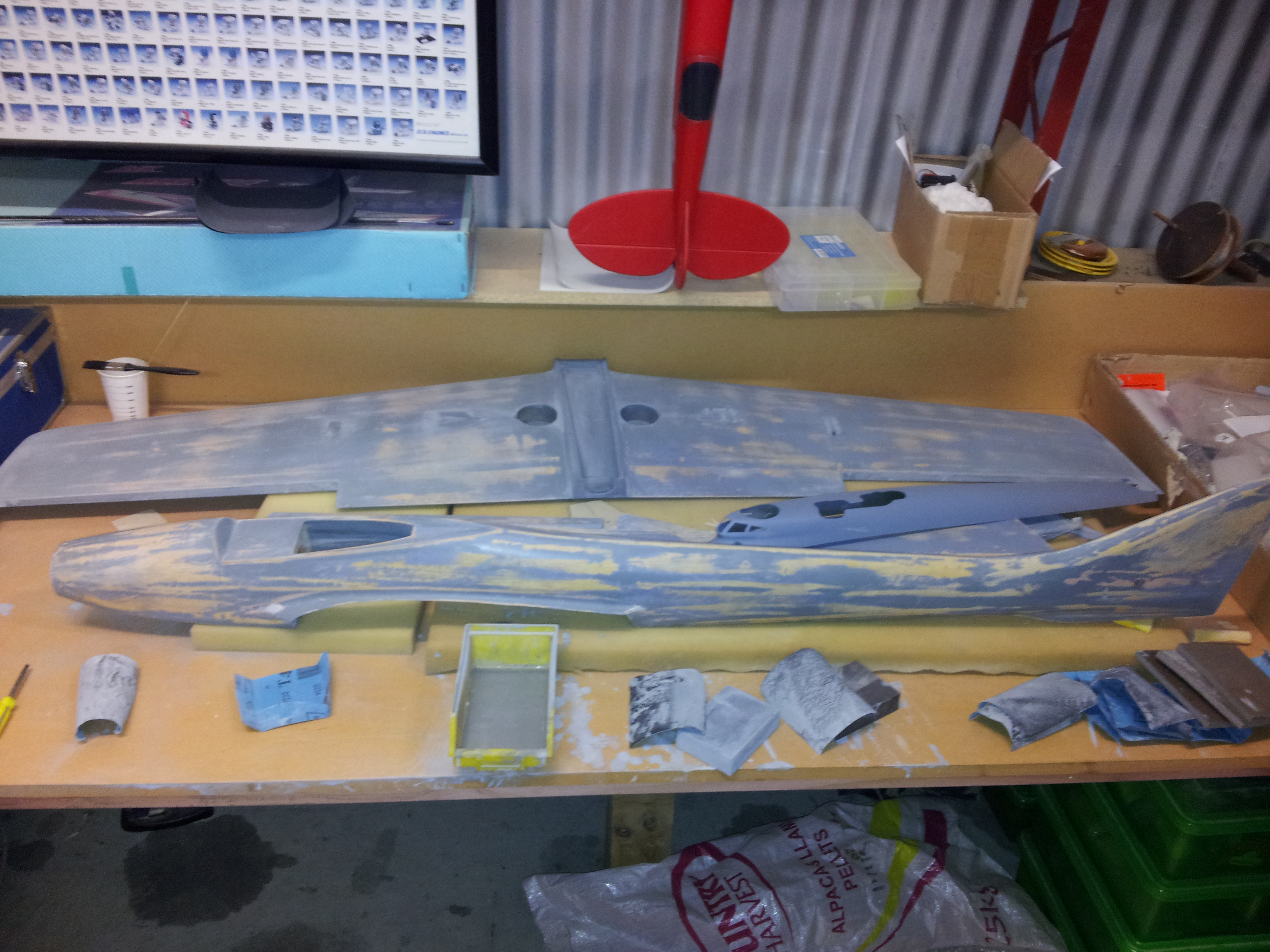

Greetings from the shaky isles.
Recently we have had a swarm of earthquakes near Wellington, our capital. Where I live we felt the effects quite well. I know exactly when last nights large shake started because I was taking a photo of the Beetle at the time. It was probably the biggest and longest lasting quake I have felt and one of the very few that has made me consider taking shelter.
We were in the half round barn type shed when the quake started. At first I held onto one of Rene's jets to stop it falling off the stand. After about 15 seconds we decided that outside might be a better place and left the models to themselves. Once outside it was completely calm but the big pine trees were swaying like it was a howling gale.
Anyway here is the pic. It has been undercoated with a very heavy coat or two of primmer filler. A fair amount of this will now be sanded off as I Sand, Fill, repeat.
Final finish will be lacquer paint followed by automotive 2k clear coat. I will be doing the color paint and a spraypainter friend will do the clear.

Hello David
Sorry for the slow response. The Beetle will be painted in a simplfied version of the box art scheme. I am going to drop the pink trianlge on the wing and replace it with red or more likely blue. I am going to drop the sky blue from the fuselage too. I will be using the yellow and red on the wings and the yellow on the fuselage. Not too sure yet about the silver on the fuselage.
I am in the early stages of sanding down the primer and finding the high and low spots.

Hello Everyone
Here is the latest picture of the Beetle. The first stage of sanding is pretty much complete. I just need to fill a few holes and sand the leading edges. Then it will get another coat of primer.

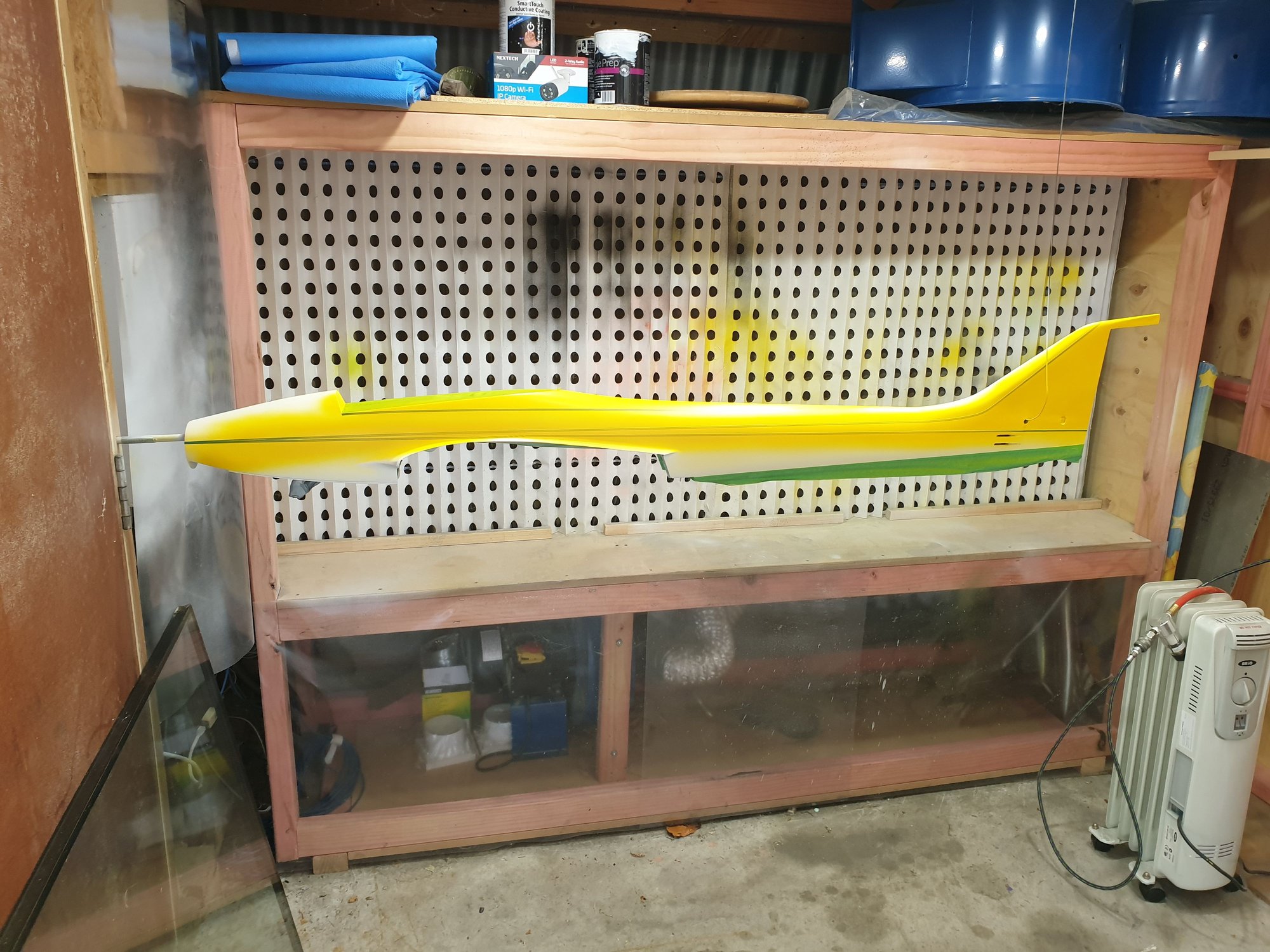

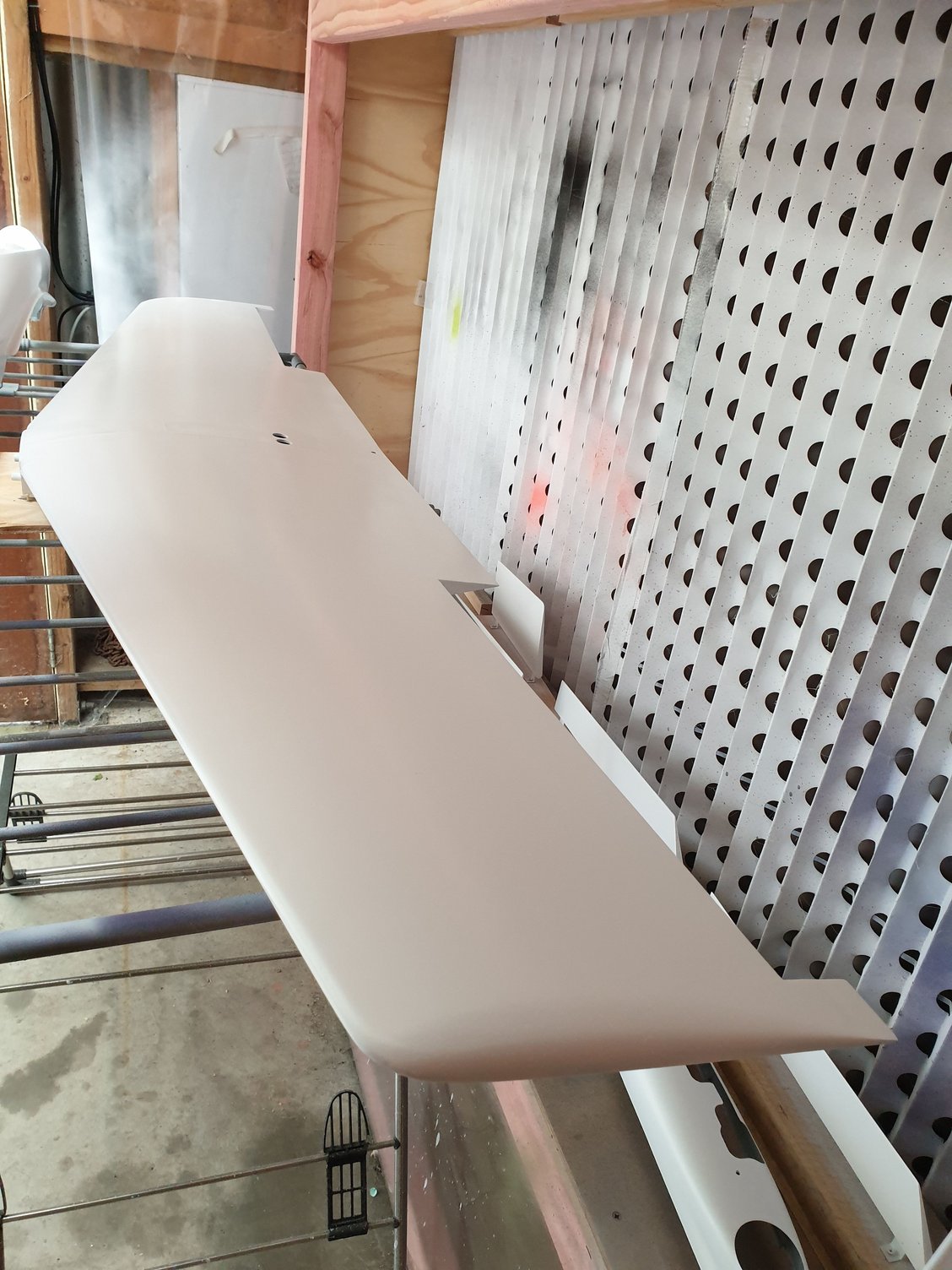

Base coat colour went on in Feb 2020. 2 pack clear coat went on and everything was "mint". Unfortunately the paint booth door was opened later with some really gusty wind and the wing fell off its hanger and kissed the fuselage on the way down to hitting the conrete floor. Damage was minor but enthusiasm went to nil.

Filling the dents and re-painting and clear coating the paint damage was in April 2021.

Install pictures
Old 01-13-2022 | 02:09 PM
  #215
Joined: Nov 2007
Posts: 158
From: Tokomaru, NEW ZEALAND
... and this is what it looks like now.
Engine has been run. I still need to finalise the CG and I am going to install a magnet operated electronic switch so I dont have to spoil the lines with a dirty switch or bit of wire hanging out the side.
