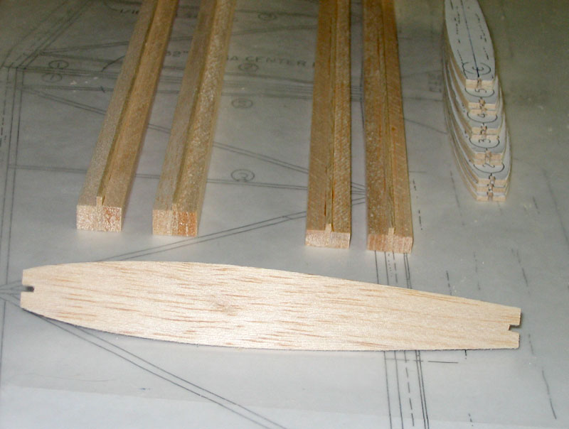

The slots in the ribs are for using a wing jig. If no jig, you can ignore the slots. What I did was to run a balsa strip through the slots and then put blocks under the strip to jig the assembly to level. It worked well for me but it sounds like you've already got your jig set up.

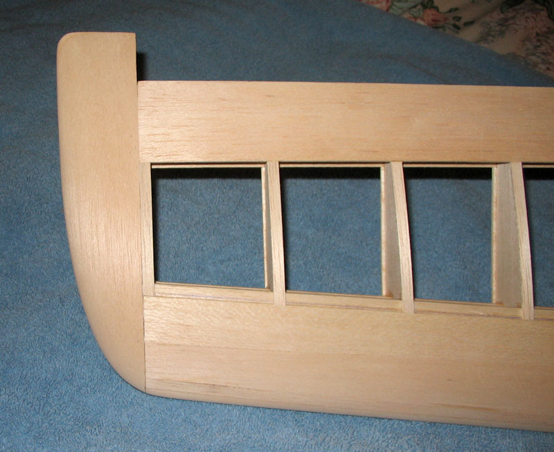

The original wing and stabilizer design featured a slotted leading and trailing edge. A piece of 1/16 strip was inserted into the slot in the leading edge, then each rib was slipped onto the strip until it butted up against the leading edge. The whole thing could be assembled and straightened on the plan before a drop of glue was applied. Not sure why the leading and trailing edges are no longer slotted. It was very effective.

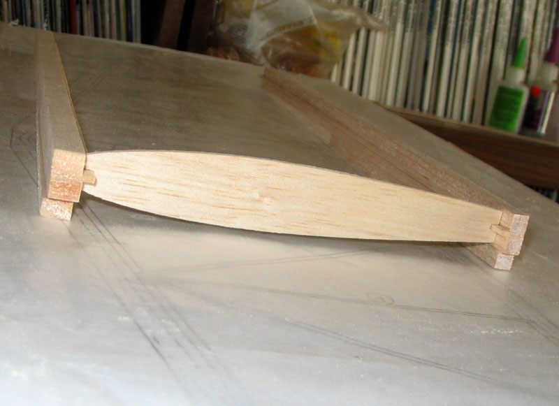

ok, after staring at the plans for a few hours, reading directions over and over again I finally realized that this isnt a fully sheeted wing. Once I figured out the function of the rib caps I realized how it was supposed to be. So I am not short on sheeting, it was just some confusion by me. I started to use some sheeting I had in stock but I just didnt feel like it was correct so I just studied it harder until it clicked.
What is the best method of doing the other wing panel. I built the first on top of the plans. Just looking for the most accurate way to do it. Plus I dont want to end up with 2 left wings.
Here's a photo of the cap strips. Build the second wing over the same drawing on the plans; the wing is symmetrical. Just remember to install the gear blocks on the opposite side, i.e., upside-down. The old method is to rub the plans with cooking oil and simply turn them over (the oil makes the paper translucent and the ink shows through). This ruins the plans, though.[
] Better yet, I can email you a reverse image of the wing half that you can print out if you want.
David
