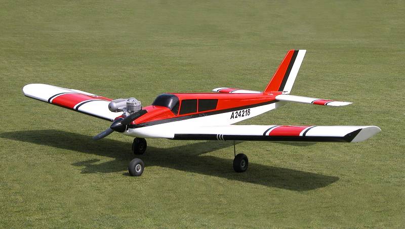

Cherokee lovers:
I have built two Cherokee kits, one way back when I was a teen ager, the other in the 80s. I still have the plane, but it is "in the shop", (for a long time...I'm in to SPA now). Unfortunately I took off one day without ailerons...long story.
I just wanted the chance to include a picture of my Cherokee in this thread. The Cherokee is a very pretty plane, and nicely proportioned.
Duane
Duane
