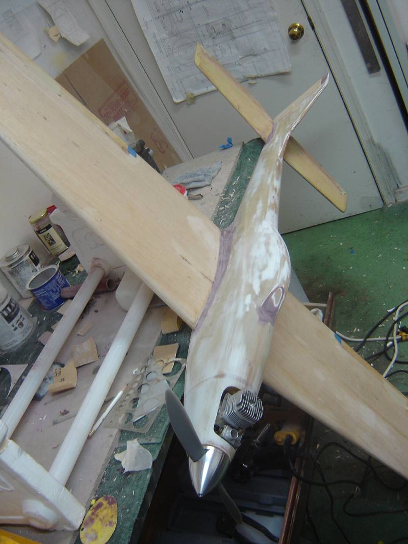

nice finished product. I have my second Tiger Tail IV baack on the bench and ready to finish a build thread I started a ways back. Again congrats on your "new" Tiger Tail III

Just checking out your Tiger tail III again,more questions who made the kit is it plans built,glass and foam like my Cajun R/C (long D/C) TTIV..

It's an old Southern R/C kit w/ fiberglass fuse, foam wing and stab. The fuselages weren't the greatest. Blue polyester fiberglass. The TT III was designed for a rear exhaust .61 sitting upright. The kit included a fiberglass floor to go between the internal pipe and radio/tank compartments, but that was left off on mine. The wing and stab were sheeted w/ 1/16 in balsa and covered w/ Monokote. the fuse is painted with NAPA automotive paint. These kits were made in the late 1970's and early '80's. Their other pattern kit was Steve Helms' "Bootlegger" design. I didn't build this particular plane, so I can't tell you much more than that. It was built for a good friend who quit flying pattern after only flying it a few times. Sadly, he passed away about 2 years ago, and ultimately I acquired the plane. It was built as a taildragger to try to lighten it for the "new" turnaround pattern. I built a Bootlegger kit when they were new, for a Model Airplane News "Field and Bench" review with OPS .60. Flew great until you had to land, as it weighed about 10 lbs.! This Tiger Tail weighs about 8 1/2.

Thanks and right now I'm considering wether or NOT to monokote the wing weight is an issue.
