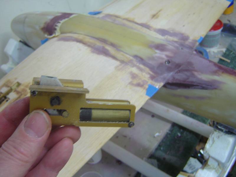

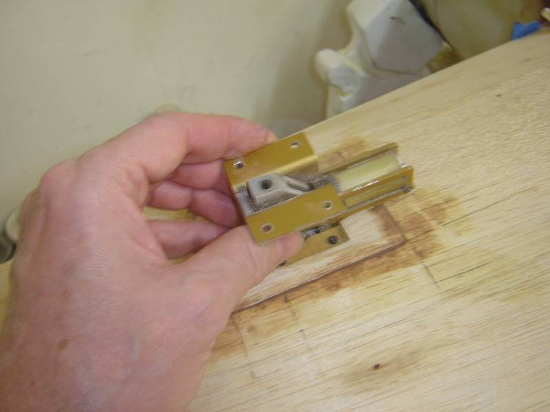

Thought I'd mention Robart who offers Spring type gear nearly identical to Spring Airs 100 series. Interesting this subject came up as I'm finishing a project that needs 85 degree 3/16" strut such as the "well used and never leak" Springair HD#116 pictured below.
ID:	887693   Click image for larger version
