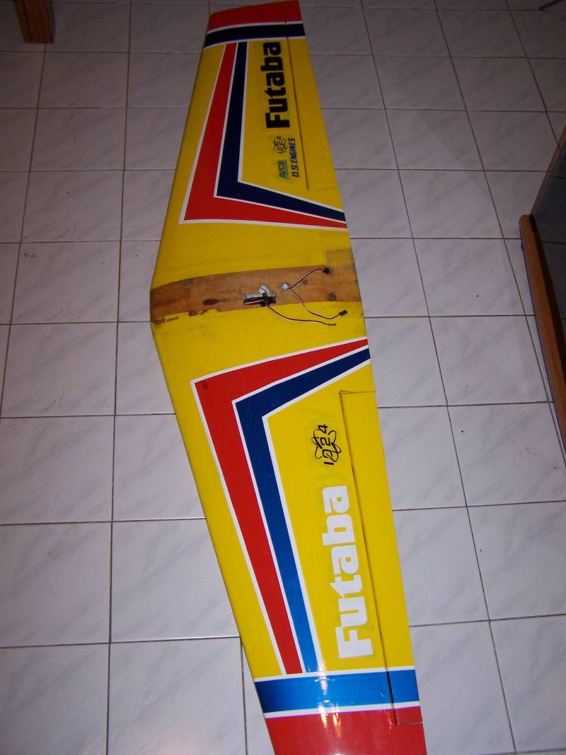

LA-1 OS 61 MK retracts futaba 5101 servos

[&o][&o][&o] LOL! Foot in mouth again! Nice looking LA1 Vinny!

What a Great Lookin' Airplane vinnyjet!!!
Enjoy Her... [8D]
