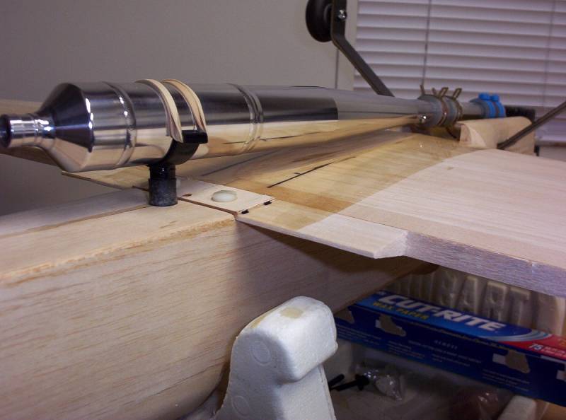

Good info so far so here is another little bit...I soft mount my engines...I've elected to use an "Articulated Header" (Not my term..Stole it..he he)...It's kinda nice in that it allows for a little mis-alignment, adds an intermediate piece of aluminum for tuning and reduces a little stress on the header (in my opinion)...I use a soft mount for the pipe also available from Dave Brown Products (I messed up the factory o-ring so the rubber band as a temporary substitute)
I realize mine is a rear exhaust set-up but I plan to do this to all my stuff...
Just a bit more food for thought...

First, Chuck, the rubber bands don't melt?
In both cases, you guys are only using one mount at the end of the pipe? "Seems" like that would be a little flimsy.
You have to disconnect the pipe everytime you fly/remove the wing?
Thanks!

The rubber bands are only on there cause I broke the factory "strap"...I have to order a replacement...I have run with the rubber band on my test stand with success...I doubt I'd ever fly that way though...
I've not noticed any flimsyness (sp?)...lol
Yup...On most of the designs I'm interested in...You'll have to remove the pipe to get the wing off...I wouldn't say "every single airplane" is that way...Allot are though....
I agree...Zip Ties are the way to go...
Have Fun...
