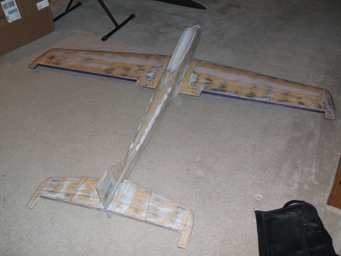

This is my 2+2 Dirty Birdy that I had started a while back as my re-enrty into the hobby. The problem is, I had built in a slight twist into the fuselage during construction. I thought you might want to see it before I throw it in the dumpster here shortly.
I used several 1/4" ply plates in the wings and nose to mount the retracts. I think Bridi was intending the builder to imagine his own installation based on their own experience.

Maybe it is my poor vision, but I don't see a noticable twist. There might be something there that could be measured, but I've seen some very crooked models (visually crooked)competing (some were mine) and the pilots appeared to be having a great time flying them. I'd hold on to it. Just Monokote it (plastic film) and forego the elaborate paint job if the crookedness bothers you that much. At least it will be flying.

I have to agree with Ed, I cannot see a twist either. It appears you have spent alot of time and hard work on getting the plane to the point it is. I'd hate to see you throw it away too. Go ahead and finish the plane and fly the pants off it, besides a couple of trim clicks in your transmitter should overcome the slight twist in the fuselage with no problem.

You can actually saw a wooden fuselage into three pieces right behind the TE of the wing and right in front of the stab. Re-align the three parts in a jig and use internal 1/16" plywood scabs and fg cloth to re-join the parts. Of course, you would need to cut away the bottom sheeting to do this. But, it could be done in two hours or less. Considering the amount of work already in the plane, that's what I would do.
