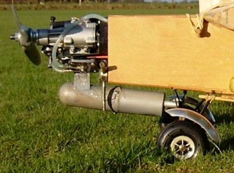

Turboomni.
In the past I did remark that the old system is mixture adjustment, when looking the way it works.
Mostly a reason for me was that using control it isn’t really the right description.
Now you show me why, because your system is really a mixture control, no adjustment.
I think about the system it is good In a heli, in normal level flight and a nearly constant position of tank versus engine and power range.
When the level of the fuel in the tank lowers the temp will rise and richen the mixture.
I think this system is designed this way because you really cannot measure the mixture in the crankcase only the effect of e lean mixture and that can be the temperature. (oxygen in the exhaust?, WEDJ do you have a sensor for that?)
In a plane I think it is better to control the pressure of the fuel near the inlet of the carb.
Look at my 61 FX, with pressure control on engine and tank.
The position of the plane and g-forces do not disturb the carb anymore, he “thinks” the tank with right and constant fuel level, is right along side him. You automatic have a constant mixture.
Temperatures I also measures and I know the temperature rises very fast when the mixture is too lean.
In the FX the result can be destroyed main ballbearing because of the wrong position of the ballbearing in the crankcase, too far afterwards after overheating and cooling down after that
About the rich midrange David, can that have to do with the normally uncontrolled (and too high?) tank pressure that is used mostly or a too high Perry pump pressure? Because I do not have problems with that, also not with my MVVS 10 cc 0.60 and MVVS 7,5 0.45.
With pressure control the inlet pressure of the fuel to the carb, after the regulator is very low, so the carb has to “suck” the fuel out of the regulator in a situation you can compare with “no tank pressure”.
So when you have a problem with a rich midrange, what happens when adjust the carb with NO tankpressure and NO pump ? Of course not to fly with it, only to see the result of adjusting on the midrange.
When it is oké than maybe a Cline regulator you can use.
Cees

#34
David from “Aircraft and Instrument Panel Illustrations”.
I did make an illustration for you from a (spare) part of my aircraft. LOL
I did take a look in the physical date of methanol.
Methanol boils at 65 graden Celcius, 149 Fahrenheit.
65 degrees Celcius, 149 Fahrenheit, isn’t high!!
The OS Max engine backplate is normally integrated with the needle valve, see picture.
I think they later did make the unit separate so the heat conduction to the needle valve is less.
I do measure the engine head temperature near the plug normally above 150 degrees C (302 F). Overheating above 200 degrees C (392 F).
It isn't strange that in some situations , fuel, plug type, crankcase ventilation, propsize, leaning mixture, environmental circumstances (TEMP!) etc, the temp of the needle valve rises above the evaporation temp of 65 C / 149 F !!!!
(That overheating is the problem after the engine stops. this heat in the material of the head of the engine, which is a lot of material, transfers of the other parts of the crankcase.}
When using a normal OLD! carburetor, from the "pioneer days", the needle valve automatic is situated in the coldest part of the engine by the evaporation of the fuel!, also in the summer, but, yes, we with our little engines want everything the big boys have so also “vapor lock”.
Cees

#35
Thanks for that.
I'm using a different remote needle assembly than the stock 91fx NV.
Unfortunately, there is no transfer of heat from the engine to this NV that could be causing the bubbles in the fuel line.
The bubbles are originating from the cline. Fuel in is perfect, fuel out... bubbles.
Hummm.
Thanks anyway.

David,
Than there is something wrong with that Cline, you are right.
There is a membrane inside, maybe there is a pinhole or leakage in that membrane.'
When you can find the thirt opening, so not fuel in- of outlet than maybe you can check.
Put a very little pressure, by blowing, in the outlet (to carburator) with a piece or fuel line and with the Cline under water. Closed inlet.
When you see air bubbles from the third (sensor?) opening, there is a hole in the membrane. When bubbles somewere from the casing maybe a crack in that.
I do not know the inside of the Cline, but I think it is something I show on the picture. I use also a reference to pick up the pressure near the carb.
Succes Cees
