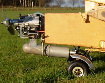

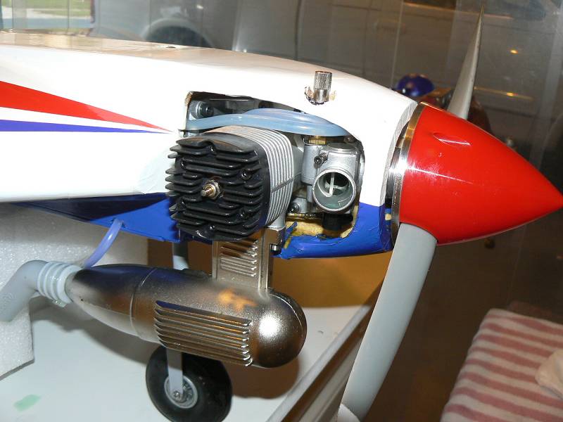

Two pictures off two of them, left by there owners and never one dead stick with me.
7,5 ccm MVVS on my video Jonni and the second a MVVS 10 ccm on the Taurus.

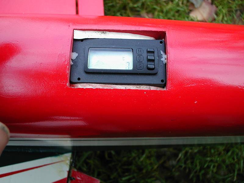

Third picture the datalogger on the Taurus to measure the motortemp during the flights.
