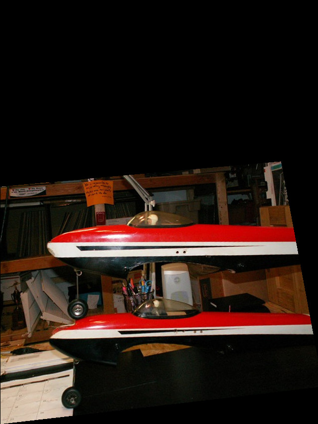

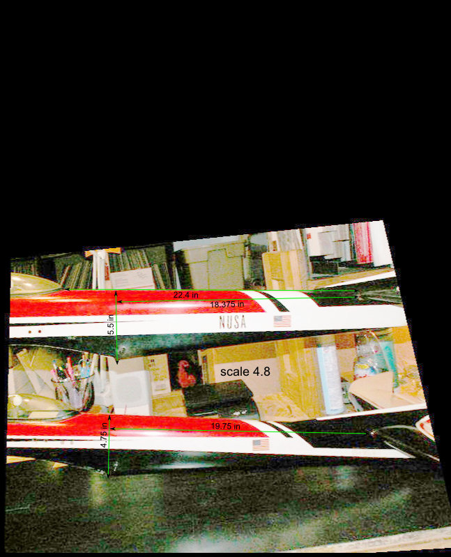

That would be good, but most important seem the wing saddle length, from there to fuse tip (i.e. check your former measurement), and the wing chord length. There is some incertainty/inaccuracy in these big dimensions so your check could calibrate the picture measurements.
Don't expect too much error in the smaller dimensions, especially the vertical ones. The picture is un-distorted to (at least nearly) true dimensions, compare original and undistorted pictures. Of course, checking won't hurt.
The MAN cover picture is dimensioned here for comparison with the other dimensioned pictures and plans. Incertainties/inaccuracies neglected (e.g. due to fuse dimensions slightly tilted and not quite parallel), several dimensions are measured with the wing saddle / root chord length as benchmark.
If it is assumed to be 12", the other dimensions match those in the picture in post #1142. So this could be an indication that the distance from wing saddle to fuse tip is really 28". On the other hand, assuming the wing saddle to be 11.5" makes this distance 27" which was measured on the real model. Another reason to check.
The pictures in #1120, #1128, and #1142 are amended.

UStik, I think you might find that the wing chord at the centreline is about 11.5", but the cutout length will be somewhat greater, pretty close to 12" due to the slope front and rear to allow the wing to slide in the event of an 'incident'. Yes, Ed did like NRN!
Evan.

Yes, I know what you mean. But the rear is not sloped and you don't see the front slope when looking on the wing from top. Besides, the aileron bellcrank tube is painted white and belongs to the visible chord. That's on the rear, and on the front you look a bit inclined over the nose radius, making the chord seem a bit longer. That's why I think what I see as saddle/root chord in the picture is rather 12" than 11.5".
And additionally there are so many influences on accuracy, anyway. The dimensions are not exactly parallel to the picture plane, the pictures are rather small, distortion is not completely known, the graphics program doesn't accept two digits behind the decimal point, ... It would be quite expensive and costly to get better accuracy from these measurements, if it is possible at all. So I just juxtaposed (nice word, foreign word in German) two alternatives and keep hoping that all will be cleared up by real measurements.
