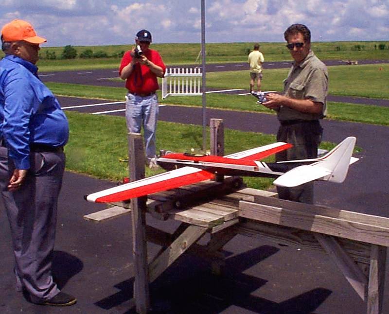

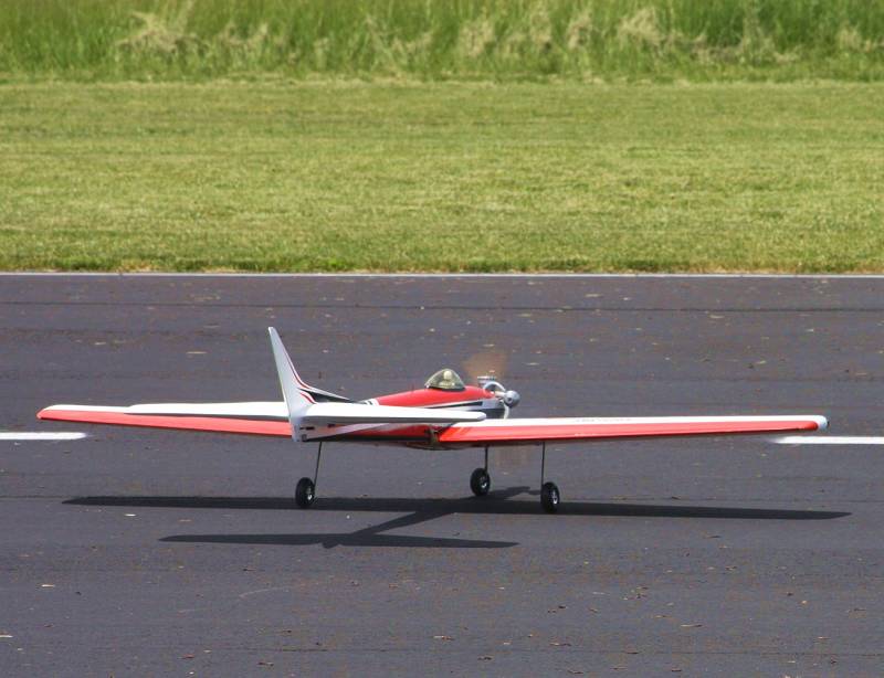

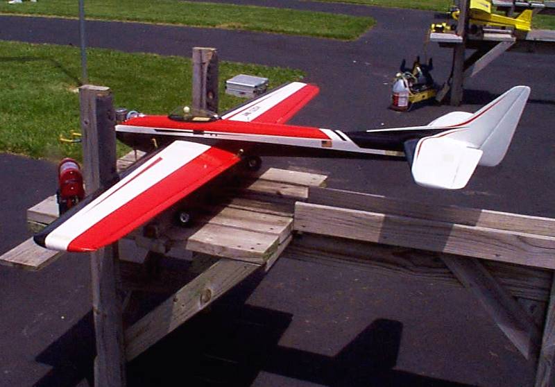

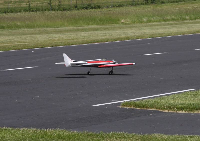

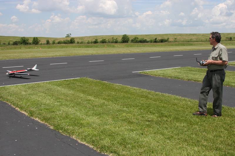

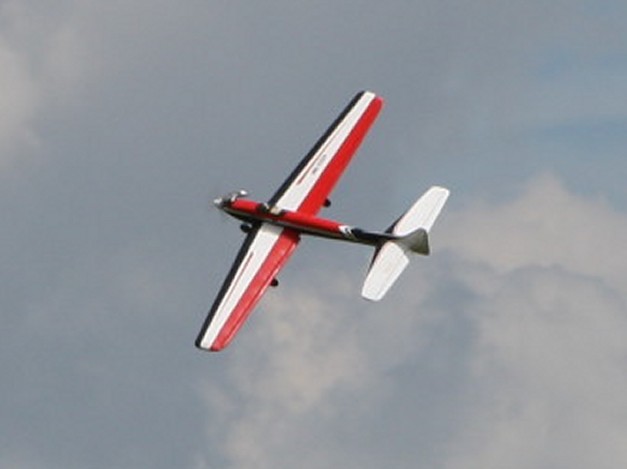

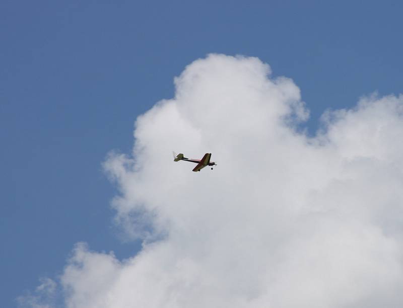

Here are a few still pictures taken in Lexington as the Taurus-2 stretched its wings once more. As with all "new" planes, it needs to be fully trimmed out.
The decision hasn't yet been made whether or not to stay with the vintage Super Tigre .56, or convert over to another engine, (such as an OS .50-.60), that was specifically designed to fly with a muffler. Right now the ST is not running/idling reliably...it has a little over an hour's worth of fuel that has been run through it, and should run better in the future. The carb on that engine is "weird", and not the best in the world. I have 3 ST .56 engines, and the carb on each seems to be a little different, almost like they were trying to find the right configuration to use. We may swith-out carbs to see which works best.. It seems common to drill out the stanbdard size hole to allow more air.
We will also do some experiments with modifying the add-on Tatone muffler by drilling it out some to allow more flow through. I was just told yesterday that the Tatone model I have is an "engine killer" in that the expansion chamber is supposedly not large enough and the engine has to work harder, thus they tend to run HOTTER. I also have a different brand of add-on muffler that is much more flow-through to test as well.
While not wanting to "overfly" the Taurus, I am looking forward to fine-trimming the plane and getting the engine peaked to be able to see just what theTuarus-2can do. Flights are relatively short on the six ounce tank that Ed called for, (maybe 8 minutes), so each flight will have to have a definite purpose in mind.

A few more pictures of the first flight:

Thanks for the photos Kingaltair, really pretty model in the air, as if I didn't have enough to do... I have a compatriot who is also really interested in a Simla, so maybe plan/kits will have to ship to NZ... Tell Cees the Myers plan shows 41/2" dihedral under one tip at rib 12. Which leads me to the fact that I have a full PCM Taurus kitted and I'm starting to build. If I complete that, then a new 1" longer fuselage for my TF Taurus and clip the wing tips 1" on that model, then I can take a crate pic too... As for UStiks Reflex Simla, well I'm jealous too, that is one pretty airplane, whatever span you choose. Wonder what you guys would say if I mentioned retracts for Simla? Just think it would look so smooth with the wheels up...

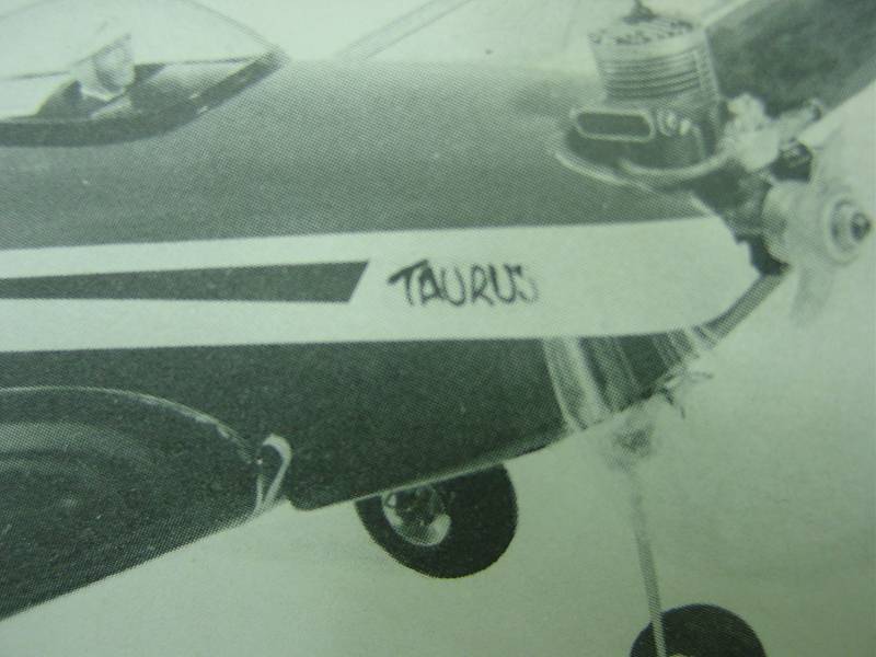

Hi Cees, Hope these close-up pictures help you. Col. Chuck Winter

Chuck that will do, perfect,
I show you the result in the near future,
Thanks Cees
Free Bird, hope you read this message,
You see I have my name for the plane, so thank you for the offer, but this one is the most original for me.

Free Bird,
Thanks,anyway, but what I did write you, I will use the pictureChuck shows me.
For me it is proved Ed did fly (one of) the first "preproduction" Tauruses from Top Flite, sosome details are "scratch"" made and so also the name probably with characters glued on.
Pictures of this Taurus we seefor promotion activities in articles (MAN) and magazines and as I see nowalso on the plans of the kit, that was the reason I did ask Chuck in the first place.
When we take a close look at the picture of Chuck we can see the name Taurus on the nose isn't your decal, as I expacted.
This is for me the first time I can see the details to copy the name.
Cees.

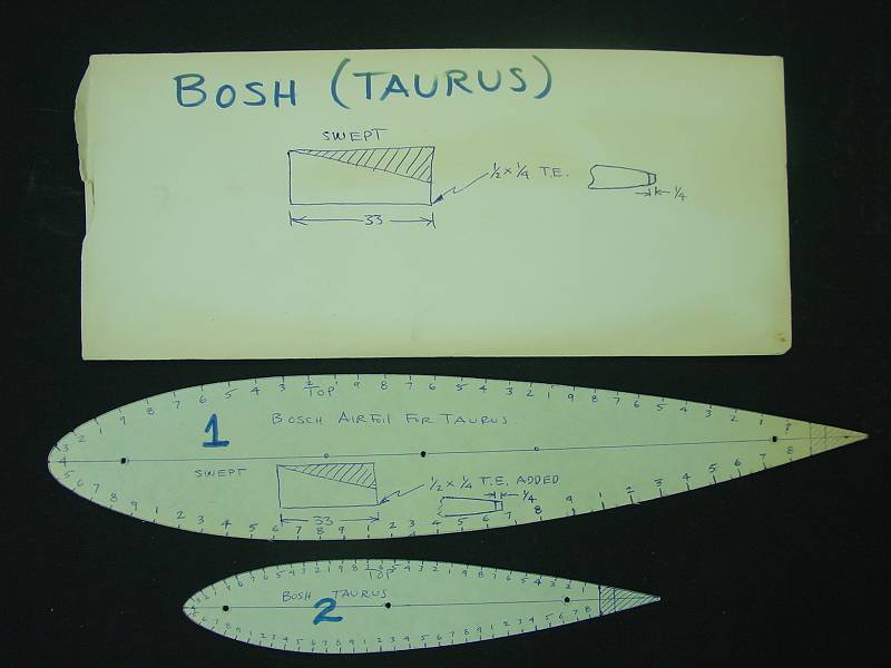

Hi Taurus Guys, I keep digging into myarchivesand have come up with many of thetempletsI made when I was cutting foam cores. I cut cores for all the major pattern airplanes. I was one of the pioneers of foam cutting. The most popular wing cores were Taurus. I cut so many Taurus cores I had to make templets out ofaluminum. More pictures to come. Col. Chuck Winter

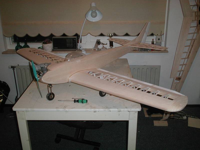

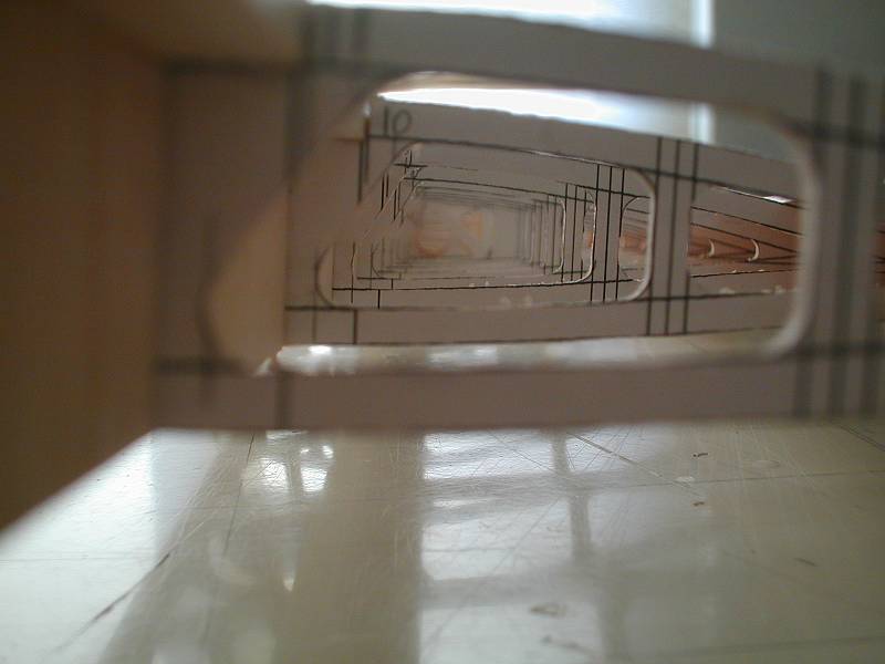

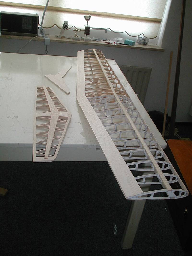

Hello Chuck,
I see you have all your building activities very well organized!
One question, did you foamcutting alone or with two persons, one on the root side and one on the tip side?
I have the possibility of vacuum bagging to glue doublers but never did make a foam wing.
Alsways "handmade" ribs with the fred? saw (dutch : figuurzaag).
I use a computer to calculate and print all the ribs.
My program can calculate ribs with different airfoils on root and tip,
First picture also visible a own design Horten glider (Flying wing) which is calculated with 4 different airfoils in one wing.
(bell shaped Horten lift distribution),
Off topic but interesting for you:
http://www.youtube.com/watch?v=GjXr5w3M4mc
Some pictures,
Cees
